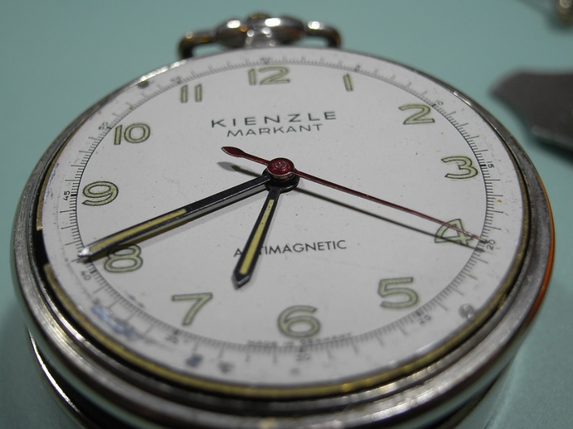

One of my Mum's friends dropped off a pocket watch for me to service. It was her father's watch, and she used it all through her nursing career: so it held quite some sentimental value to her. She told my Mum that it did run; but only for a few minutes and then stopped, unless the crown was moved.
It's a German made Kienzie Markant.
I popped the back off and the movement and saw that it was VERY dry, but in good condition.
First thing I notice was the stamping .... Zero (0) Jewels - Unadjusted. So this thing is no RR Standard Hamilton; but none the less a nice little project, and one that will make my Mum's friend happy :)

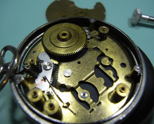

So I removed the tension from the Mainspring, and removed the Balance and Fork.
I was a little nervous removing the Bridge, as it's a 3/4 Bridge and I couldn't see the layout of this movement, and since this is a very new style of movement to me I wanted to take reference photos. Well my nervousness was justified, and EVERYTHING lifted out with the Bridge!! ACk!! :startle:
Again, something new to me was the layout of the Keyless Work. It's a rather clever rocking pinion system. Rock one way and the Mainspring is wound, rock the other and you engage the Motion Work.
Thankfully the Click Screw was marked as a left-hand thread ... Note the extra stripes either side of the Driver Slot.
Movement is fully stripped and ready for a bath :)
Here's that nasty 3/4 Bridge that stopped me taking reference photos of the Gear Train Layout.

As a side issue how did you let down the tension off the mainspring. I have looked at the pics & nothing obvious to me.
clockboy, on 21 Feb 2015 - 06:59 AM, said:
Great service again Lawson.
I've circled the click release slots for you mate.  Sorry I didn't illustrate that in the walkthrough mate.
