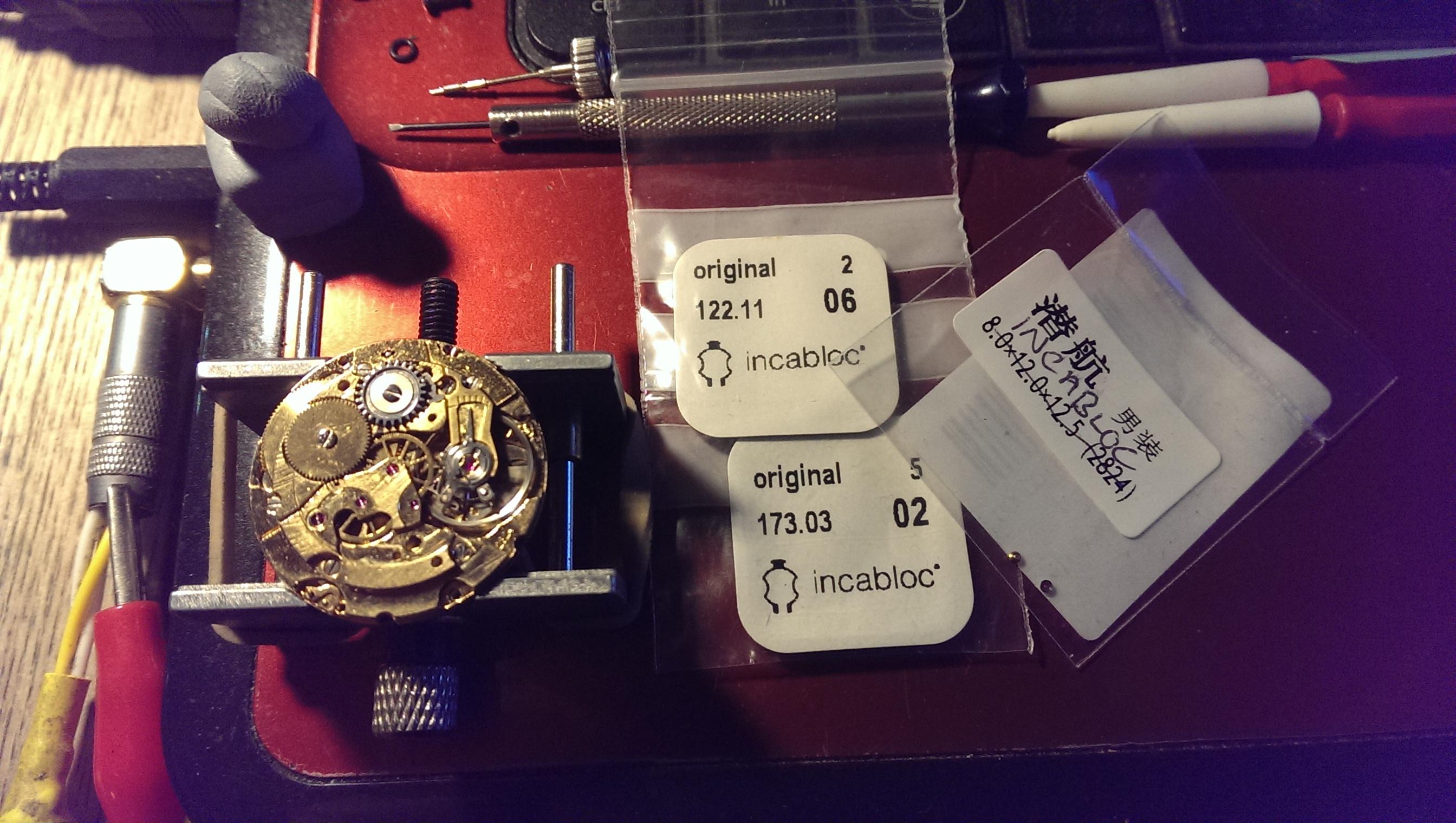

This is a nightmare. It's much less grief to purchase a complete incabloc and refit it.
Just FYI, you're replying to a two years old topic.
Also, we have a dedicated section where it's considered polite for new members to introduce themselves.
I have no idea how to do that as I'm devoid of social and forum navigation skills.
Having successfully replaced many springs on the  DG2813 (you just need to look at them and they ping out)!
ETA and AS movements are a dream to work on,  but when that spring breaks!
This 2836 just got a new Incabloc.
