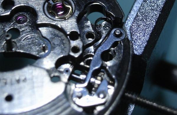

Remove the Setting Lever Spring.

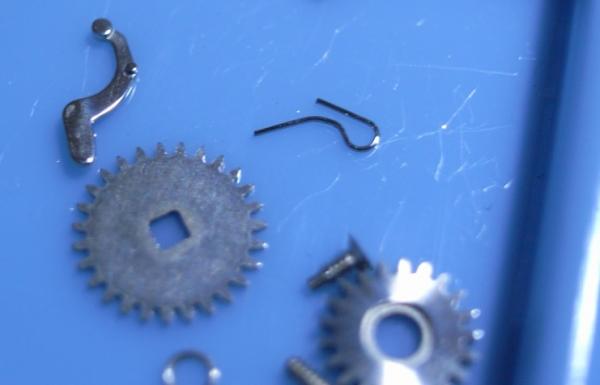

Remove the Yoke Spring and then the Yoke.
Then remove the flip the movement over and unscrew the Setting Lever Screw.
Pull the Stem out and the Clutch Wheel and Winding Pinion will fall out.
Here is a reference photo of the Yoke Spring.

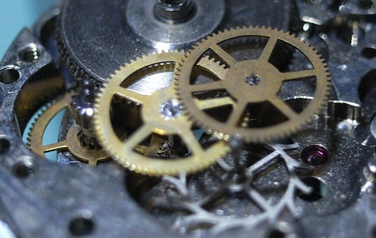

Firstly replace the Intermediate Wheel, and locate the lower pivot.
Then replace the Barrel and locate the lower pivots for the Third Wheel, Second Wheel, Escape Wheel.
Place the Train Bridge back on, and locate the top pivots as best you can with the limited room you have, and replace the screws for the Train Bridge and just LIGHTLY screw them down.
DO NOT APPLY ANY TORQUE TO THE SCREWS!!
Then with a piece of Rodico, grab the Barrel and remove it as pictured below.
You now can loosen the Train Bridge Screws and gently move the pivots into their jewels completely.  This also allows you to free spin the gears  including the Intermediate Wheel.  Then tighten down the Bridge.

Stripping was pretty straight forward, but while rebuilding it, I encountered some pit-falls. I was struggling with getting the train-bridge back on. Especially the escape-wheel and the second-wheel had a mind of their own in which jewel to go. I ended up taking the train-bridge screws out and worked my way from the center to the rim. Once all the wheels were in place, I installed the screws.
The other problem I had, but that may be due to my total lack of experience, that following the assembling instructions, when assembling the setting lever I found out that setting-lever-screw had to be inserted before installing the barrel-bridge. Not a big problem, I just had to disassemble until the setting-lever-screw could be inserted.
I also went wrong refitting the keyless work. After installation of the setting lever, yoke, yoke-spring and setting-lever, I was left with the winding pinion, clutch wheel and winding stem. They had to go in before the keyless work, so I had to disassemble the levers & springs for another training round :-)
Getting the setting lever "locked" in the winding stem, tightening the setting-lever-screw on the other side, was a hard task and took me ages. I had to take a few walks with our dog ;-) Wondering if that can be done easier?
