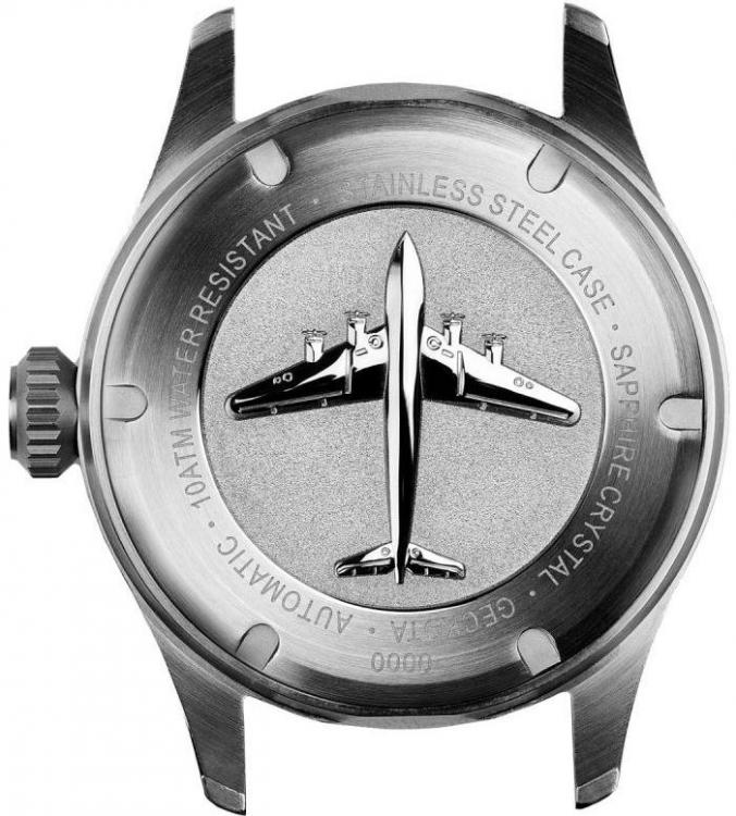

My latest: It's a Geckota K-01 Pilot featuring a fully polished 44mm case, screw down crown and embossed back cover. The movement is a Seiko NH35 with hacking and stem winding but no date. The sterile dial with large numerals and seconds can be read easily. Amazing lume!
The back shot is from the mfg's web site as I didn't want to disconnect the bracelet for a proper pic. Oddly enough, I've had my eye on this one for quite some time. The mfg'r just put these on sale last week. I was browsing another watch forum when this one was posted for sale at half the current discounted new price. The seller felt it was too large for his wrist so I snapped it up. As only 100 of each of this model in brown or blue dials were made, it isn't going to be common. The watch is also offered with ETA movements with other options. Additionally, the packaging was over the top. The box is wood, highly finished and leather lined. Oy!
