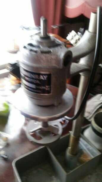

I've tried to lever off to no avail. In a post last year 'hammer' mentioned something about a thread on the shaft of his Brenray machine motor. I've tried holding other end of motor shaft in vice and twisting basket holder but with no success - I'm afraid to put too much pressure on the holder in case it distorts. The inside of holder is threaded - I have inserted screw to show this.
  On 2/1/2018 at 10:57 PM, khunter said:
Looks like it could possibly be pinned in place, as in a roll pin.
Expand
No sign of a roll pin.  One grub screw in basket holder and 2 grub screws in cylindrical section above. All grub screws removed.
Expand
Apologies, I need to read better. Sounds like it's just seized, might try a little heat to get them to come apart.

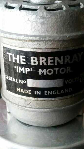

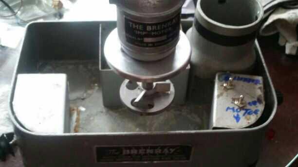

Hi can eney one help please .I have purchase a brenray watch caning machine it all seems to work ok but we would like to make sure that the motor is wired correctly . It states that it is 110 -220 volts . Can this run ok on or UK 240 volt or do we need to get it rewired to be able to use it I would be great full for eney advice
Expand
240V is actually the limit, typical values are around 230. All equipment labelled 220 accounts for that.
BTW, you had posted in the wrong section, also we have an introduction section where most members like to introduce themselves before asking questions.
Hi thankyou both for ur messies . I did not now hoe to go about talking to people on hear so I just added my message would eney one be able to addvice on how I would rewire the motel at all as I'm not sure it is wired correctly . The machine on ur link is not the same one as I have so wiring is diffeence thanks for eney help u can give

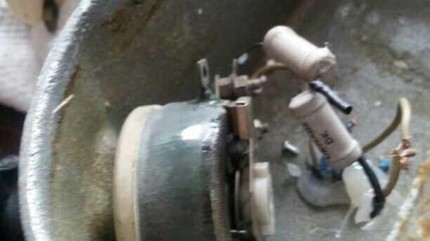

Hi i can not see a model number on the motor at all i have taken it to a companie that does industrial motors the chap there said he thinks it is a 110 dc motor . He has tryed it 9n 240 ac it will spin slow with no resistants (you can stop with ur fingers) then he tryed it on a dc circuit at 50v dc and it span very good and it has risistence and the he tryed it at about 100 to 110 v dc and it span realy fast and risistence was good .seemed to have plenty of torce .also when u put it on to a 240 power it will start to smoke and as I explained had no risistence . So I am now stuck and don't now what to do I have supply ed pics as you can see
