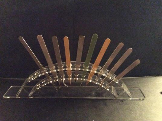

Here are some of my "tools"
Small tiltable table for one of my lathes
larger tiltable table for lapping
Lappingmachine for cases
Simple chuck
"Adapters" for case opener 5700 to open Speedmaster MKII cases, Heuers etc
Stand for oilers, anodized aluminium
Demagitizer
....and much more - I almost like making tools/machines more than refinishing watches!  :D
