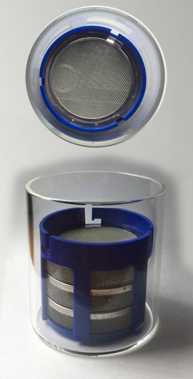

4 hours ago, GregG said:
if I use a mason jar with the parts baskets in it,
A couple of weeks ago I picked up a set of four of these 300ml jars. The Elma basket fits inside very nicely. I fill the basket with parts, drop into the jar and put that into the ultrasonic, then fill the ultrasonic with water to a point below the rim of the jar. I don't use the lids for the jars but so far I've just been pouring my naphtha and IPA back into their containers. Part of me likes the economy of using naphtha and IPA but I might break down and buy a gallon each of the L&R cleaning and rinse solutions (to last the rest of my life). If I do that, I'll use the lids on the jars.
Edited by grsnovi
clarified "it"
You've been ultrasonic-ing pure naphtha?  What is the flash point of that?  I've read forum posts of people who have sonicated petroleum ether (32F flash point) with no problems.
Yes, in as much as I put the naphtha into the jar and the jar goes into the water bath of the u/s. I don't run the heater on the u/s. So far I haven't blown anything up (but it wouldn't surprise me if I do eventually, nothing else seems to be going right).
