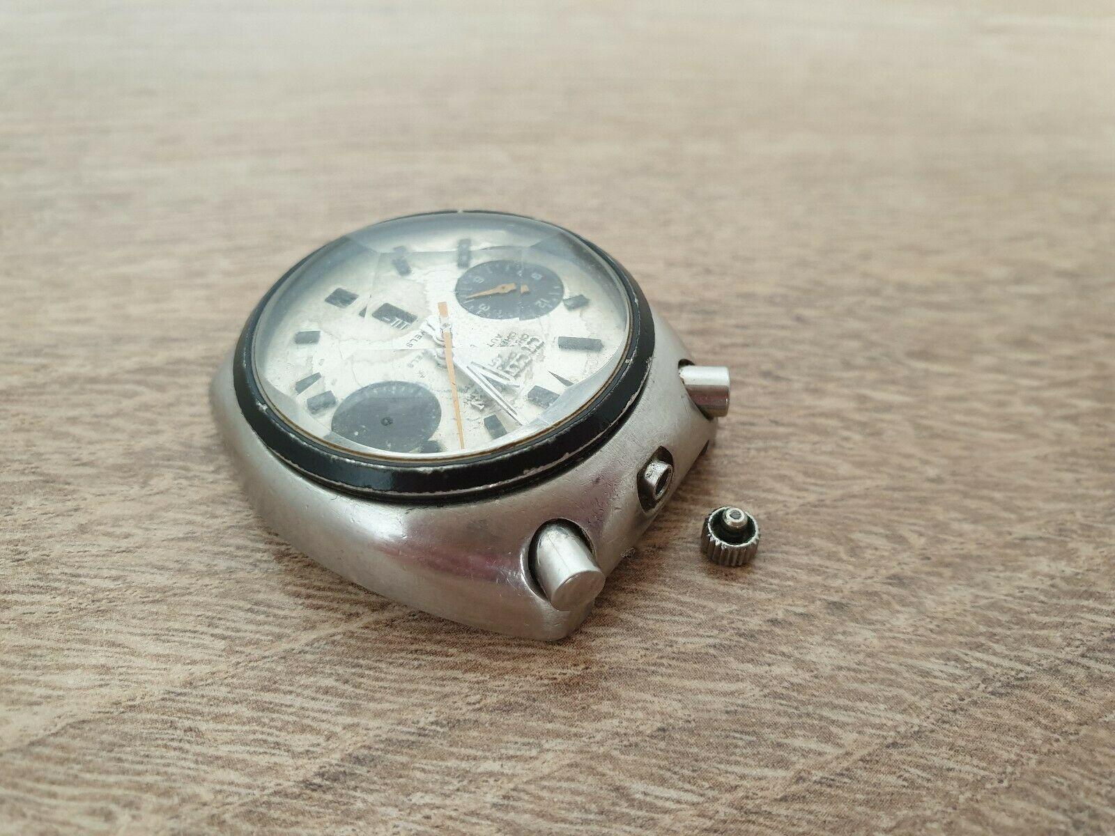

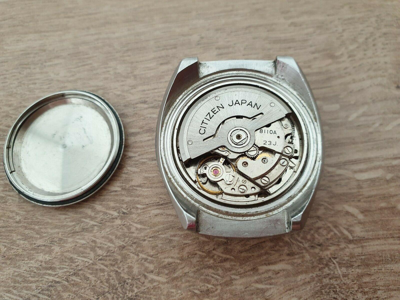

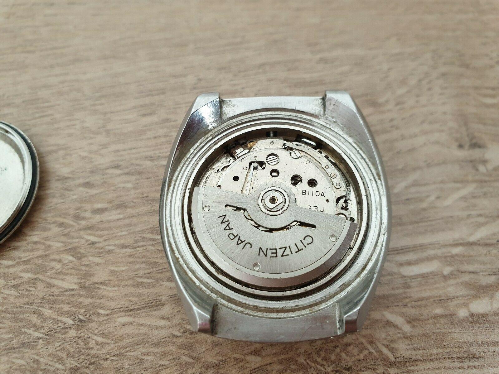

I just grabbed this vintage Citizen Bullhead with the panda dial. It's powered by the venerable Citizen, 23 Jewel,  8110A. It looks to be quite a disaster, but since I'm itching for a challenge and I've always wanted a Bullhead, this will be my chance.
Initial shopping list of parts includes:
  1. New crystal as I'm quite certain faceted crystals were never available from the factory
  2. New replacement or vintage dial in good shape as this one is a wreck.
  3. complete set of hands
  4. stem
  5. possibly a new balance as the hairspring looks to be wound tight, hopefully that is just a lack of perspective
  6. proper bracelet as this one is sans anything
As always, I will post updates and photos as I go through it. It seems Mark has yet to cover one of these on YouTube. Would love to see him go through one himself. If anyone here has gone through one of these or has any spares available, please let me know, I may need guidance. Hopefully I can manage it without one of those Bergeon 3rd wheel pullers as it costs nearly as much as this did.

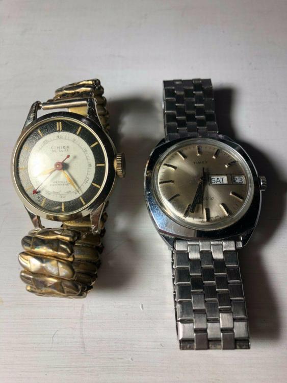

Timex Big Q two hander with pusher crown.
I have a similar watch already, but this one has the relevant metal clip for the pusher, so I can copy its construction for my other version. Hopefully I will end up with two good watches. Time will tell.

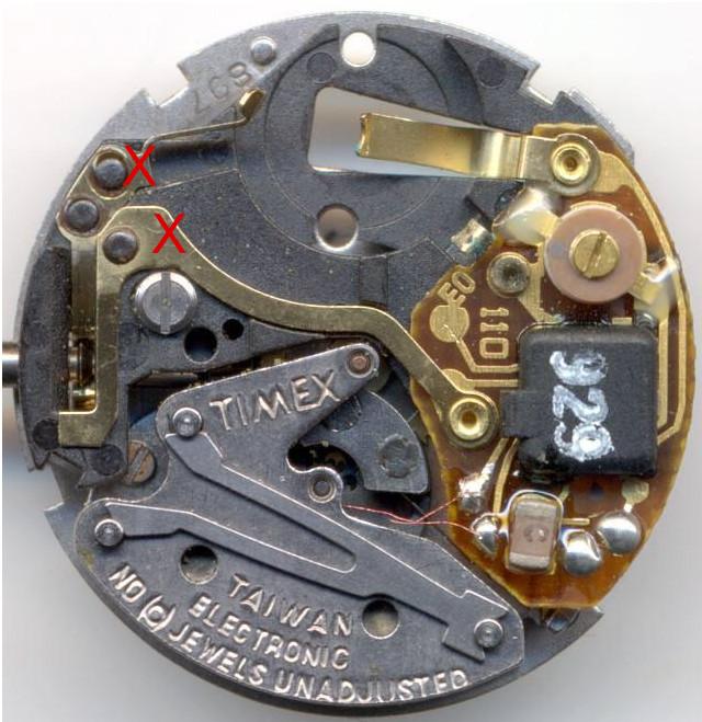

You seem to have the knack of finding the obscure watch bargains that I seem to miss Andy....if you ever come across a battered Timex Jump minute quartz, with a working movement I have a rather nice one, with a FUBAr'ed movement that I would like to get going....
Look for Timex "Q" ladies watches from that period, with the same "Timex '??' cell" designation on the back, and with two hands and a winder, the movement is not that uncommon in those. (Sorry I don't remember which cell it is). There is not much interest in them unless they are in immaculate condition so they usually go for pennies.
Check the coil is OK, and if so, give the thing a quick bath and spray the area round the crown with contact cleaner and see if it springs into life. They are not really serviceable apart from that, as the movements are heat staked or riveted together.
If that doesn't work, let me know, I'll have a look through my junk pile, I may even have one.
Fit the battery, then short between the two points marked X, and see if it springs to life. Remember it only ticks once per minute.
If it does wake up, then the issue is dirt in the contacts at the crown.
When you pull the crown it hacks, as I recall. This is done by disconnecting the + of the cell with contacts operated by the crown. If dirt gets in, these contacts get very nasty, but some electrical contact cleaner may well bring them back to life. If cleaning them doesn't work, but shorting the two points does, you might try tacking (soldering) a very small jumper wire between the two points I indicated. A bit of a nasty fudge, but it would get it going, at the expense of its hacking ability.

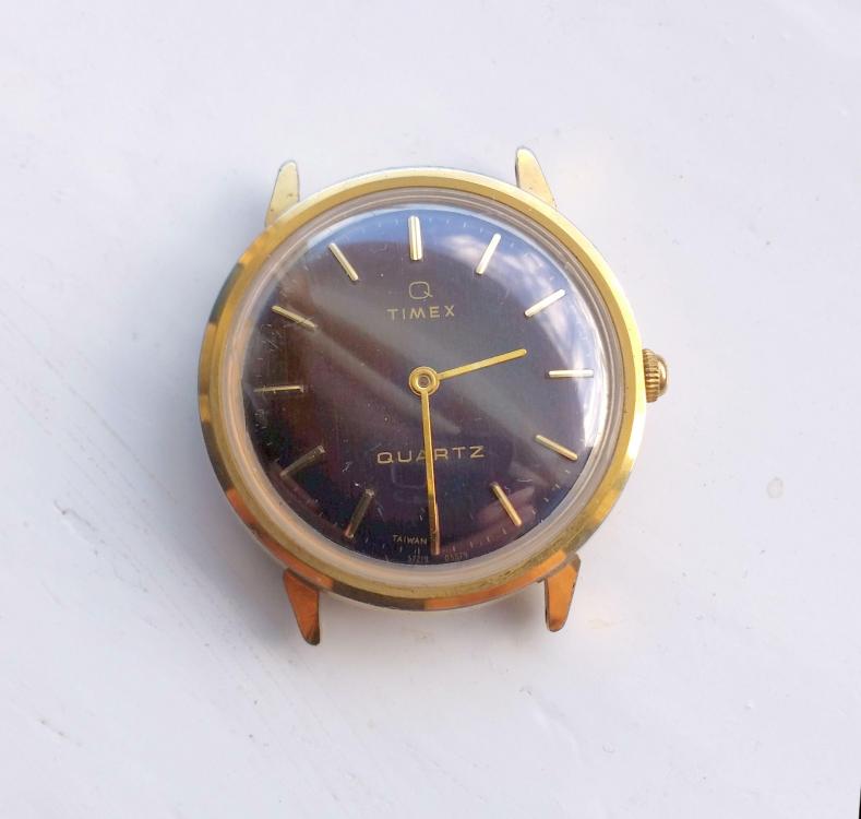

Thanks for the info Andy but my one has physical damage to the wiring of the circuit covered by the black plastic box....:thumbsd:
At the very least its going to need a crystal.
Internally however it looks reasonable, without any obvious battery juice related nonsense.
Filthy of course, but that's not a major issue.

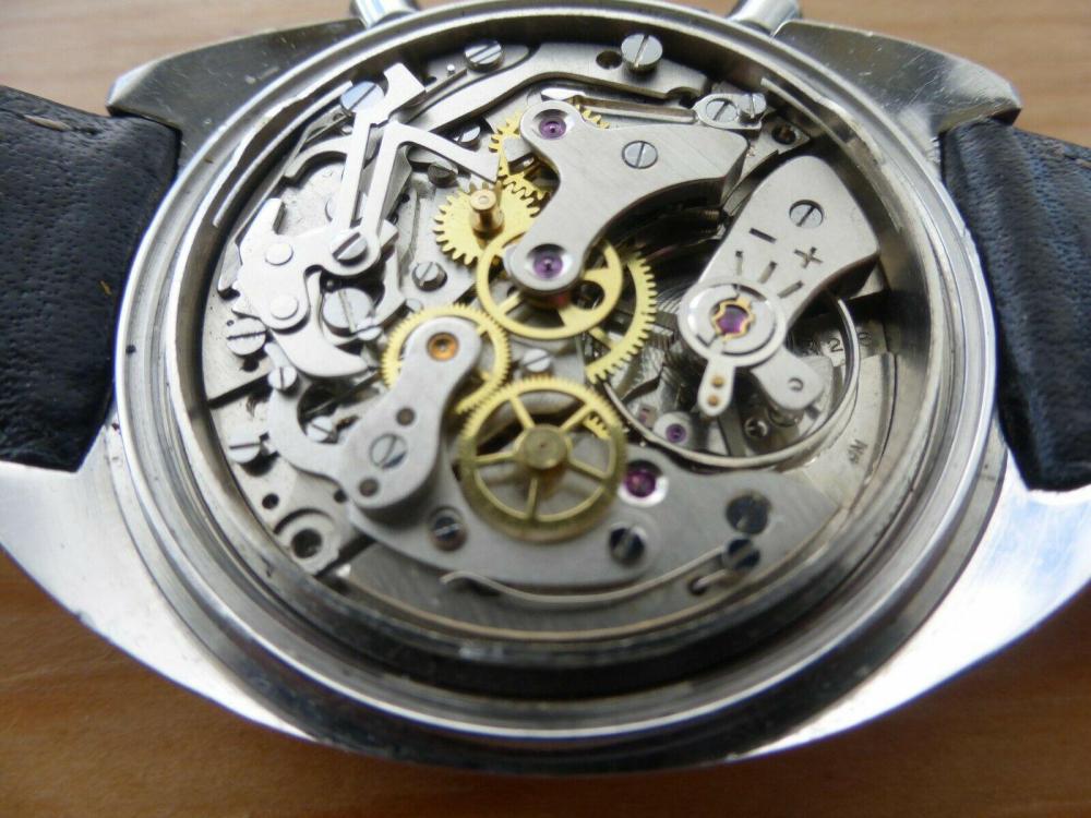

My Tissot chronograph, which I got for a song at a local Pawn shop, has been sold as I wasn't wearing it much. It was bulky and needed a link in the bracelet to fit more comfortably. I was seriously considering building a 7750 clone from eBay parts when I chanced across this Accurist chrono. It is powered by a Landeron 248. It looks to be of a late 60's vintage, but have no idea how to date them. Coming from the UK so it will be a couple weeks. It was sold as running, which is a plus, looks like it'll need a crystal polish for sure.
I absolutely ADORE the complexity of mechanical chronographs! :wub:

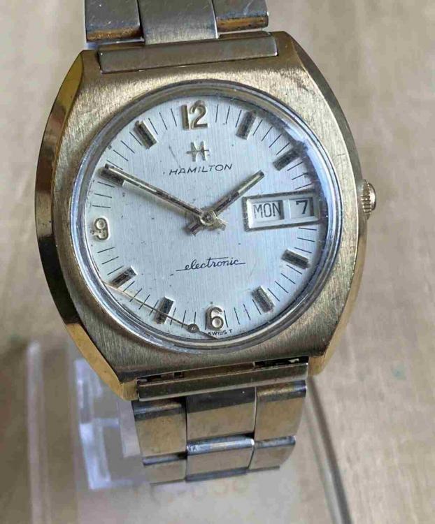

This Hamilton electronic (ESA9158)....
Needs some TLC and possibly a replacement circuit board, but I have some spares for this movement....
