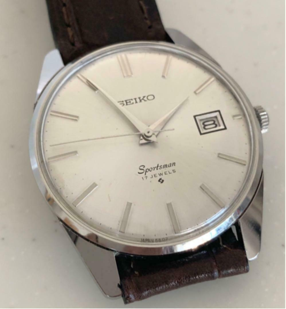

Good job, that band matches the watch perfectly.
By KarlvonKoln · Posted
That is a stunning old Sea King you have! And a very cute little furry assistant also. -
