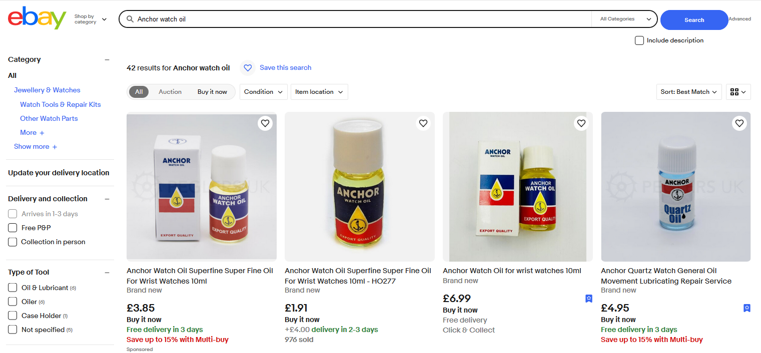

Typically in a horological discussion group expressly for relatively new people or any of us there is quite a sticker shock at the price of a little tiny bottle of oil. For instance let's go to Amazon and let me look for 9010 and let's get an image. First we end up with a confusion of two versions of 9010 at differing prices and differing Reviews? Okay reading the fine print of the third oil it appears to be at least in the way the bottles labeled identical to the Swiss version of it sizes Swiss version I assume it's the same thing is just being sold at a cheaper price but I do have to wonder if it's  a clone or a counterfeit product?
Okay but back to the discussion the middle oil that looks right and it costs $46.95 for 2 mL. The problem is people don't really look at the cost properly. For instance yes I used to use 9010 and  how long did my bottle last before I replaced it? Many years ago I replaced all my horological lubrication's because somebody at a meeting suggested that they should be replaced from time to time. I then decided that I really don't have to replace my oil unless there's indication of a problem because typically now I only do personal watches. But back to the original question how long did the first bottle last we lubricating a watch you're not using very much at all so it seems like a really tiny bottle really isn't considering the quantity you use is extremely tiny. I don't know if anyone's ever figured out how many watches a lubricated but the cost per watch basis it's not very much at all.
But typically that's not the way people look at they look at it and say oh my goodness if I was to change the oil in my car it would cost $1 trillion I am obviously getting ripped off that would be the biggest problem.
Oh and then there is my other amusement with pricing look at the far left hand product look at all the oil you're getting you getting everything to service your watch. Then yes I've seen these kits show up on eBay so somebody is broken apart the bottles they probably bought 20 mL bottles which are cheaper than the 2 mL bottles at a cost per milliliter not for the bottle of course then they repackaged in little tiny bottles and on the surface it looks like it's a good price but if you were to figure out what it cost per milliliter at least the last time I checked the price sucks. So basically it looks on the surface to be a good price could you get a whole bunch of oil you just not getting very much of it. Possibly good if you only one oil one watch you're not really sure if you want to get seriously in the watch repair.

1 hour ago, Swefiddler said:
Oil is after all just oil.
I like that let's go to eBay in this case eBay UK and search for a namebrand product it even comes in export grade. As you can see it's a bargain price.
Oil is most definitely not just oil. Not all oils are any good for lubricating all things and are formulated with several additives depending on the application. You wouldn’t use engine oil in a gearbox for example, the engine oil is formulated to be circulated by a pump and filtered, gearbox oil to have fast moving parts sloshing about in it, no filtration or circulation. These need very different properties preventing emulsification or carbon retention, vastly different from watch oil. Your diesel oil likely is for a combustion engine and will have detergents added for decarbonisation of components due to combustion, watches don’t. If nothing else there is a potential issue with that for watches, namely adversely affecting the plating of wheels and plates/bridges/cocks after long exposure. There are many stories of watches having the above affected with too long an exposure to cleaners that are designed for use cleaning watch parts.
