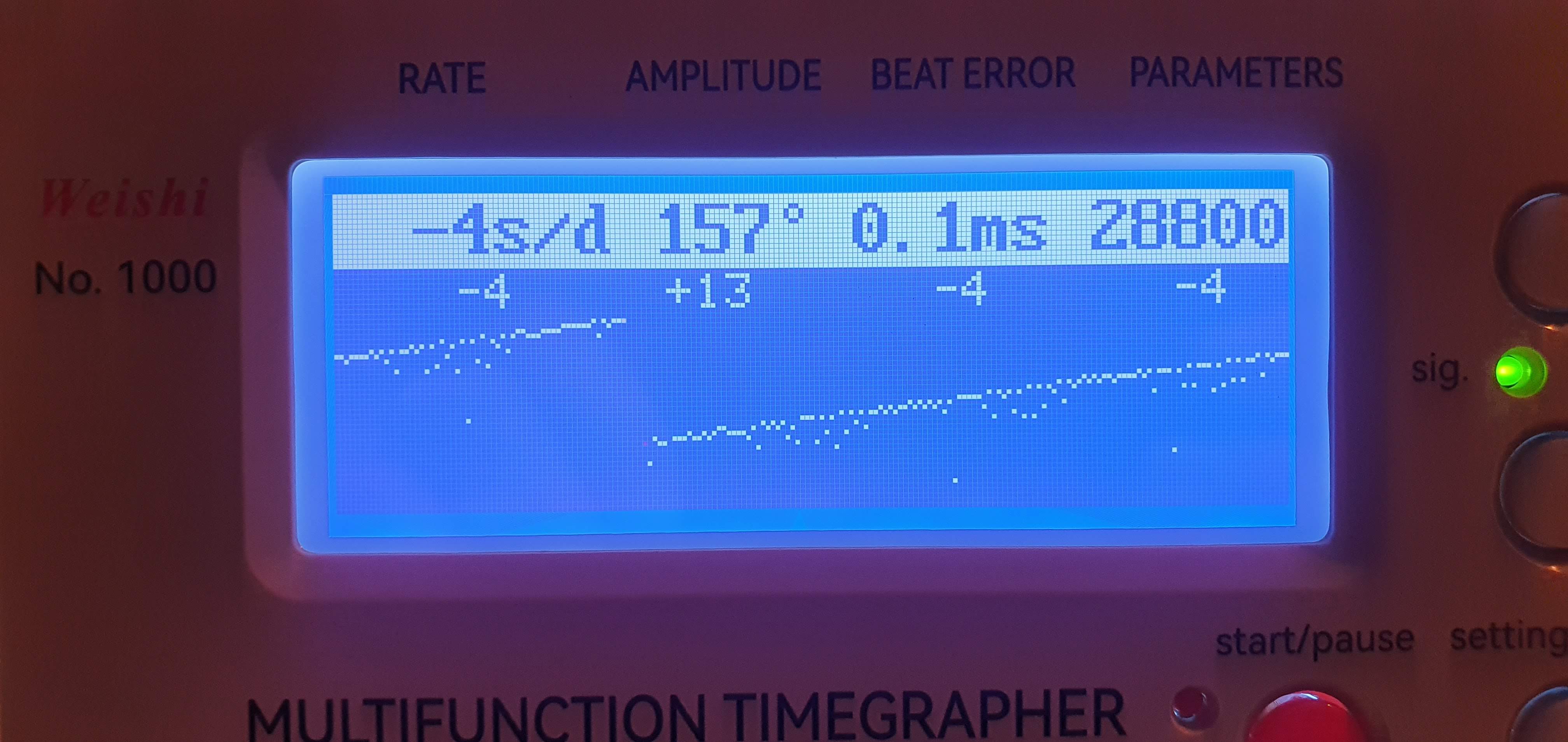

I have a 5 year old Citizen NB0040-58E Grand Classic, and recently it started to gain over a minute a day, which couldn't be corrected. Timegrapher (tg.jpg) showed amplitude of 150, which is way too low. So I gave it to a local repair shop for an overhaul.
Second attachment shows what I've got back. Amplitude still very low, but I could regulate it to be accurate enough.
Need advice on how to interpret this and what to do. Does it mean watch is broken beyond repair?
Thanks

Looking a the two timegrapher readings it looks like all that has been been changed is an improvement to s/d. As JD correctly states this watch needs a overhaul and service. One side of the escape I suspect is just dirty or lacks lubrication.
Edited by clockboy
The point is ,  if this amplitude is to be regarded as valid,  then other numbers tg shows are invalid , ie; at such low amplitude other values tg shows you are invalid.
Actually your watch might do good amplitude in several positions and not in the position you took these measurements.
So , will you check the amplitude in several positions as well as visually observe the amplitude of the oscilator.
How is the daily rate on bench and wrist?
Rgds
Hi. Thanks for all the replies!
Movement is probably Miyota 9011. I couldn't find the datasheet, but used lift angle of 51deg, which 9015 is using.
I was charged $150 for service, which was an overhaul and lubrication, I don't have any more details.
The only position I used is screen up. Watch was fully wound.
Now I did 2 more measurements: one yesterday evening, a few hours after writing this post (tg4). And one more today (tg5). As you see, readings have improved dramatically. I didn't change anything! So now I see two options: tg is broken/inconsistent, or watch needed a break-in period after service.

It kind of looks like a settling down of the watch after lubrication. How soon after the shop service were the first tg readings that you posted initially.  That same day ?
@Neverenoughwatches yes, first results were posted the same day. Apparently they serviced the same or the previous day, although it took them 2 weeks overall. Not the greatest service apparently, and they also left quite a lot of dust on the dial. But its hard to get any service for a Japanese movement that will cost less than the watch itself at all!
@Klassiker things improved further a bit and I was able to adjust the gain somewhat. It still depends on the position a lot, but that's normal I guess?
dial up: +5s, 269°
crown up: +15s, 235°
crown right: +6s, 239°
crown left: +20s, 249°
crown down: +13s, 236°
dial down: +1s, 270°
beat error is 0.1ms, line looks very clean
Thanks!

These seem quite reasonable, all  verticals similar with CL a little higher, a little less lock on the escapement ? . A few fortnightly or monthly tg readings would be interesting. What power reserve are you getting ?

These are very acceptable values, and it seems a competent service was performed after all. If you are confident that your first set of measurements, immediately following the service, were accurate, then I repeat what I said before. The watch should never have left the shop like that. Any running in should have taken place before giving the watch back and charging you. Two weeks is relatively quick, and 150 USD a resonable charge for a full service.

Reviving this thread, about 1 year later:
dial up: +15s, 248°
crown up: -10s, 200°
crown right: +8s, 225°
crown left: +3s, 200°
crown down: +12s, 230°
dial down +8s, 212°
beat error 0.2ms, line clean in some positions and double tracks in some others. Numbers take a long time to settle, and sometimes go -45s → +8s and 164° → 212° after a few minutes.
not sure if it makes sense to service again

Numbers I posted are after my latest regulation attempt, which I did after watch lost 4 minutes overnight. Now it does about -12s/day. Variation and amplitude don't look good to me, but I don't know what to expect from a 6 year old movement. Replies above tell me that's expected, so I'll go with that.
Is it common for automatic movements to degrade this fast though? Would the same happen to a higher end stuff like GS or Omega?
Well, that's very significant new information.
The watch runs with a positional variation of 25 sec. when fully wound,which is what we knew so far. That's also more or less the performance you should expect to see on the wrist, with the automatic winding. So far, so good.
However, if you are seeing -240s overnight, i.e.in 8h (you don't say in which position), then something is seriously wrong. It's also not a problem you can correct by regulating.
A 5yr old movement of reasonable quality should run like new as long as it's been looked after. I have no idea how Citizen movements perform over time. If it is worn out, your best best would be replacement with a new movement.
You have a timegrapher. Let's see the traces in six positions fully wound and after 8h rest.
OK, here are charts in 6 positions when fully wound. Will post another 6 in 8 hours 😃
Apparently runs too fast now, will try to regulate again after this test.
