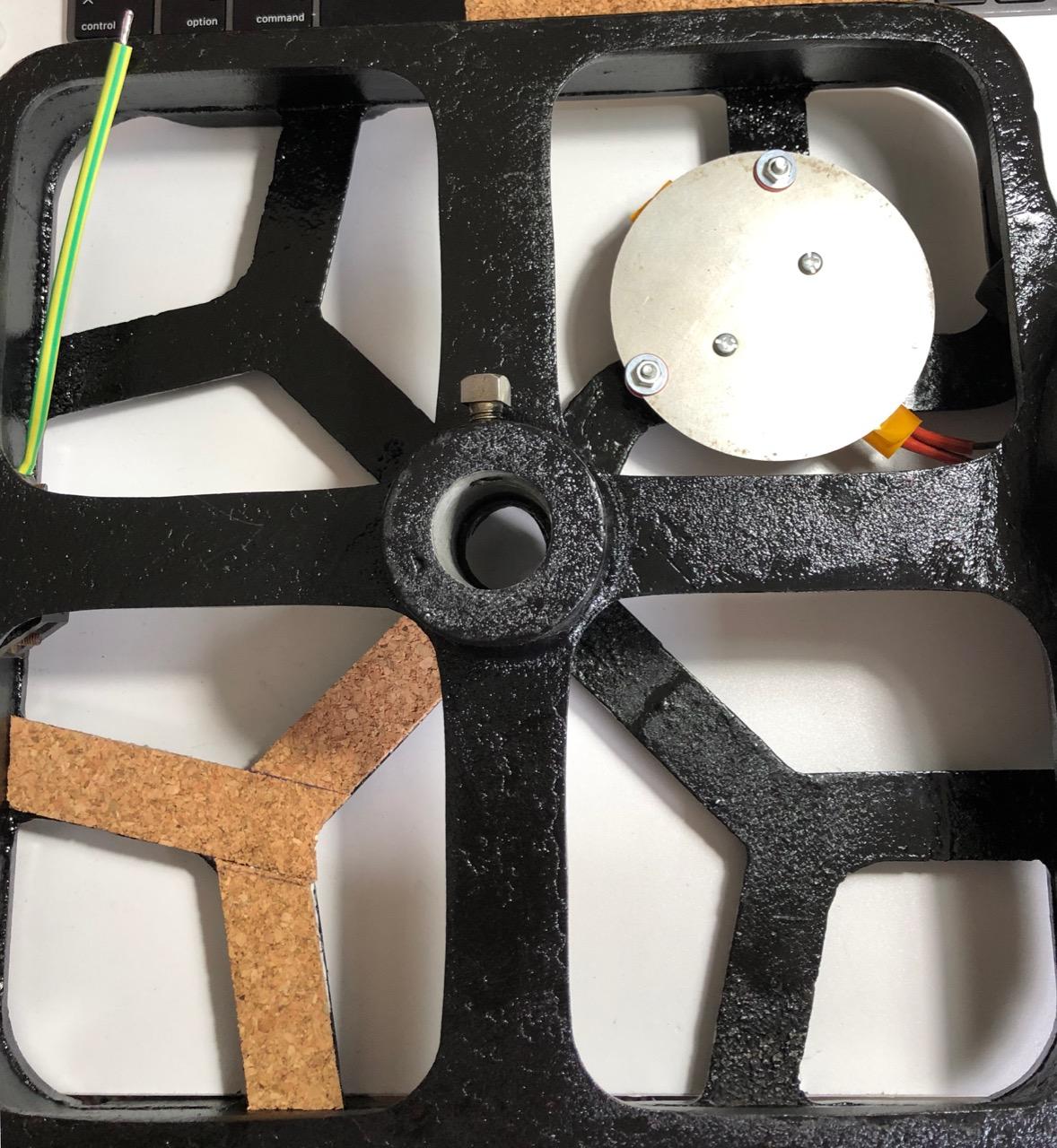

Back to the job in hand.
I managed to find the cork I thought I may have had, lurking in a box under the stairs. It was the most part of an A4 sized sheet, so more than enough for my purposes - to sit the jars on whilst they are in the machine.
Looking at the metal bases, I really can't be convinced if there ever was any cork or any other material for that matter there. But for me anyway, the idea of the glass jars sitting directly on the metal base just seems wrong and I would prefer some cork there as a cushion.
It's about as tidy as it needs to be, given the shape of the metal webbing. I suppose I could have cut-out squares of cork, but then it would leave potential weak, unsupported areas of cork, which would likely need some form of strengthening.
Anyway - this application suits me and helps the jars sit a bit more stable in their locations.
Whilst I am in the vicinity, so to speak, I have also added an earth lead which will bond the chassis to the incoming mains lead, once fitted. This is visible in these photos.
Edited by Moose

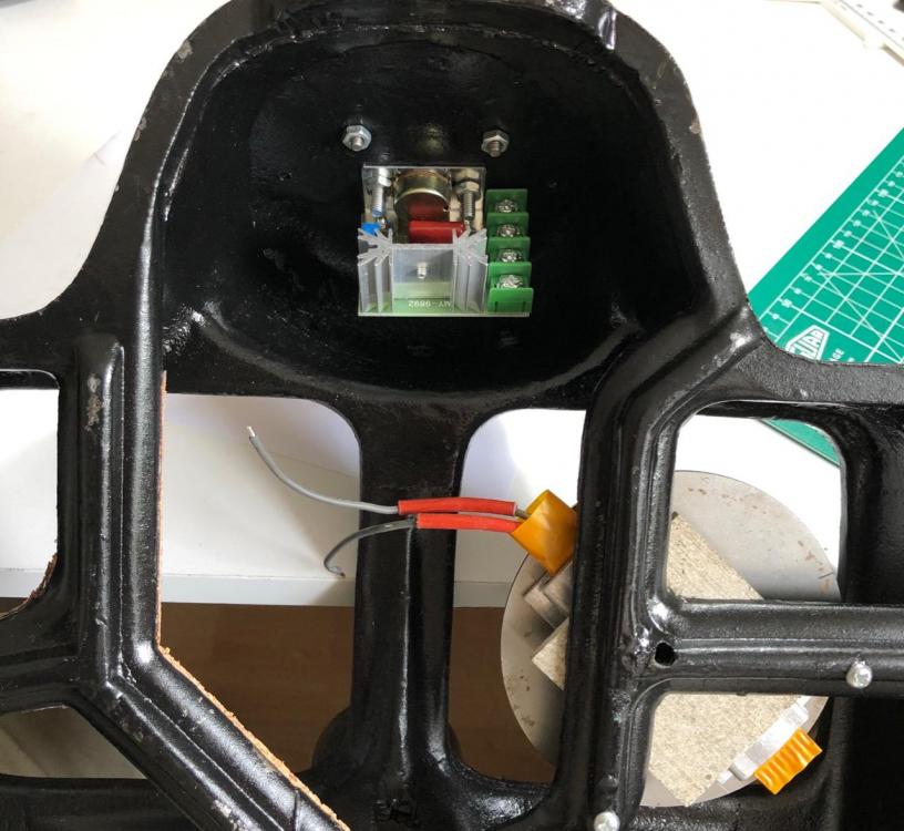

Next up is the motor speed control.

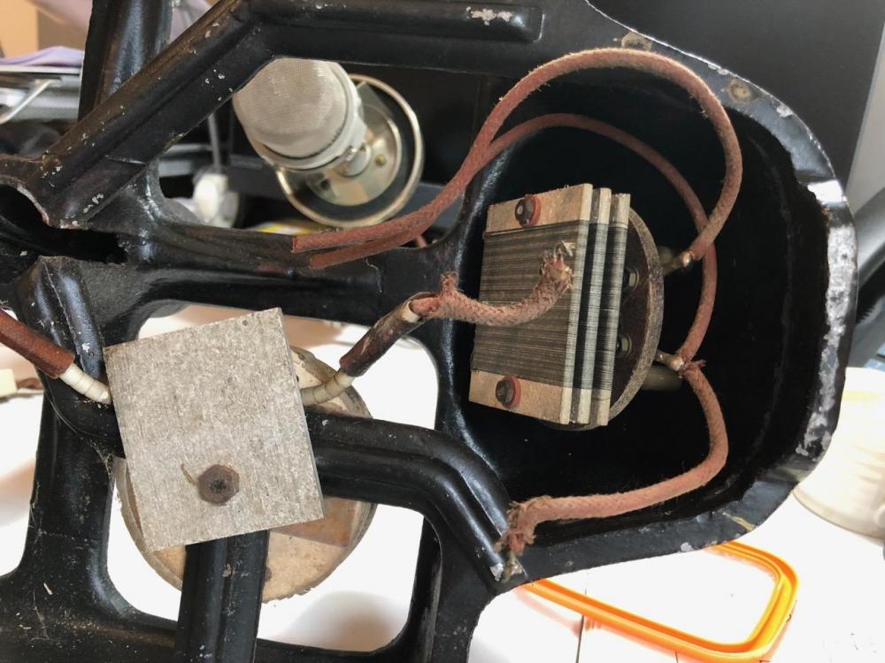

I did think long and hard about my original aim of maintaining as much originality as possible. And, there is no doubt that the original speed control rheostat was a) original and b) functional. But - as I was an electronics technician in an earlier life, and also health and safety professional in a more recent life, the safety aspects weighed heavily upon my concience.
Logic played it's part as well - with the original rheostat put back into service, albeit with some hand-made guarding to keep out the fingers of the unwary, it would be safe-ish, for me to use, as long as I kept my wits about me.
BUT NOT SAFE FOR ANYONE ELSE unaware of what was underneath.
Only the knowledge of what lurked underneath would be keeping me safe, but anyone else might not have a second chance.
As can be seen from the photo below, all of the wire on the resistors is not only unguarded, but within millimetres of the level of the base. Also, the incoming mains terminals to the rheostat are also dangerously unguarded.
With today's knowledge, it is difficult to fathom how this ever could have been considered safe to use.
Edited by Moose
I certainly did not want to replace the motor, as this is so very visible, all attempts at maintaining the illusion of originality would fail. A solution to the problem could only be achieved with a safer, replacement speed control, which could work with the original mains voltage motor.
Fortunately, these are readily available in the form of a Pulse Width Modulated (PWM), motor speed controller circuit. These will take in the 220V incoming mains supply and provide a variable output of between 50V and the incoming supply voltage. These are well known devices and proven to work with even simple (old) motors.
So, a PWM circuit was obtained (at incredibly reasonable cost), and measured up.
In an attempt to at least have the "illusion" of originality, I was determined to use the original hole for the rotary speed control, as well as the original Bakelite control knob. With the shaft on the rotary potentiometer too short for this, I had to do some more metal bashing.
As can be seen below, I used the old rheostat as a donor, for a short length of it's shaft, which I would mate to the new potentiometer, allowing the Bakelite knob to operate. This was cut to shape and filed to mate with the new potentiometer shaft. This was then soldered together and thus ready for installation.
You can see in the photo, the size and technical comparison between the old rheostat and the new PWM controller circuit.
Edited by Moose
Installation of the PWM Controller.
This needed two new mounting holes to be drilled in the main base of the watch machine, the old rheostat fixing points being way too far away to be useful.
Thankfully - and by one of those happy coincidences that just make your day, when they happen - two new fixing holes could be drilled and they would be hidden by the old control knob when it was in place. Happy Days!
As can be seen in the photos below, the new controller occupies far less space and, just by itself, is a much safer solution than the original.  I also hope that motor speed control will be far smoother than with the original. I will still make up an internal cover of sorts, just because I can, and I because am minded to.
I cleaned up the old Bakelite knob a little and ran a little silver paint into the arrow head engraving, to brighten it up. And, as can be seen, the two new mounting holes for the PWM controller are hidden by the knob. Result!
Finally, I replaced the original mounting screws for the old controller, so I did not have holes left on the dial. I think this is the best compromise I could have arrived at, as at least from the outside, the old machine looks to be still original and nothing visibly takes away from its undoubted age. After all - I am dealing with something likely to be over 75 years old and I was trying to take nothing away from that.

A short one today.
I was bothered about using rubber seals in the jars. I have never seen the original seal in a National jar, but thought anyway, that cork would have been far more likely.
So cork it is. Obviously, you can't buy the seals and Elma (etc.) seals are all the wrong size, so the rest of that cork sheet I had was used, and I cut them by hand.
These jars are quite a bit bigger that it's contemporaries and I think that is a legacy from these machines also originally being supplied with clock cleaning baskets, as an option. The jars are around 110mm square with around a 90mm neck size. Don't think I have seen any available as spares anywhere, so likely difficult to get hold of without the purchase of a whole machine. Anyway, I'm happy with these now.
That old rheostat looks exactly like the speed controller in a very old train set my Dad passed down to me. It was a huge brick of a thing which sadly failed on its first attempt and I never did get around to getting another sorted but still have the train set.
Yeah, I can image that sort of thing on a old (very old) train set. It's all a bit "Frankenstein's monster" really. The mains come in and connects the the rotary wiper. It normally rests on the first brass conduction (where it is in the photo). and this conductor is not connected to anything, providing the whole thing with a sort of rudimentary "Off" switch.
Rotating the dial wipes the mains across decreasing amounts of resistance, until the minimum resistance point is reached when fully rotated.
Quite scary really - bear in mind that the red insulated lead is normally connected directly to 220V at all times (unless unplugged), and that it is no more than 5mm away from the metal of the base when installed. There's no insulation between the rheostat and the metalwork of the base, excepting for the insulation on the wire. AND this wire is under continual rotational stress every time the machine is used. The wire I removed had all of its original insulation perished and it literally just flaked off in my fingers when I removed it for replacement.
I actually fabricated a piece of insulation which would sit between the rheostat and the case work, but in the end, my conscience got the better of me - it had to go.
If any one else has one of these National Machines, or is considering getting one from somewhere - I strongly recommend examining this item carefully, or more practically, completely replace it, as I have done.
So unsafe!
"Safety" would be provided in the form of an earth on the metal case, and a fuse in the plug.
The only protection this actually provides is to ensure you *probably* don't burn the building down, assuming these two things do what they are designed to do. There will still be a big bang and a flash and a lot of magic smoke released if there is a fault.
However, if the earth wire is disconnected (or if the earth pin on the mains plug is nicely covered in a thick layer of insulating crud), then when that red wire with the flakey insulation moves,  falls off, or somehow contacts the case, the entire thing becomes live at mains potential (or perhaps a few volts below, if the crud is mildly conductive).
This can make for a very disturbing and potentially fatal experience if you were to grab the metalwork.
You would probably survive in a modern house with RCD protected circuits, but out in the shed or wherever, and "protected" by nothing but a 30A ring main fuse... you would probably be clean out of luck.
