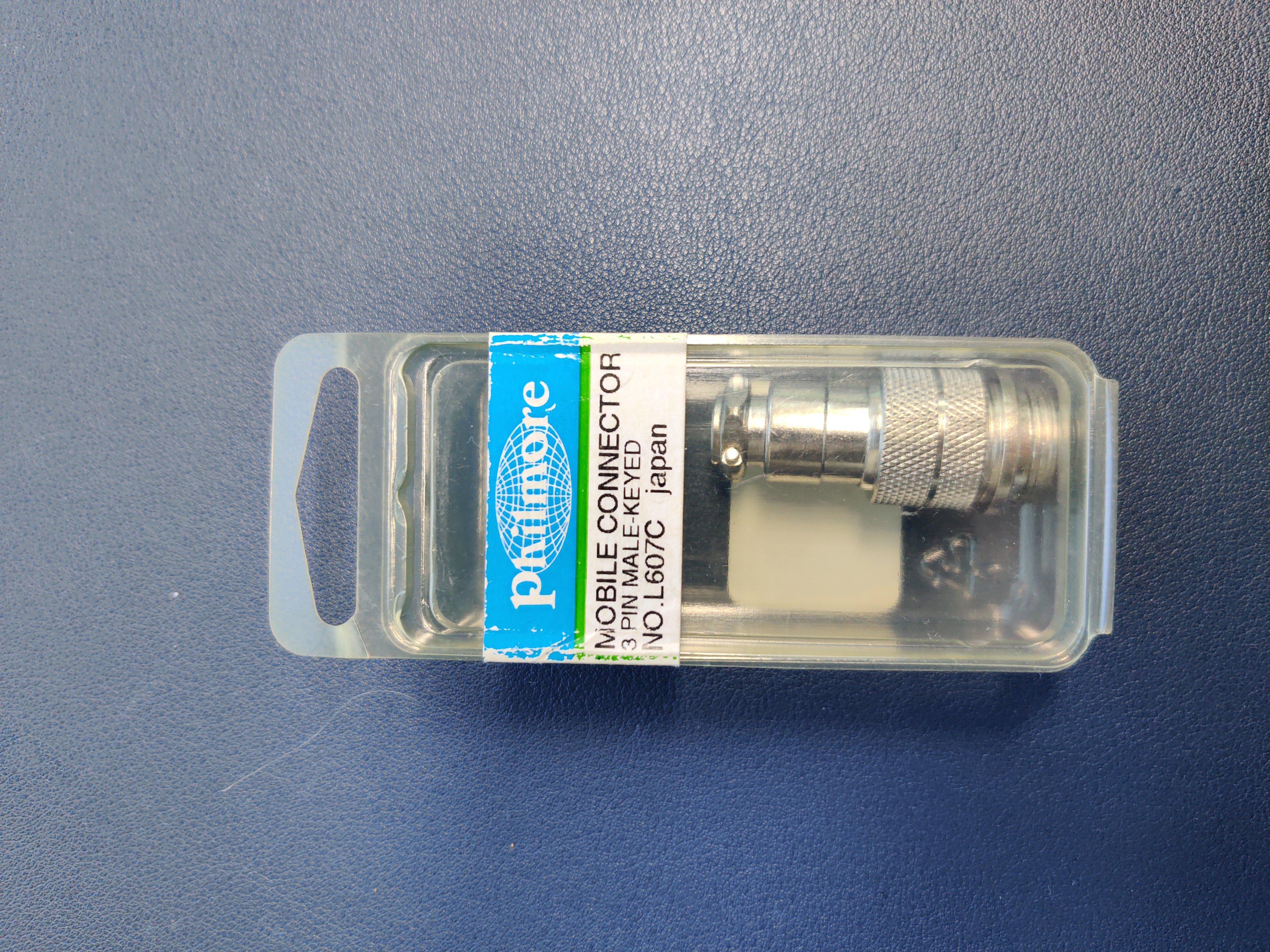

This is great.  I started researching the connectivity of the jack just the other day, with the intention of building an interface to my oscilloscope so that I can see the audio.
I think that is a standard XLR connector.  I will verify that later today when I find my audio cables.  Another approach would be to buy an XLR splitter and run that between the sensor and the box.  That way you don't have to modify the original sensor.  I will be pondering this.
No, it is not XLR.  Similar style, but not the same.

I'm pretty sure all of this has been covered somewhere in the discussion group. The connector is not a XLR even though it looks like it is and who knows maybe it will work it's actually a Chinese connector. Yes I know isn't surprising the connector comes from China. But you get the right connector it works really well.
Now the question is did I keep it in my favorites for eBay and can I find it for you? So yes it's missing from the saved searches it was therefore long time there definitely Chinese as that's where I got mine from they fit perfectly catch is you have to get the right size so I have smaller connectors that don't fit that there is still nice connectors and I'm sure I'll use them someday. But maybe there's another way to find what you need colleges have to do a search

Then found the link to the connector I bought from China it is the exact same connector found on the Chinese machine and it looks like they have some specifications. Just have to specify the number of pins which I believe is three. I know there's other sellers but then they have other sizes so you do have to get the right size
https://www.ebay.com/itm/153100026955
Because the size was bothering me is looking at what I had previously purchased and realize they actually had a image so I snipped out the image.
Edited by JohnR725
I did some reading up. It's called a GX12 connector, made by Renhotec.
It's supposed to be designed for industrial and aviation use.
Aliexpress has it listed under aviation connectors.
Is it GX12 or GX16?  Both have been mentioned. Should be easy to measure, the black plastic bit with the 3 holes in it should be Ø9 mm in the GX12 and Ø12.5 mm in the GX16.
Consider looking for extension cables, these give you two connectors with cable already soldered to them and are sometimes cheaper than just one bare connector alone.  One should be able build an adapter with one ⅛" audio cable, one USB cable (for power), and one GX16 cable.

1 hour ago, xyzzy said:
GX16
If you look at the link I gave above the ones that I purchased which do fit they say 16. Then I swiped the image off the eBay and it looks like the size is the hole diameter that the thing amounts in which is 16 mm which is what I have.
Then if you're tapping off of the microphone from the timing machine you don't need a power supply. I believe there's a 6 V regulator powering the microphone should have more than enough power to power something else.
