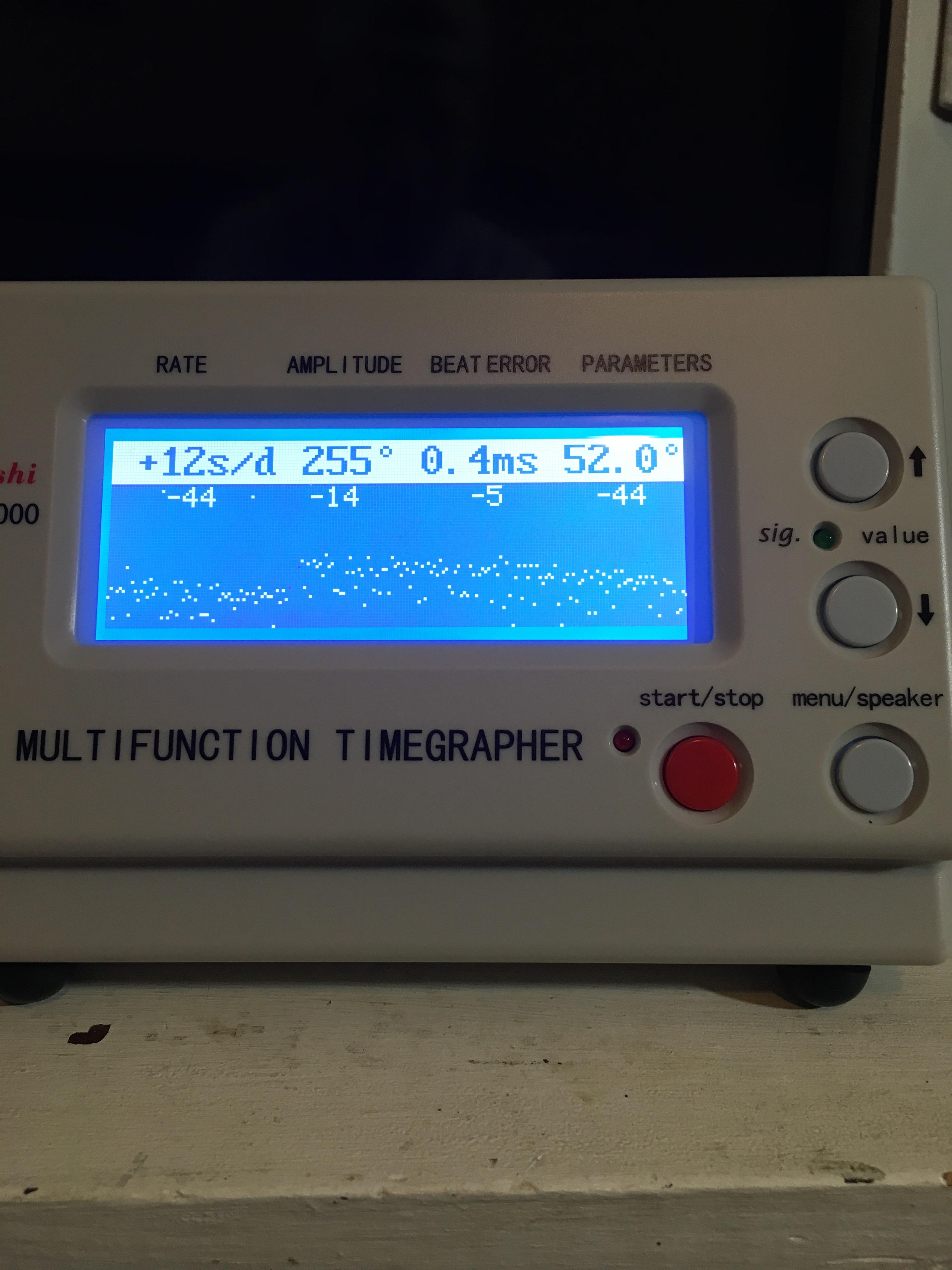

I got the balance endshake Took care of the cap jewels needed tapped in on each side . So endshake is good now. But it still sticks when no power on the train and I move the balance wheel back and forth. Sometimes it freely spins and sometimes it skips a little and sometimes it locks up and I have to turn the balance in the other direction to free it up.  I wound it halfway to see how it does on timegrapher here’s some pictures of what it’s doing. Ones dial up and the other dial down. Amplitudes actually less because of lift angle is 52 degrees and I know the watch is around 42 degrees. I just did it quick to see how it runs.A1AAEAE6-779B-436E-A938-C931C7ADC6EE.thumb.jpeg.c385232c06d2ce2da9955d013f4a46d1.jpegC9B180C9-40E6-411B-A52C-8EDA3C91DD8D.thumb.jpeg.efa20787a1111c2f921c23c7f6d711d6.jpeg
So the mitigating factor is that it sticks when the fork/pallet is in and works ok without the fork, is that a correct assumption. If so then its the relationship between the for/pallet and the inpulse pin roller and balance, Take the power off the watch amd swing the balance and try that du and dd and see if it still sticks. If so its  srrip it down again and just ft balance and fork/pallet and re try.
Dial up and dial down pics after moving the right banking Pin just a hair.It might still need a slight adjustment But at least it runs with healthy ticks and tocs now. Thanks everybody for the advice. Hope y’all have a good evening.
I think that was making it stick to the left banking pin every time was because the right banking Pin needed to go out just a little. Escapements are very very tricky. i’m sure it’ll go even better when it’s got a full wind.
Edited by Crockpot
Looking at the regular fluctuations in the trace, I think that there is an issue with the escape wheel.
Maybe the pivot of the escape wheel is bent and when the tooth farthest from the axis reaches the pallet jewel, it doesn't unlock. Moving the banking pin might free it.
Possibly excessive depth of lock if the banking pin was allowing the pallet stone to enter more deeply than necessary.
It’s worth investigating / observing the depth of lock as it can steal energy from the balance. If you still have issues with the escapement locking up then perform tests to check the “safety action”.
