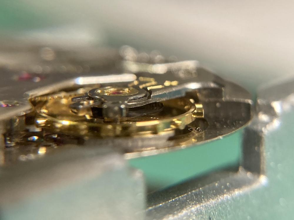

I recently got a Bulova 11AL from a local jeweler who asked me to fix it up for him. He knows I'm an amature but said he'd give it to me it practice on and told me to bring it back to him in a week to see what I can do. He told me It was gaining. Which it was. Around 720+ seconds per day. After my service and regulation I got it down to 70 seconds per day. The regulation arm wont go any further without touching the beat error regulation arm. If anyone has any helpful advice for me to use I would seriously greatly appreciate it.
(By the way, the balance jewels are cleaned and lubricated)
 What is the amplitude, and beat error of the movement, If the movement , is still fast with the regulator in full retard,  check the balance coils for fouling the cock or balance arms andthat they are not sticking together during oscillation. also bear in mind the fact that it may be magnetised so a demagnitisation would be in order.
I demagnetized the movement before any nothing really changed. Amplitude is at a good 270 give or take. Beat error is 0.2ms. Nothing is fouling either. Thanks for the reply by the way.
It seems at though the hairspring need to be manually lengthened. Almost like I can carefully pull some more hairspring out of the lever so I have more to work with? Not sure if this is a good idea but that was what I was thinking.

Post a good picture of the end stud.
34 minutes ago, MattyG said:
Here
There is no hairspring left for repinning longer, maybe it had broken at the stud and someone "fixed" it that way.

Post a picture taken straight above the balance installed, and one taken laterally. Hairspring manipulation is not as easy as saying it, and many have been by beginners and not. That's why I recommend that if you care about this watch, practice that skill on something else first.
That being said, considering that the balance has timing screws, that is what I suggest you should use to slow it down.

I was looking at that picture again I snipped out something they hairspring is on the wrong side of the pin why is that?
3 hours ago, jdm said:
Post a picture taken straight above the balance installed, and one taken laterally. Hairspring manipulation is not as easy as saying it, and many have been destroying by beginners and not. That's why I recommend that if you care about this watch, practice that skill on something else first.
When you post a picture could you try really hard to give us a clear image of the hairspring in the watch. Then good picture aimed at the regulator at an angle so we can see where they hairspring is exactly. Also what's being asked above a nice picture at a proper angle so we can see if the hairspring is actually flat.
Then I also agree with the above quote hairspring manipulation on your first watch probably isn't going to end well. We really need a hairspring to practice on or several of them that you don't care about.
Maybe someone placed it that way to slow it a little bit.
