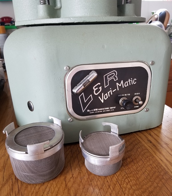

Folks,
I just purchased a Vari-Matic in perfect operating condition.  The numbers 12 29 67 are stamped into the hydraulic reservoir/aluminum base so I suppose it was made on 29 Dec 1967.
Does anybody know how to increase the spin-off time between stations?  I've found a couple YouTube videos from 2016 and 2011 but I can't reach those folks.  Can you please offer any advice or point me in the right direction?  I'd really like to make this modification but my electronics knowledge and skills are near zero.

You can't, the time is fixed because the indexing motor runs a certain speed and it runs constantly until the basket drops into the next jar.
You should concentrate instead on making sure the spin-off speed is as high as possible without causing the fluid in the jar to swirl around and splash up and out.  All the speeds are controlled together with the rheostat you can set with a screwdriver.  But the proportions of the speeds to one another are controlled by the taps on the wirewound resistor that you can move.  I forget the exact details ... do you have the manual?  It's all spelled out.
My machine was wired wrong when I got it, giving a spinoff speed that was slower than the drying speed.  The spinoff was useless and the drying would wake the dead.  The spinoff is supposed to be faster than the dry, and it works great with that fixed.  I have been using it for 15 years now...?  Probably ran it six times today.

Sorry, "You can't" might be a little strong.  If you give up on using the electro-mechanical timing and synchronizing system built into the machine out of simple cams and switches, and replace all that with a computer of some kind, you can of course make it do whatever you want.  In my opinion that's unnecessary, and unnecessary computers should be avoided in things that I need to rely on for a long time.

Thanks, Chris, for the quick reply!  I sincerely appreciate your help!!  At 6 times/day for 15 years, you really know this machine ?.
Yes, I have the original manual.  I'll review it and the information you provided and take your advice.  I might have a followup question or 2 ...

My rinse's jug just says L&R Ultrasonic Watch Rinsing Solution.  An older one waiting for disposal does say #3 though, I don't know what the difference is.  I use the ammoniated #111 cleaner.
After the dry cycle, the basket on mine is too hot to touch for a few minutes.  I doubt there is any appreciable risk of fire if you are using the solutions meant for the machine.  I think we would have heard about it?
I will be interested to hear if you determine yours is also wired wrong (or what I call wrong, anyway?) in the way that gives a faster dry and slower spinoff.
Oh, does your fan run when the heater is on?  It should.

I read through the manual as you suggested and learned quite a bit (go figure!!).
To answer your questions:
1) Yes, my dryer fan runs perfectly.
2) I don't have a way to measure the basket rotational speed, but the spin-off speed seems to be faster than the drying speed .... or about the same.
The manual specifically lists L&R Extra Fine Watch Cleaning Solution and L&R #3 Watch Rinsing Solution as the recommended solutions.  I'll have to research the difference between the Extra Fine Watch Cleaning Solution and #111 but since you use #111, that's what I'll use, too.  It seems I have no worries about the #3 catching fire during drying.
How high do you fill your jars?  The manual says, "to the middle of the L&R on the jar".
When you clean watch parts, do you use the "Watch Basket" (smaller one) or the "Clock Basket" (larger one)?
If I'm reading the manual correctly, I should set the rheostat with the Clock Basket installed and the High-Low switch on High.  Then, set the adjustable resistor slider (Purple Wire) with the Watch Basket installed and the High-Low switch on Low.  Finally, set the drying speed with the other adjustable resistor slider (Orange Wire).

I really only use the small baskets, I have three of them so I can fill one while another is running.  Often I use two baskets for the same watch, it takes two or more runs to clean everything, especially a chronograph or an 18s pocket watch where not everything will fit in there at once.
I have the ultrasonic unit so the jars have to be filled up above the L&R letters, and with the ultrasonic the fill level is very critical.  The fluid should be up the ultrasonic head about a cm when it's running.
If you are not using the ultrasonic I'd say fill them enough that the basket stays immersed when cleaning but is free of the fluid during spinoff.  It's not critical and you won't hurt anything if it's wrong.
