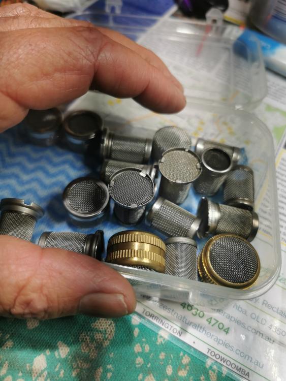

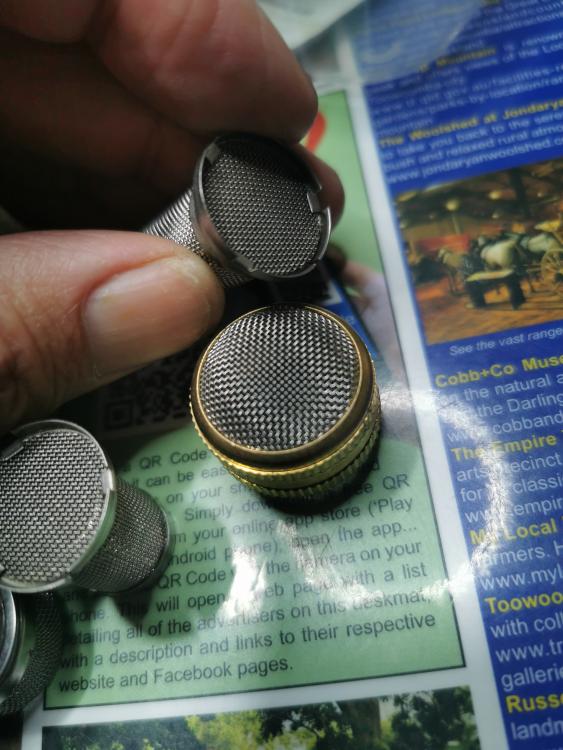

These stainless steel baskets are great if you can get hold of them. Smaller grained mesh than bergeon screw baskets. All parts screws, cap jewels, some bridges will fit. Never had to search for parts stuck to mesh. Plates go straight into the jar along side these baskets. Just tip parts out when dried using hair-dryer. No lip or edges 16218522299347659625089453676342.thumb.jpg.368c39eeb2547093959475db1bef538f.jpg16218522299347659625089453676342.thumb.jpg.368c39eeb2547093959475db1bef538f.jpg
Edited by Graziano
They look ideal. Any idea where to get them ?

Looks like we went to the same basket store? Just now looking at mine looks like we have the exact same ones.
The baskets with the snap on lid go with the watchmaster cleaning machine. Baskets come in two sizes and unfortunately I usually astronomically expensive when you find them. Even look on eBay currently the large basket is either $45 for one or 85 from somebody else. Then the separate baskets usually go with the holder and they are almost $200. So it's a lot of times hard to find them separate but they're probably on eBay eventually they just tend to be pricey.
Keep your eye on auction sites, they are hard to find but they come up for sale every now and then. I haven't seen any new ones from suppliers like the ones that I have, only the cheap ones which I don't like using for the same reasons as mentioned before.
