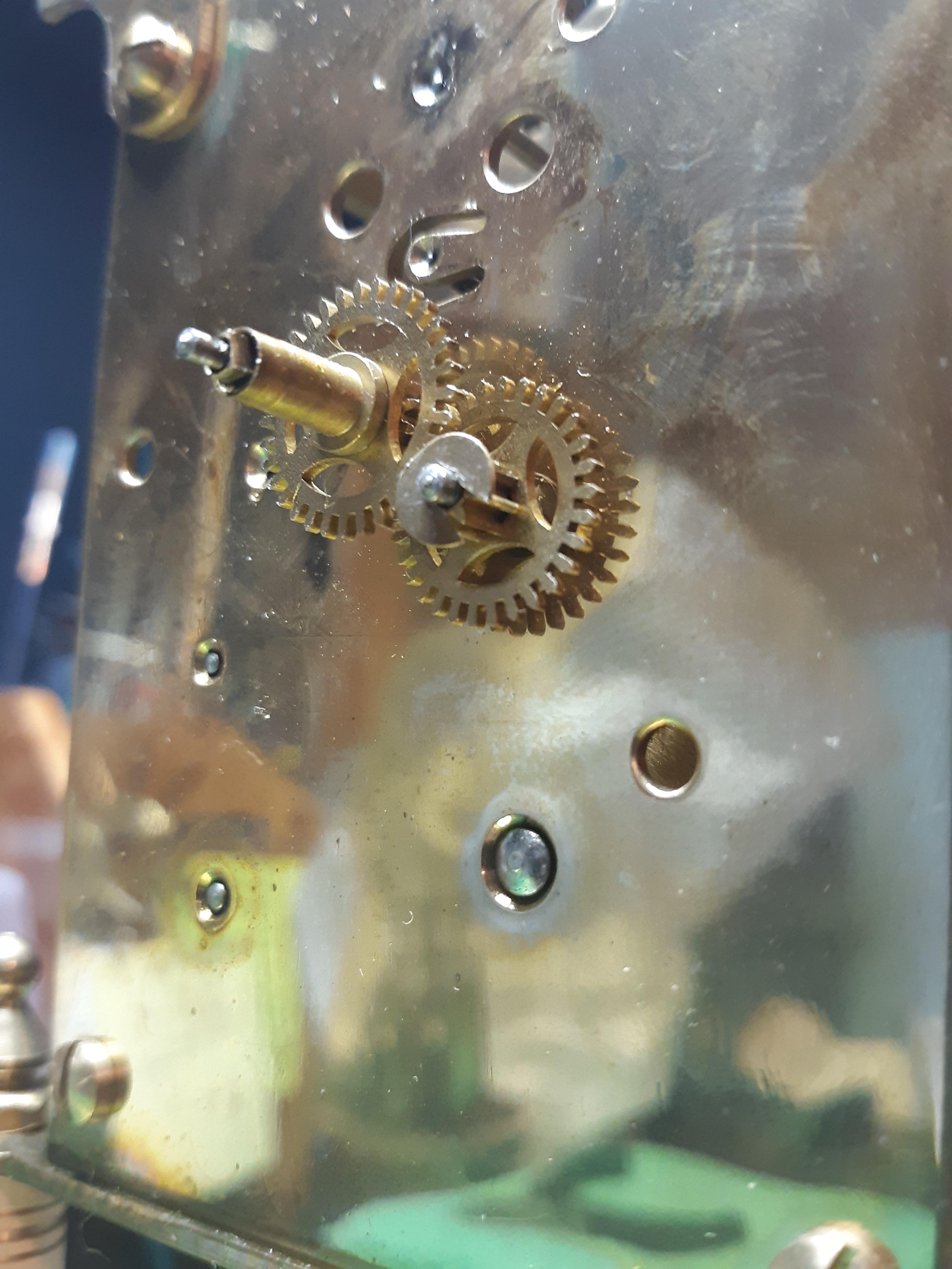

Hi everyone-I've wracked my brain and I need assistance. Pretty simple re-assembly you would think but sure enough, the gods of horology want to play games today so it's not cooperating, and after several attempts and looking all over, the center wheel and 3rd wheel seem to be binding up and the whole thing won't fall into place. What am I missing?  The first series of pics shows the train and where the 3rd n 4th wheel are touching, locking up there. Next is the hour wheel, intermediate wheel, washers, lock washer, hand tension washer and hand lock pin, as they sat when I disassembled.  The last 3 pics are time of disassembly, which I'm attempting to do just in reverse order.  My suspicion lies with the washers or maybe a wayward spacer that pinged that I missed? Or a round peg in a square hole? The 400 day bible gives nothing except a nice parts page. I know I bet it's right in front of me but I need a fresh set of eyes. Thanks people I'll check back in awhile. Happy Sunday.

I think you got the 4th wheel upside down. If you look at the original photo you posted, the wheel should be the other way round.
Agree.

got back from clearing out the latest snow storm and I took some better pics. I don't think I have the center wheel backwards, as the first pic might be deceiving. it can only go in one way because of the hole for the hand tension washer and pin, and the larger pivot hole size, and the long end to accommodate the hour wheel and cannon pinion, shown with red arrows in 1st 2nd and 3rd pics. 4th pic in red and orange shows where the wheels are impinging on each other and 5th pic shows train arrangement with regard to center/4th wheel and 3rd wheel. so yes, Weasol that's where I originally started was off the hand tension pin hole on center/4th wheel and went from there and ran into the wheels upsetting the apple cart. maybe was this clock assembled wrong by a previous repairman and got the washers wrong or a spacer missing unbeknownst to me? I have zero history on this one only that it's a family heirloom and hasn't worked in over 40 years.

post script: the view of the larger pivot, red arrow, is where I suspect a spacer, or the two washers that were directly behind the cannon pinion might go, to provide clearance between the two wheels. but I don't know. anyone want to loan me their 1950 Kundo 400 day clock for a reverse engineering study with me? ??
if you look at your original post, the 3rd photo shows that not all the wheels are clustered against the front plate. One of them is reversed with the wheel against the back plate. As a general rule, the gears are always arranged with the wheel to pinion, wheel to pinion. I think that wheel upside down.
There might be some confusion here. We are not talking about the centre wheel. The going barrel is counted as the 1st wheel or sometimes called the great wheel. So the 4th wheel we are referring to is the one before the centre wheel.

Aha! Ok that might explain it-we were talking about two different things. Counting the barrel. Ok I'll be back at it when I get home later today and let you know. Many thanks Hector.

Bingo! Hector you nailed it! I had gotten so flustered I didn't see it so I went back to the very beginning and looked at the 3rd shot as you said and there it was...well done sir. well done. Thank you very much! if i never get this thing to run again, I'll still be happy I got restored back on track. whew.
