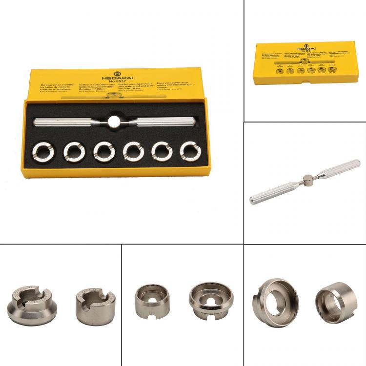

You really need to invest in the proper cup dies for the case back. The two-point "generic" Rolex opener often slips, and damages the case back. That is a great looking case opener, and you'd never get that open using a hand-held 2-point opener.
I have a set of Chinesium ones and they have removed some rather stubborn backs with zero damage.

This is the one I had it would open any Rolex. It will cost you a fortune these days.
If you want to ship this Rolex set to Canada, I would be forever grateful. I'll even pay postage:)
This opener has opened the toughest cases.  Picked it up from a gent who had a friend who was a watchmaker and past away.  I Cleaned a Rolex Tudor in exchange.  I will really need a very good Rolex case opener if I continue cleaning and repairing Rolex watches for those who trust me:)

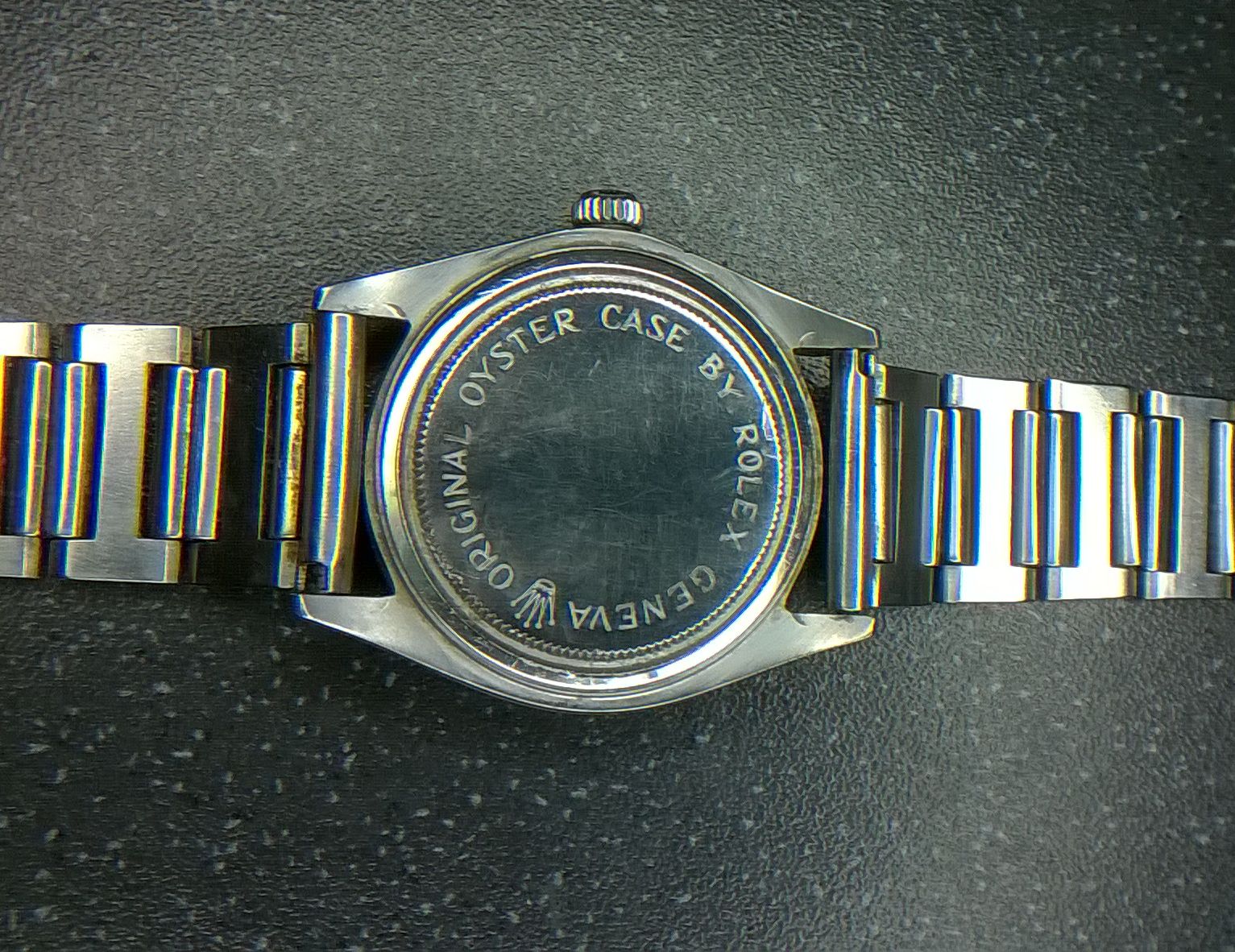

I had the necessity to open this Tudor Rolex Oyster for a friend to regulate it (said friend stupidly declined to get it serviced)....
I used this, worked perfectly ?, and at about £16 for the set, was an absolute bargain!
Wish it was mine.......(still needs a service but keeps better time now......?)
