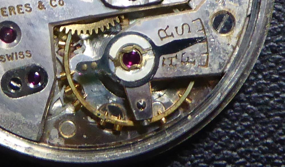

Does someone know what type of movement this is? It can out of a Bovet military watch but I don't think its a Valjoux or a Landeron. I haven't taken the dial off and looked on the other side of the movement.
Thanks in advance for any help that can be provided.

But i see a Incabloc spring. So must be shockproof . Never seen a FHF 70 with center second attachment?

2 minutes ago, wls1971 said:
It does have shock protection:

Sorry yes you are correct. I was looking at the one in the link I posted. Looks like I'm going to have one of those days.
Many variants to fhf70 with different bridge layout were made, namely inderctly driven min hand, then this with center second cock and your regular sweep second with min wheel incorporated inside ebauche.
Its ancestor fhf30 and on, were mostly sub second versions.
Almost every manufacturer put some versions in their watches,  some were in-house and high grades , Rolex did too.

You may need to get a more positive ID for the movement. Ranfft lists the FHF 70 as a sub-seconds movement but yours has a sweep seconds hand. It is definitely part of the same family as the 70, but some parts will differ from the sub-seconds 70.
There is one large problem. The third wheel is missing the pinion and the extra wheel that should drive the second pinion . Not easy to find. I can have a look in my box of old movements . Maybe cousinsuk have it?

I've stripped down this movement and have noted the markings. Can someone please clarify the type of movement based on the photo I provide? Is it a FHF I75 (as is i75) or a l75 (as in L75). I'm also having a little difficulty in figuring out the size for the second hand. I measure the pinion (?) at .30mm (second picture). Does that sound correct?
Thanks
21 hours ago, Poljot said:
FHF 175
Hands
1.40 x 0.70 / 0.21mm
That isn't 100% sure as it's a center second version of this movement. FHF 175 has normally subsecond
This is how the movement should look. Selza-Ltd-FHF-175-17-jewels-sweep-second.jpg.cae4dfb8add6a366d2d02f9a88276ba8.jpg

Just stumbled upon this old thread , must have left the discussion and didn't bother to revisit.
FHF 175 came in two versions, subsecond and sweep second . In subsecond version the minute hand is incorporated with gears of the train under gears bridge, has a long arbour that protrudes through the dial plate for the subsecond hand to mount on.
The sweep second , however, has short arbour on 3rd wheel and sweeps through centre of dial plate.
Google fhf175 to see image of both versions.
