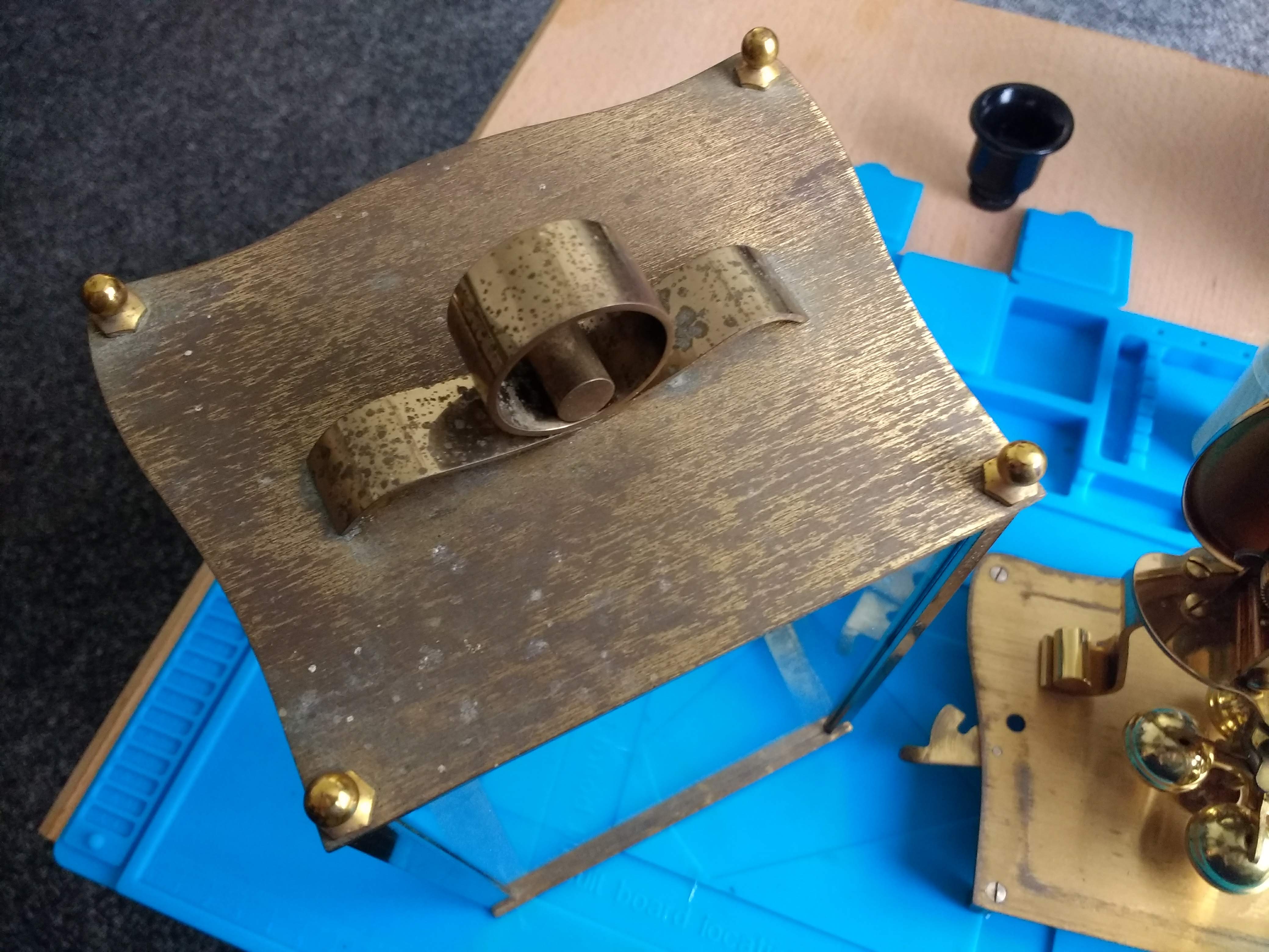

The case might be worth trying to re-guild it using Gold leaf which is not as difficult as one might think. There are many youtube vids showing how. The movement must be serviced and it must be perfect or it will not run. I have serviced many of these so a pic of the movement will be helpful if you encounter any issues.

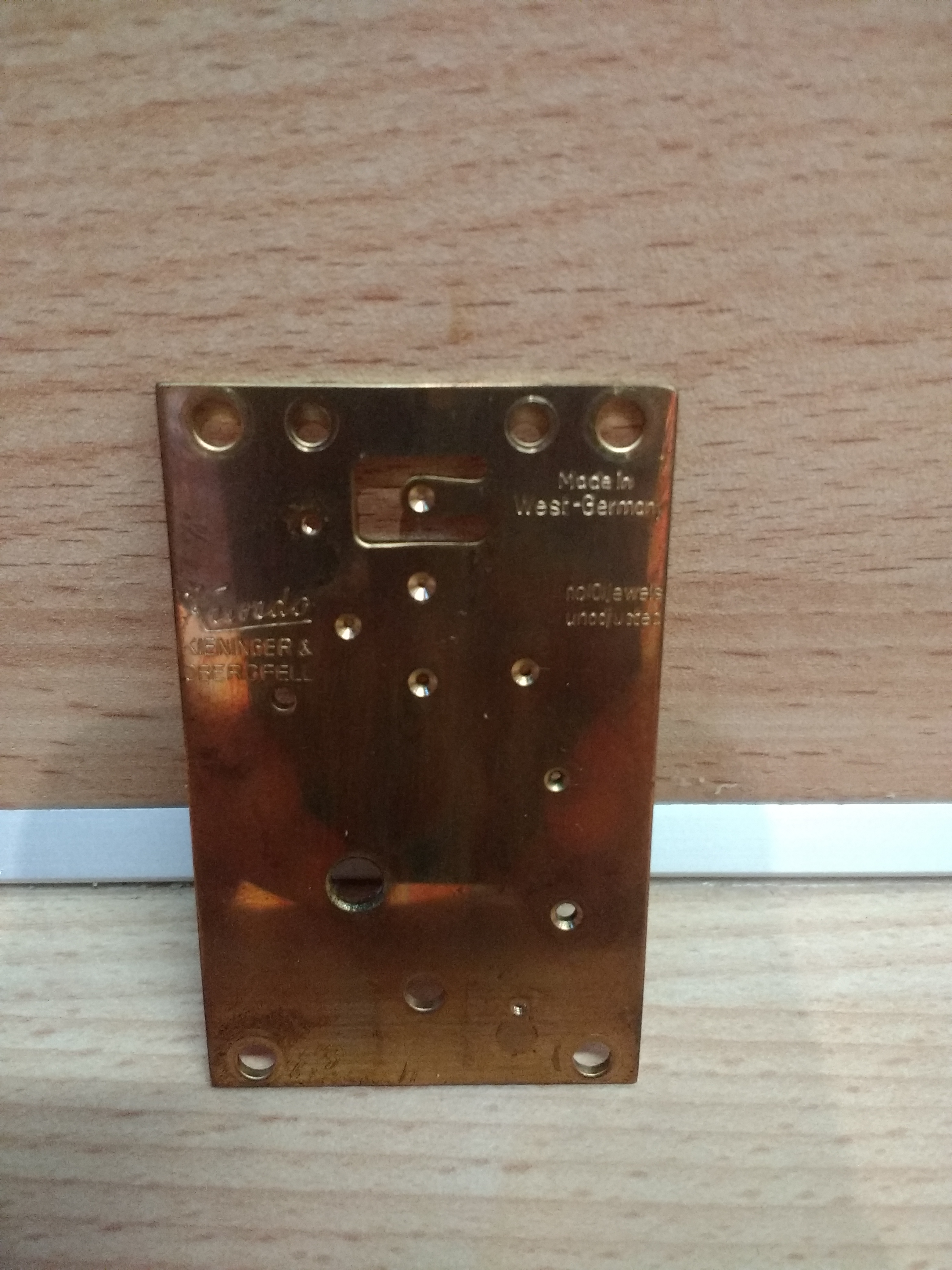

The only way is re-gilding. Gold paint will make it look odd against the movement. We only need a photo of the back plate to id it. Get one of these to help you to set it in beat when it comes to clean and oil the movement. Because of its long handle it gives you better precision to enable you set the clock in beat.
Hi   According to Twilliger's book  Plate 1406H  4 Ball pendulum Miniature clock  Uses a .0023"(.058mm) suspension  which is Unit 5E      Kieninger & Obergfell  alias  Kundo.   When you get you book look at page 132 for the details.  page 179 for the suspension details.
