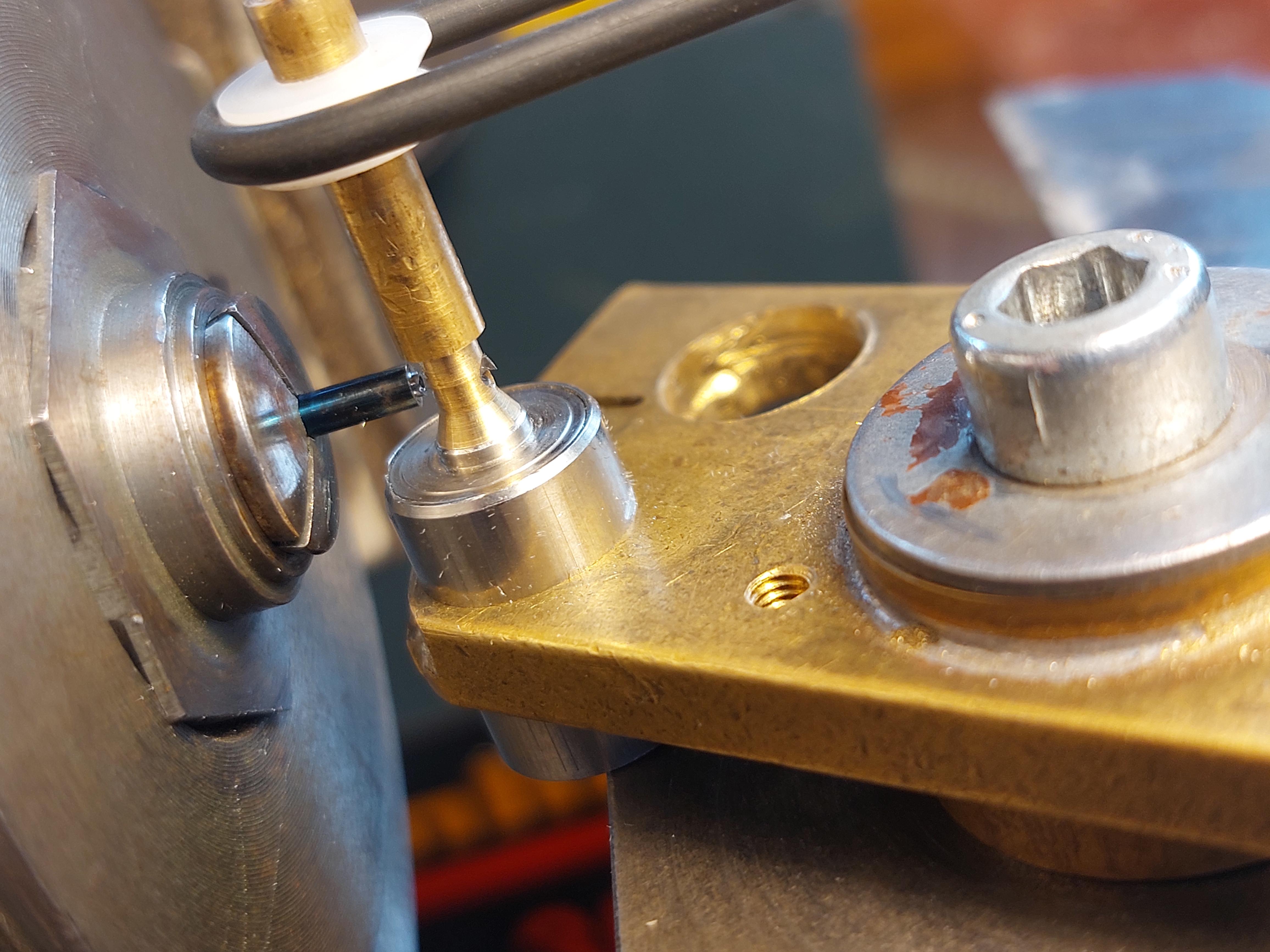

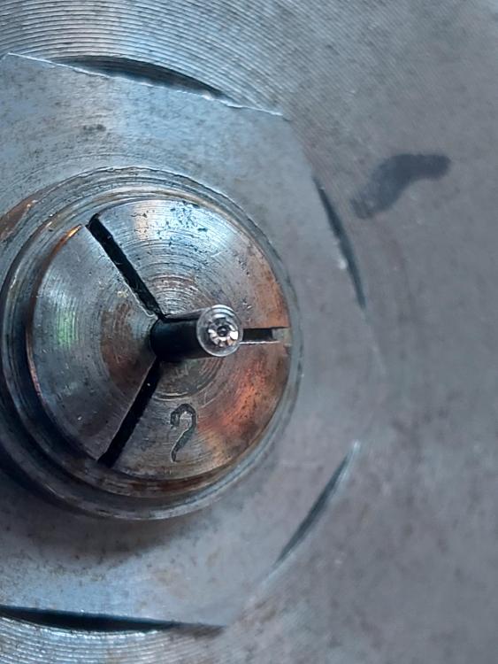

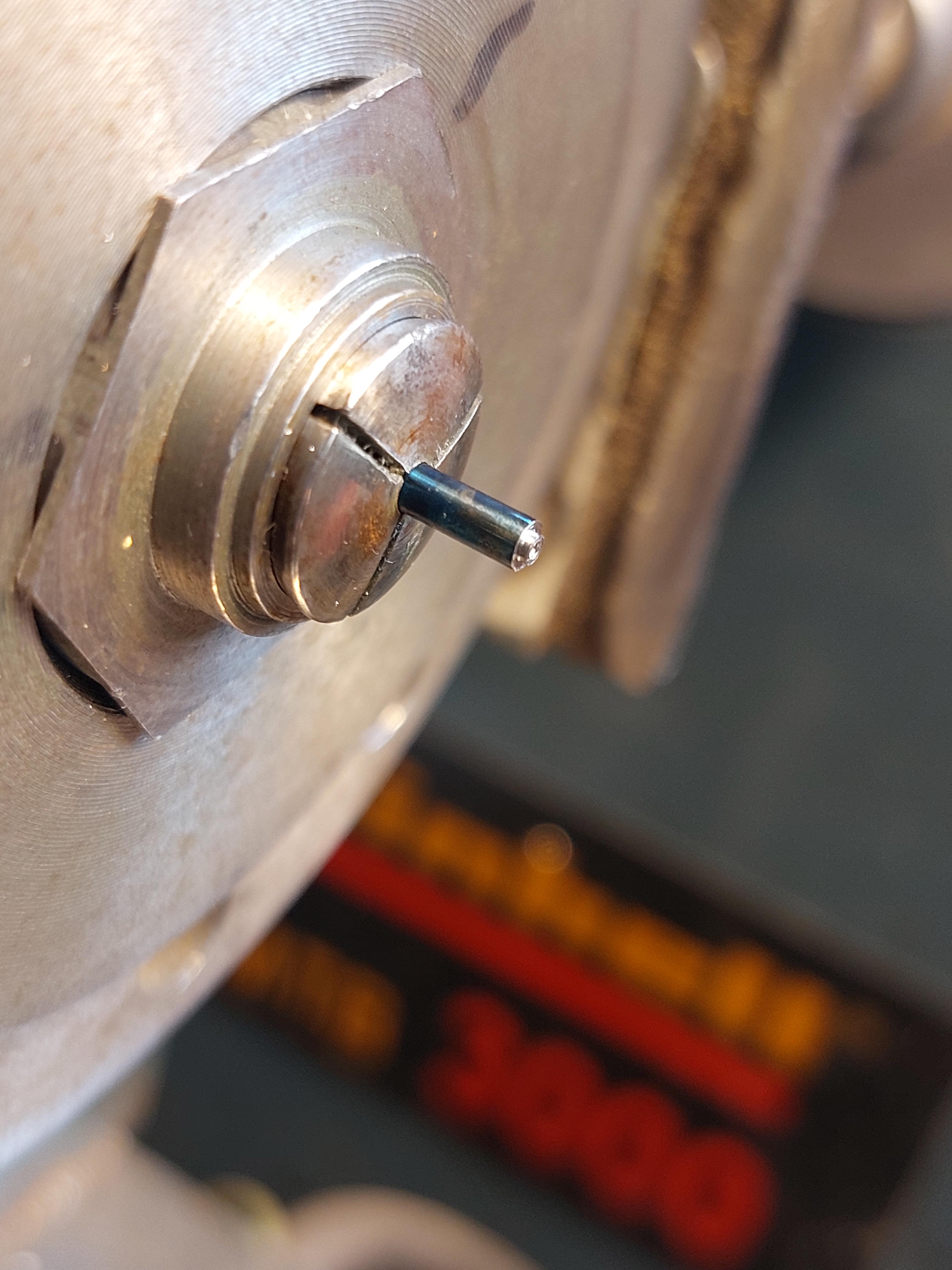

On 4/2/2024 at 8:02 AM, nevenbekriev said:
... For example, now I have an AP movement on my bench that needs to make new winding pinion and one of winding gears for it, this is for a young watchmaker that I am trying to teach and will not want to dissappoint him...
The final result is not perfect looking, but is working well. The wheel is pritty small - the OD is 1.8mm

This is the 3th attempt for this specific pinion. Othervice I have made many for pocket watches, but they are much bigger. This is really small. The pictures does'n t show things correctly, there are blinks that my phone camera can't manage well

This is a flying cutter, usual one. The cutter itself is shown in the pictures in the first message, it is made of broken tungsten carbide drill bit. I asure that all the angles of the cutter are as they should be. I have video - little older one - that I made when onse making the same kind of winding pinion for a Poljot 2200, which is even smaller than this one.
It is not easy to see in the video, but the tool rest moves about 1mm towards the object in Y direction and then returns back untill cutter is rotating. Then the spindle is rotated one tooth ahead and everything repeated untill all teeth are cut.

OH, I don't need help. The pinion works fine and so I am happy with the result. This is just my 'shy' way to bragg with what I have done... And to show that it is possible to make such parts with self made tools and devices in domestic conditions
