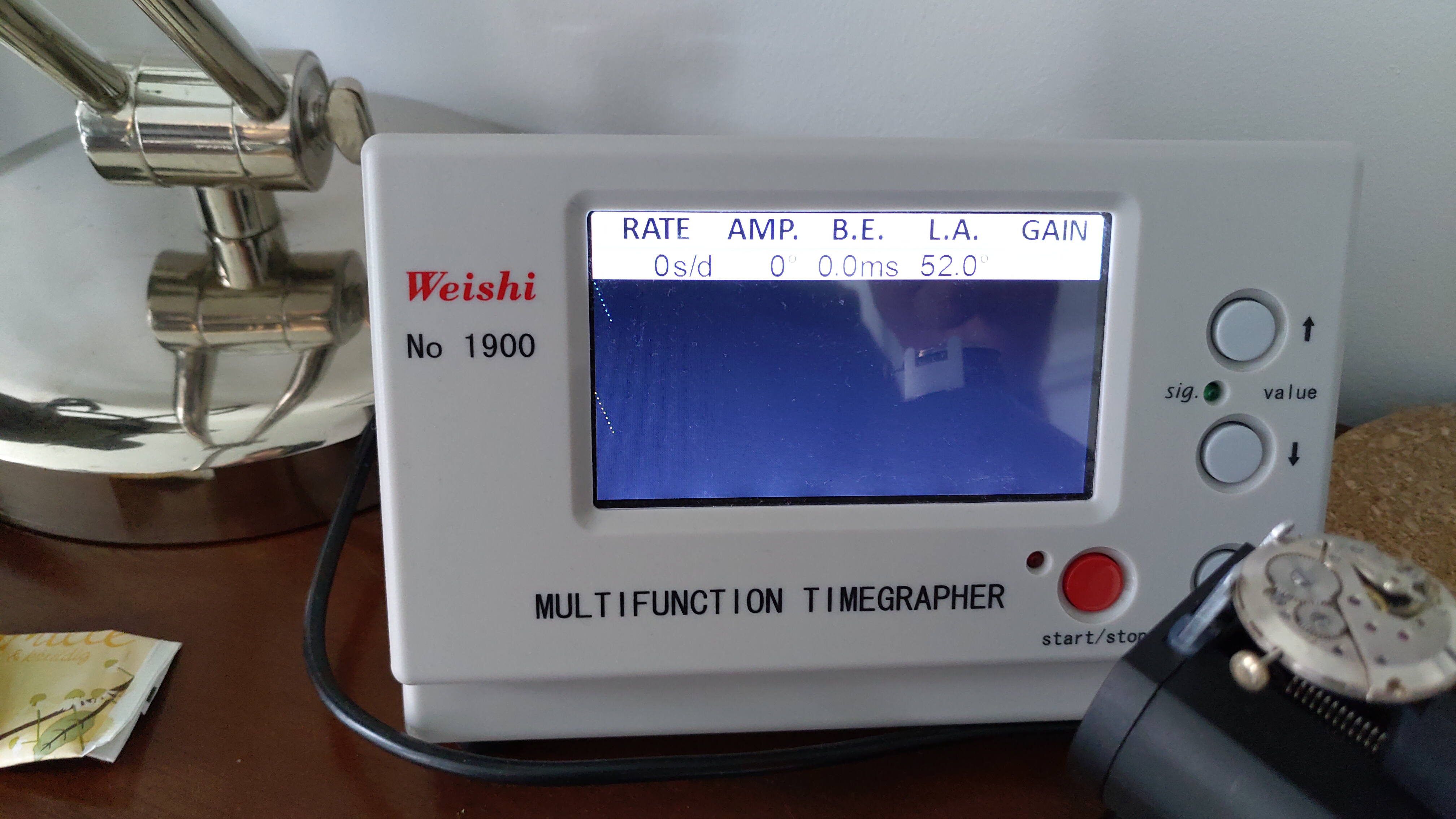

IMG_20200930_214535.thumb.jpg.89d714811b40c5f46f877cd492d8e495.jpgI finished cleaning and reassembling an Eta 900 movement, it got a new mainspring and balance complete, both NOS. The timegrapher shows a number of oddities, as shown in the photo.
- The watch was at perhaps 1/4 wind for the timegrapher photo, at full wind the amplitude was 310-320 which seems too high.
- The beat rate is recognised by the Weishi as 19800, but the movement is listed as 18000.
- The watch runs either really late or slow.
- A clear abnormality in one of the 2 vibrations.
- BE is huge, but that seems the least of the problems for the time being.
After seeing the high amplitude I've removed the grease from the barrel arbor to increase friction. I've cleaned the escape wheel and pallet fork again, and re-checked for abnormalities, can't find any.
Any ideas what might be going on?

Try setting your timing machine to 18000 bph manually, then see what you get on the screen. If you have slo-mo on your phone, use that to check amplitude and frequency.
Thanks for the input so far, I will see what a fixed 18000 bph will show on the timegrapher. I will dive further in the ETA 900 beat rate, see if it is consistently mentioned as 18000. I will check the hairspring, no idea how I would check the vibration frequency of the balance (I just started on this watch repairing journey).
Then just a reminder notice your beat error of 6.9 ms and the graphical display looks pretty decent? Because of the size of the graphical display it will only display up to about 4 ms in that it has a rollover error Which gives impression that you beat looks really nice but the numeric rate is probably correct And the display was much bigger those lines would be really far apart.

I provided a photo of the timegrapher after manually setting the bph to 18000, the display makes more sense in terms of BE, but after 7-8 seconds the graph is reset and the process starts again! I have tested the timegrapher with watch that keeps decent time.

Your timegrapher is unable to capture a trace which quite possibly means that the vibrations are either very far out of range in frequency, or the impulses of the escapement are too weak to distinguish. Either way, the trace is close to useless. What you may be seeing for the brief period of time when it does appear to capture is the effect of aliasing. An example of aliasing is when a video of a helicopter rotor looks as if it is turning very slowly as a result of the capture sample rate which may be 25 or 30 frames per second.

Then a new updated picture of the timing machine where it's showing you nothing  that's because the timing machine is trying to reach out and communicate with you unfortunately it does not have artificial intelligence to do that correctly. The same as your original pictures you need to visually verify that whatever the machine is telling you the watch appears to be doing the same thing.. So if the amplitude looks like it's super superhigh visually it should look like at superhigh. Occasionally it's more common problem with Chinese machines  but  it will happen to all timing machines if the amplitude is super low for instance it won't numerically look to be super high. This is where  missing features  from the Chinese machine would be helpful if we had such as the oscilloscope where you can look at the waveform  and see where the timing machine is attempting to  pick up the signal. Because oftentimes you'll find is looking at the wrong part of the waveform so if your timing machine says you're doing 300° that balance wheel better look like it's doing 300° otherwise you have a problem..
So the basics would be  let the power off get us some photographs..  Visually verify the watches in beat. Look carefully at the hairspring if necessary look at another watch or look at several watches as I said it is really really hard to tell if they hairspring is flat and where it's supposed to Be.
