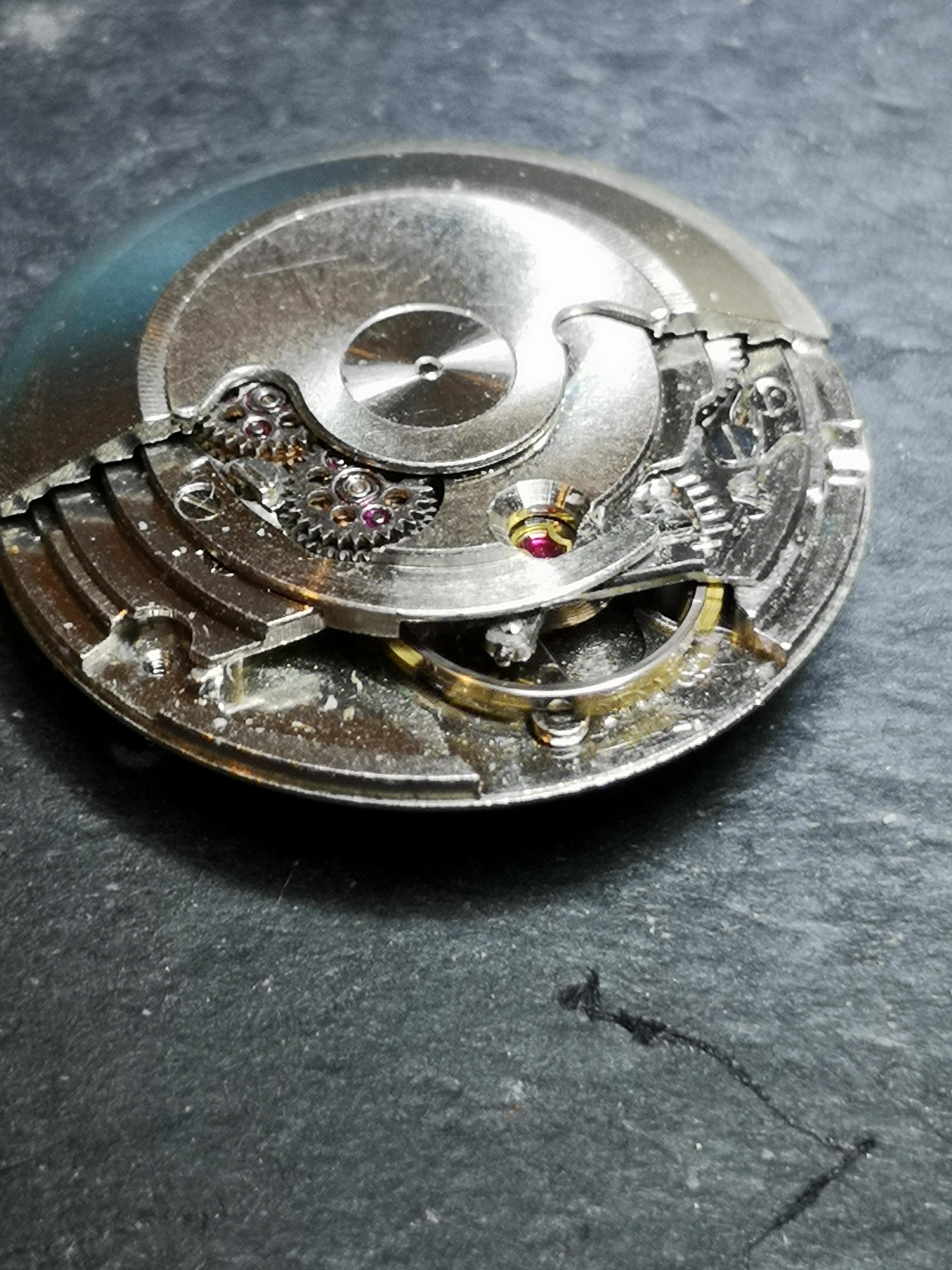

Hi its a long shot but worth a go.
This is a 23 jewel automatic omer watch from around the 50s 60s it has a ETA movement that begins 24 -- I know i should dismantle it to check it clearly but it has been knocked and is indistinctive.. Its just the winding stem i need damn thing snapped on me .
Last number may be 9 but its really not clear any more.
Anyoner with a idea what it may be give us a shout.
cheers
gary
Well, it’s a no date, so that narrows it down.
24xx family should all use the same stem.
2483 maybe?
2784 is the date movement in my 9411s. 2783 was the no date variant I think.
last digit goes up with complications.
no date; date; day-date
i don’t have my files here at home or I’d look it up in the old data sheets.
efit- I forgot sometimes beat rate varied on the older movements. But I don’t think that would effect the stem.

Hmm..  Think you have to take off the winding mechanism and the balance bridge to be completely sure,
since it has a pin and not a screw on the oscillating weight it is a 24XX. It has no date and looks like a pure dial side so probably an
ETA 2459.
When confirming the exact caliber if it actually says ETA 2459 you can look for any of these stems and they will probably fit since they should be the same.
ETA 2390
ETA 2391
ETA 2451
ETA 2452
ETA 2459
ETA 2472
ETA 2474
