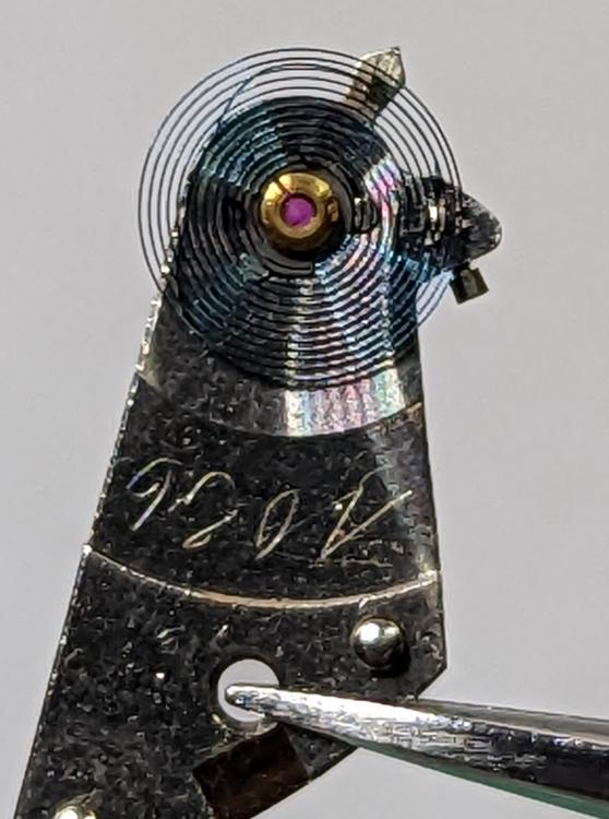

Dear all,
I just wanted to follow up on this post, even though it has been a long, long time.  I needed to take some time off from the hobby for health reasons, but I recently got back into it and had a bit of practice shaping hairsprings, and found the confidence to take this one on.
This was a wide ranging discussion, but I think the main conclusion in the end is that the hairspring needed to be reshaped.  There were two main bends that I noticed, one (1) at 90 from the collet, which reduced the spacing in the coils, making them non-concentric, and another (2), which occured right before the overcoil.  The latter bend seemed especially problematic since it actually could cause contact between the last two coils.  Here is a photo of the spring in the state I found it:
I corrected those using the technique described in Mark's youtube video, and this was what I obtained:
You may notice that the outer coil is still not perfectly concentric (more on that later).  I also installed the hairspring on the balance cock (without the balance wheel) to verify that the collet aligned with the top balance jewel:
After reinstalling the balance complete I checked the balance wheel (without pallets) for free motion, and found it still demonstrated the behavior of coming to an abrupt stop, i.e. the original problem was not improved the adjustment to the hairspring shape.
I reasoned that this behavior could only be explained by some additional source of friction, and I finally managed to see that the hairspring, when viewed from the side was not parallel with the plane of the balance wheel and in fact was making contact with one of the balance "spokes" at about 180 degrees from the stud.  Therefore, I decided to make another adjustment was necessary to bring the hairspring level and remove this point of contact.
I decided to make the final adjustment at the stud.  I.e., I would "twist" (as opposed to "bend"; see the distinction here) the hairspring so that the stud would be perpendicular to the plane of the hairspring.  This is the natural orientation of the stud, since it will be forced into this position when installed into the balance cock.  If it is not vertical when not installed, then installing it will create a torque on the balance spring that will tilt the entire plane of the spring -- that is the precise problem I was facing, I reasoned.  Here is a (bad) photo of how the stud looked on the hairspring before adjustment.
The photo doesn't make it so clear, but the stud is not exactly perpendicular and needed to be adjusted slightly in the direction of the arrow.  Well I made this adjustment and reinstalled the balance complete and the movement finally moved freely.
So now the movement finally runs, although the amplitude is a bit low (180-200) and its running way too fast (+200 s/day).  The hairspring does not appear magnetized to me (coils not sticking together), but I demagnetized the whole thing anyway, and the timing got a bit worse.  I'm not so great with the demagnetizer yet, but I managed to get it back.
Anyway, I can only guess that the hairspring is still not in perfect form, bringing me back to the subject of whether I actually made the coils sufficiently concentric.  What do you guys think?  Should I expect this kind of speedup from slightly non-concentric coils?

Greetings everyone, and especially Breguet hairspring experts!
I've been pondering this for some days, and after carefully studying the motion of the balance, I'm fairly convinced that there is nothing touching the hairspring, other than what should, e.g. the regulator pins.  The hairspring is clean, level and concentric, not bunching up in any places, not coming close to touching any part of the balance, etc.  Nevertheless, it runs very fast +240 s/day.
I wonder if the issue is something special, related to the fact that it has a Breguet overcoil.  It occured to me that there is a straight section and round sections, and these might not contribute equally to the spring's effective length (and timing).
I studied all the photographs I could find of 30T2 hairsprings.  Here is a typical example, from a NOS part for sale on ebay ($350, btw, prices have really shot up recently!):
compared with mine:
The difference that catches my attention is how the straight section of the NOS hairspring seems shorter and more clearly delineated from the curved portions.  It goes across closely to the collet, and the terminal curve follows the 5th-6th inner coils, whereas mine follows number 2 and 3.
Might this shape result in a significantly greater total length of coil (curved portion)?  If so, could this explain why mine is running so fast, since the overcoil is "eating up" coil length, therefore shortening the effective length?
Now I am just speculating, so perhaps I should read more about how Breguet coils work -- any suggested reading?

here three pages in the discussion I refuse to reread the whole thing. So I see two pictures two different hairsprings are they yours?
You should be able to look at the hairspring on the balance wheel in the watch is the hairspring centered are the regulator pins where there supposed to be if so wherever the over coil is is where it's supposed to be.
For instance if you look at the hairspring on top notice how the last part of the over coil is in considerably farther than the other one so far so in that the regulator pins wins even fit that so they hairsprings are so dramatically different you wouldn't build just swap them
then as a reminder if you have a swapped your hairspring because in over coil hairspring they were replacement components you do have to match the balance wheel to new hairspring because they still have to be matched.
also look really carefully at your balance arms if they had been squeezed the least little bit and are in just a little bit that would be why you're running fast.

Hi John, yeah I should probably make a new thread since we've discussed so much.  But most of it is not relevant to the current issue.
The first picture is not mine.  It is just a photo I found online of a NOS part for sale on ebay.  The second photo is mine.
the hairspring is centered (collet over jewel when installed onto balance cock without balance wheel).  The position of the overcoil relative to the regulator pins is something I'm actually not so sure about.  One thing that is clear is that the overcoil is not centered between the regulator pins, but is resting against one.
