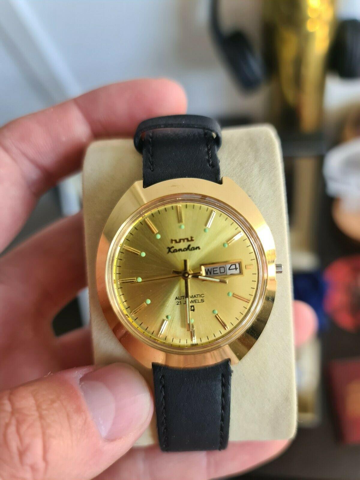

3 hours ago, spectre6000 said:
The issue with the Indian watches is always that they've taken serious abuse, then got a spit polish, and are sold as freshly serviced or something. That one looks close to new. Score!
HMT is an Indian company that seems to sell budget watches primarily to the Indian market.  I guess that Citizen makes (or just designs) some of their movements.  I don't think this is the usual "Mombai Special" that one would get from India.  It is shipping from California, not India, but that doesn't mean much.
This one does look to be in good condition, with little wear.  It has a 17 jewel movement that should be pretty easy to service.  Hopefully, a good score.  It is said to be in "working condition", so that's a plus.
Edited by gpraceman
HMT watches were made entirely in India. The movements were produced under license from Citizen Japan and the one you have is an HMT 02X movement, a licensed copy of the Citizen 0201 series of movements.
Parts movements are easy to come by, and they also seem to be interchangeable with their Citizen equivalents.

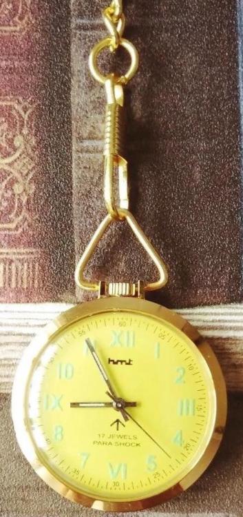

HMT 6906 Automatic, "as purchased" and  in need of some TLC including a stem and crown.
HMT also produced a number of automatic watches based on the HMT 6906 which is a licensed copy of the Citizen 650x series.
By and large, original condition watches are well made, but due to the large numbers produced, there are quite a number of bodged together bitsa-this and bitsa-that watches with weird "reconditioned" outlandish dials, which are the so called "Mumbai specials", some of which are quite amusing. Others are frighteningly badly put together, and at least one of the ones I encountered had half a sack of potatoes worth of dirt in it, despite being described by the seller as "recently serviced".
Interesting watches, with an easily serviced movement, with a relatively large balance. The movements are almost indestructible, and, if serviced and cleaned correctly they can perform very well.
I've included a couple of the "several" that I have collected over the years. I have a bit of a soft spot for them.
