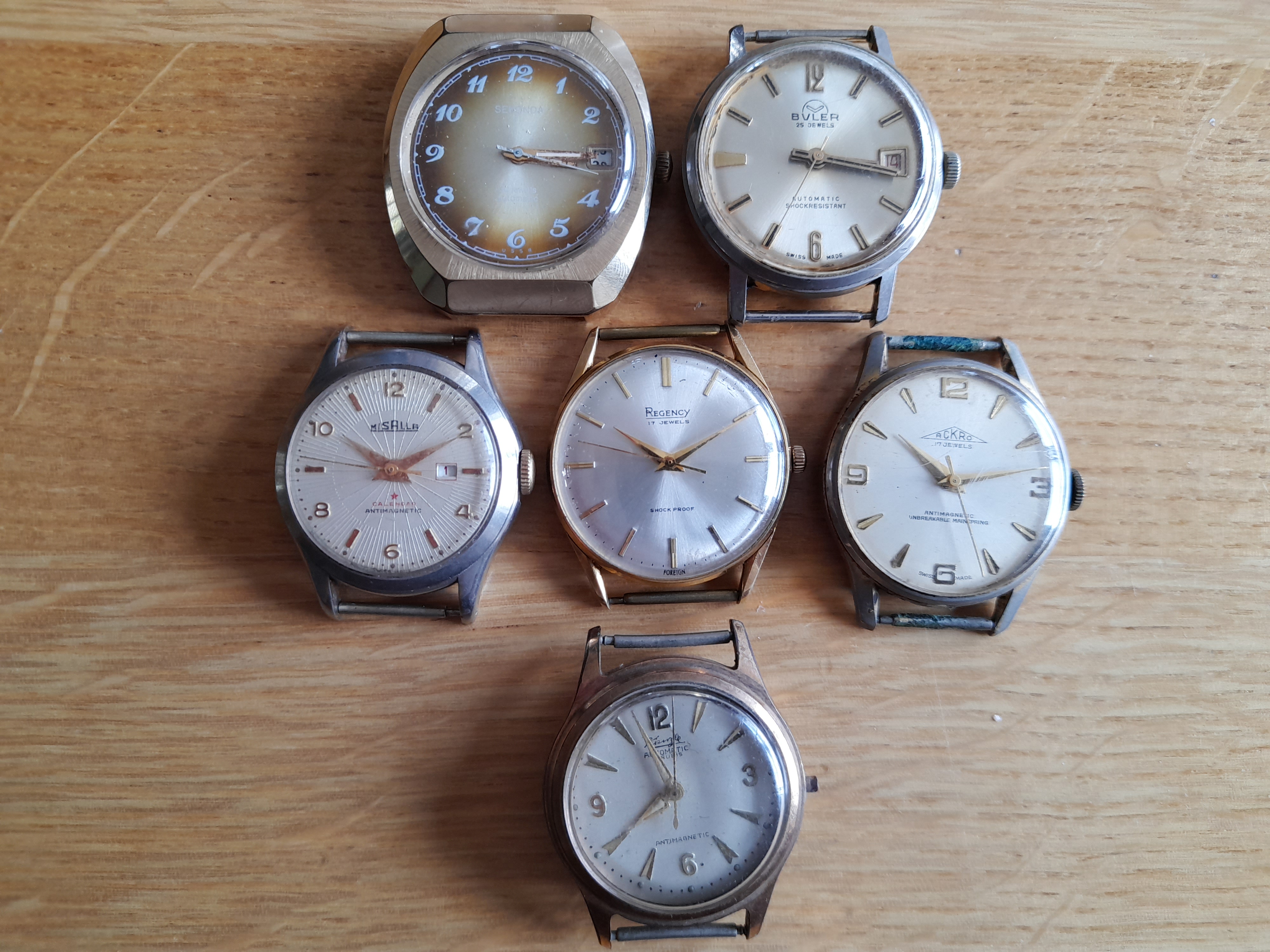

I love playing the £4.04 game or as getting as near as possible. I didn't expect such a thing to be so controversial. It's certainly becoming more of a challenge especially on that well known auction site.
Anyway here's my latest haul no one else bid on a total of £3.96 each. More willing victims for me to practice on.

Controversial? I really don't know what you are referring to!😀. Nice haul and not an Omega in sight.

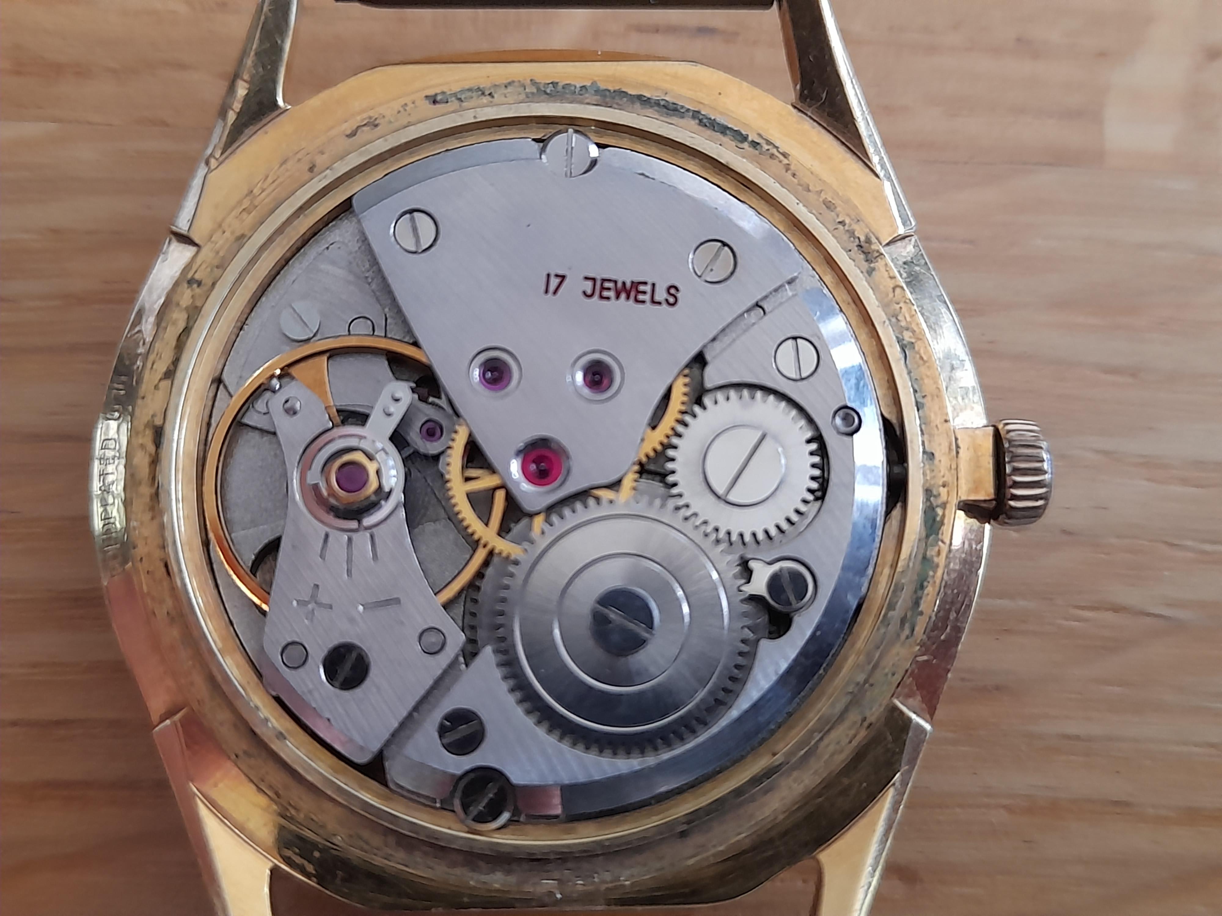

Very nice. I have a similar Kienzle Automatic, which strangely enough also arrived without a stem and crown. I did find something to fit, in my big box of random stems, but as I recall it took me ages go through them all.
I'd be interested to know which Kienzle mechanism is in it, and also what is in the Regency. My guess for the latter is that it may be a Chinese standard movement, however anything stamped "Foreign" from the post war period, through to the 1970s, also has a high chance of being German.
I'm going to revise my guess about the "Regency". I suspect it has a Citizen 0200, 0201, 0241, 0260 or 0270 movement in it similar to this. RIMG0482.thumb.JPG.edfd38f49d03a7d7f5e463945e7d2bcf.JPG
If so, it should be relatively simple to service, and if you need any parts, then you can probably pick up an HMT 0231 or similar for pennies to fix it with as this is another licensed copy of the same movement.

Curiosity got the better of me and I popped the back off the Regency. It looks very similar to the Citizen and HMT. I think after a clean I'll be able to get this one running. There seems to be a sign of in the balance.
So is it a Citizen movement or one a version thereof produced under licence by someone else?
The Keinzle is sadly missing a few bits, a bit like yours. Its a shame really as its got a really nice case back a bit like a bubble. I think it's one for another day,  may get lucky in the future I find another with the necessary parts. More 404 fun.
Yes, it certainly appears to be. The balance bridge and the parashock protection gives it away.
There are some variations in the barrel bridge and the main bridge (although the different variants I've encountered seem to be interchangeable), but the balance and the shock protection is the big clue that it is a Citizen, or a licensed copy of one.
Are there any numbers stamped on the main plate, in the area near the balance?
The Bolova - Citizen copies of the 0241 have 11DP  stamped there, and the HMTs typically have 1802 or 0231 on them.
None the less these mechanisms are almost completely identical, with the only noticeable variations being in the finish, and the bridge shapes.
Some of the HMTs are actually finished to as high a standard as the Citizens, but some are slightly more basic.
