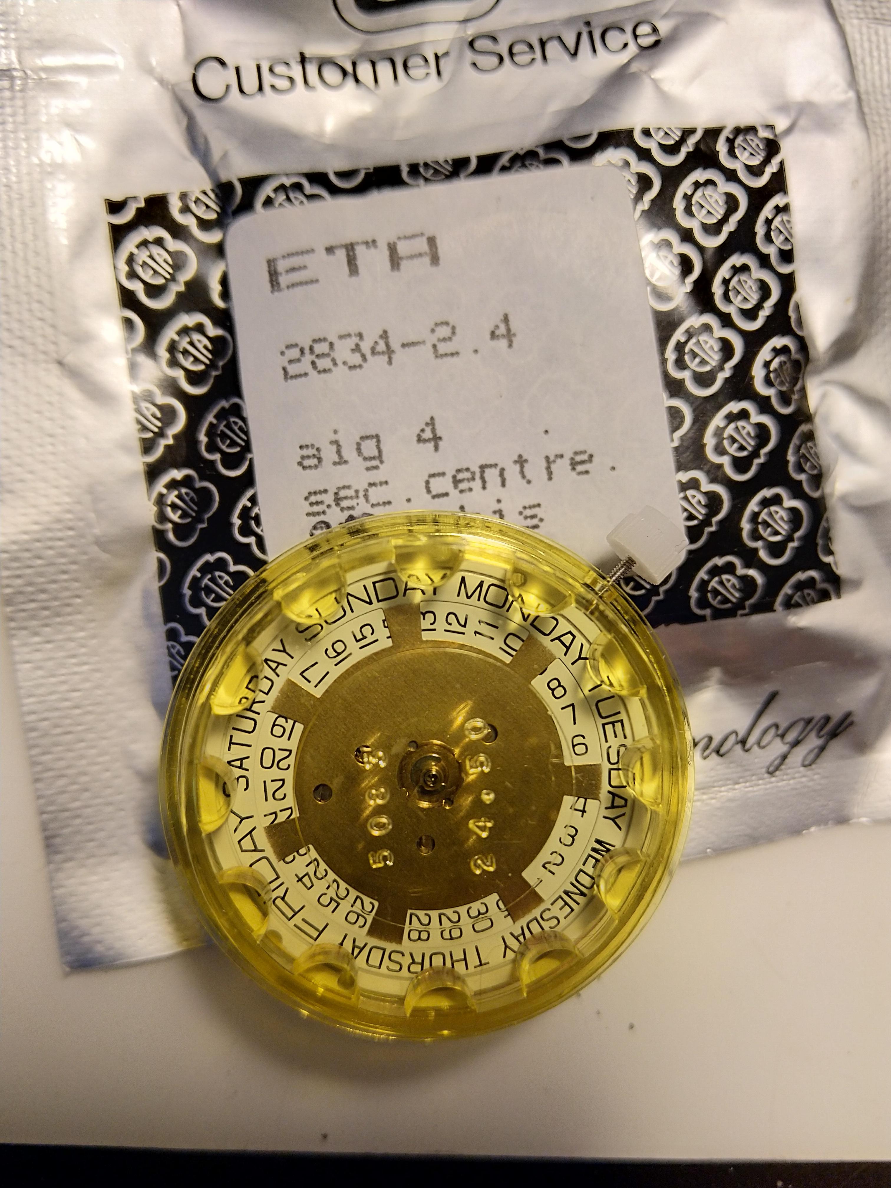

The ETA 2834-2 is a quite straight forward robust based on the 2824-2 movement.
To pinpoint the issue you first got have to have a little understanding of the basics of the keyless work.
I got the movement ready so lets go..
First, the crown wheel. It's not too hard to see if the crown wheel is worn down it is quite exposed.
The crown wheel is driven by the winding pinion, you can see the gears interact here.
Since I don't want to stripp this movement down, I have prepared with an appropiate victim, just like the TV chefs.
Here you see the parts involved with the winding of the watch and setting of day and date,
We got the sliding pinion, this is what is pushed forward to set the day and date, when pushed forward the winding pinion get released.
The yoke is pushing the sliding pinion forward when it is affected by the setting lever.
As you said the date and day is ok so the yoke must be in place.
To wind the watch the setting lever must push against the winding pinion. Both these have angled gears where they interact which makes the winding possible when turning one way but makes the gears not grip when turned in the other.
So one of the culprits here could be worn gears on the sliding and winding pinion,
On a "normal" older movement you would have a yoke spring but on these movements that is integrated on the setting lever jumper.
Sometimes the spring gets dissengaged from the yoke at the point the arrow is which makes the winding waked.
If everything is okay that spring is what pushes the sliding pinion against the winding pinion.
So the second fault could be here.
The third and last fault could be lack of lubricant, dirt on the winding stem or it is damaged.
But I think a watchrepairer checking these simple things would make a wonder on your watch.
