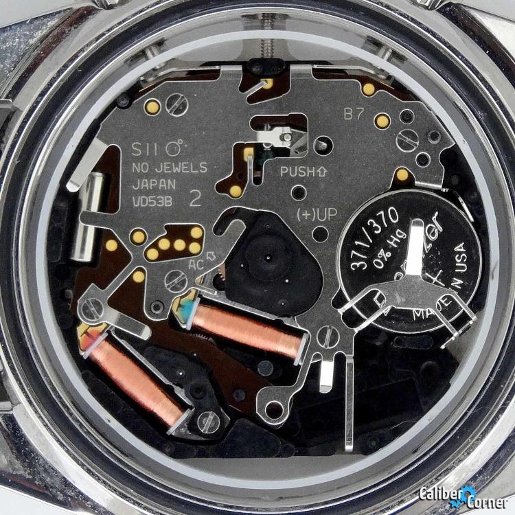

I have an MK watch that the hands won’t turn when the battery is in or when I spin the shaft for adjustment. Not sure why. Nothing appears to be broken and when the battery is in the chrono (stop watch style second hand) still ticks.

Hard to say..but the watch probably  has suffered an electronic  or mechanical failure of some type. What watchweasol has alluded to is,is the whole mechanical  workings  of the watch exclusive  of the dial,hands and case. Sometimes  referred  to as a caliber or a movement.  In this case a vd53a movement  manufactured  by a seiko company  ,can be purchased for not alot of money.   You would  save yourself  alot of grief by getting  one and swapping  it out.
I might be wrong. But looking at your 1st 2 photos, the orientation of the winding pinion might be wrong. The teeth should be facing the setting wheel so that they would mesh when the stem was pulled into setting position. You should check the teeth on the setting wheel also. Sometimes the teeth on 1 side is bevelled and does not mesh properly with the winding pinion. If that is so, try turning the setting wheel over.

Yankeedog is suggesting that you replace the entire movement inside your watch, as you mentioned than the hands don't spin when the battery is in. This suggests that there might be a problem with the electronics or mechanism.
A new movement is quite affordable (around £13). Rather than attempting to fit all the pinions back into the train bridge. I would say assembling the gear train of a quartz watch can be more frustrating than a mechanical watch. Then chance of damaging the pinion of the plastic motor rotor and 2nd wheel is very high.
So, heed yankeedog's advice and replace the entire movement.

Absolutely mate, buy another movement complete and swap the dial and hands over, trust me it’s so much easier than getting the train back in it’s relevant place, that motor acts on a magnet and will not sit upright in-line with the top plate pivot hole and can be an absolute sod to get in.

So, looking at the diagram I was given, what parts would I need to order?
I just don’t get how the shaft that spins the hands came out but won’t stay in now? And when pulled out slightly it will spin the dates but not the hands themselves.
