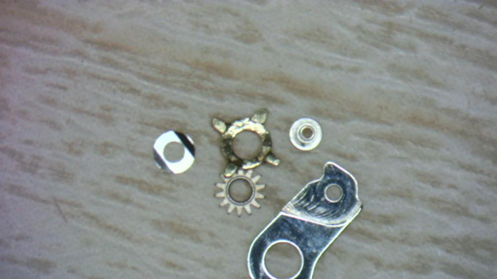

I bought a Seiko LordMatic cal 5606A and noticed the quick change day-date wasn't working.
A bit of Googling found out that they rarely do on these movements, due to the plastic wheel on the day-date corrector wheel rocker breaking (see pic).
As it's such a common problem, I thought I was lucky to find a NOS one on ebay.
Unfortunately the plastic wheel on that was already broken - I've since read that this is common on NOS items, the plastic ages and breaks.
The one I have at the moment is spare time, so I found a bit of brass from an old pocket watch, got my finest file (#6), drilled a 1 mm hole,  and started filing ...
It took a while ....
But got something close :
I think it's OK as a first effort at making a part.
It's not perfect, far from it, but doesn't need to be as it only needs to push the day-date wheels over.
What I found was :
 I couldn't have done it without my stereo microscope
Although a #6 file seems very fine, it's way too course to finish the part. I believe you can get #8 and #10 cuts.
I sharpened the end of an old screwdriver to use like a chisel. I finished with some 3000 grit paper, but it's not easy to fix a small enough piece to use.
I haven't stripped the movement yet, so don't know if the part works - can't see why it shouldn't

I made one, thanks to finding Mike’s post (thanks Mike!).
I made it from 0.3mm brass (an old dial) doing exactly as Mike did above, only I carved it out with X-acto knives instead of files. It went very quickly as brass carves like wood at that scale, but I couldn’t have done it without my stereo scope.
Mine would not engage the day disk, so I carefully bent the teeth up slightly under the scope while clamping the gear in a set of flat needle nose pliers so it would not deform.
The carving, including test fitting and  finishing touches, took about an hour. The teeth engage both day and date portions correctly and the star wheel slips properly when resistance is met. Very easy job. 😉
Edited by PinLeverPete
I used a slightly thicker piece of brass as I noticed the teeth where higher than the central circular part - hence you needing to bend them up. It wasn't easy reducing the depth of the central circular part. I used an old screwdriver as a scraper.
Initially I made the teeth too wide, which caused jamming, but once filed down worked fine.
I found marking the part out difficult - all tools seem so big and clumsy on that scale.

After seeing this I was inspired to make myself a 5606 star wheel. Made from 0.7mm brass plate, sanded down to 0.5mm with 600 grit paper as last step. Marked out with a sharp sewing needle in a pin vice. Shaped with a Dremel cut off type abrasive disc (was approx 0.8mm thick). Hole was 1mm and then carefully broached to be a friction fit on the gear wheel. After getting the flat shape correct I transferred the star to a cocktail stick and then brought the abrasive disc down vertically inside of the 4 corners (to make the raised teeth and lower central part). Finished the central lower part using a sharpened screwdriver as a chisel. Finished with fine abrasive paper 2000 grit. Took me three attempts to get something I was happy with (lost one when the Dremel spun it off the cocktail stick never to be seen again). Star wheel works really well.

Original is 2.5mm across the diagonal, 1.8mm square, although mine did end up a touch bigger, 2.7mm diagonal. Any bigger than that and it will bind and not rotate.

How do you separate the axle from the bridge?
I used a punch in the staking set and it just pushes out.
That is what I now did this evening!
