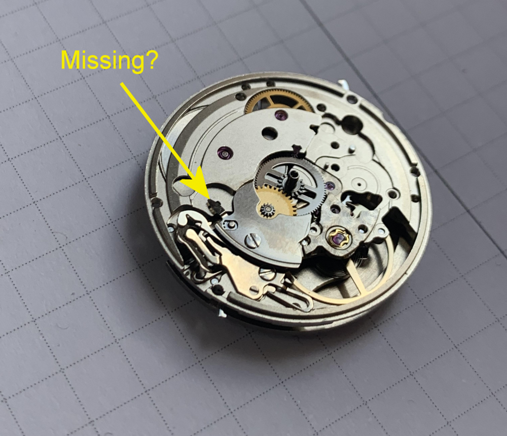

see the pictures attached below - I’ve circled what I think I need to undo. Is this spring loaded?
It seems your keyless work has been misaligned, this isn´t a big thing to fix but it seems you are missing the date corrector wheel to.
Even if this movement is a Sellita SW200-1 you should be able to put it together with the 2824-2 manual previously provided.
Some time ago I made some PDF:s which are on this site too on how to take a 2824-2 apart and put it together again, take a look in those and you will be fine.. 2005095137_MissingPart.thumb.png.0a997822398c9331fd970024019c2c7b.png
