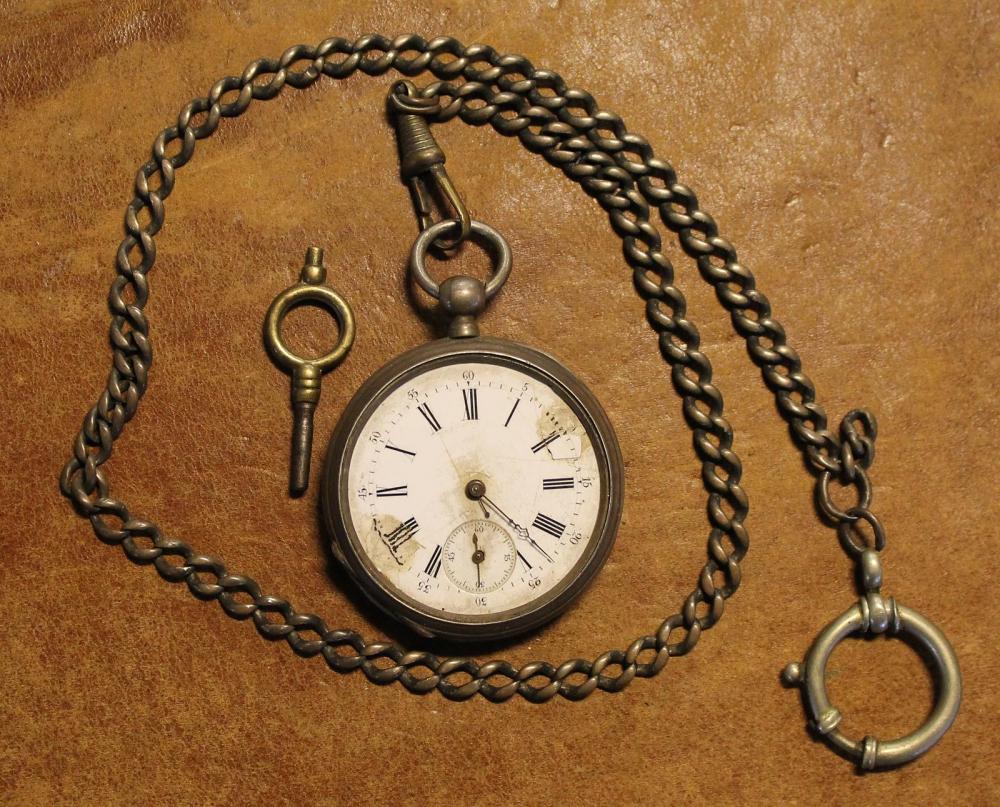

Today I was handed a key wound pocket watch, or rather what was left of this none-runner, with the question if I could fix it up again ..... :huh:
It's a cylinder movement, damaged porcelain dial with both feet intact, has a partial hour hand, a replacement seconds-hand , no crystal and a silver case. Two watchmaker marks in the back lid; Megol '84 and 15/8/'66. Looking at the state of the watch, I don't think the Megol '84 was 1984, but more likely 1884 (?).

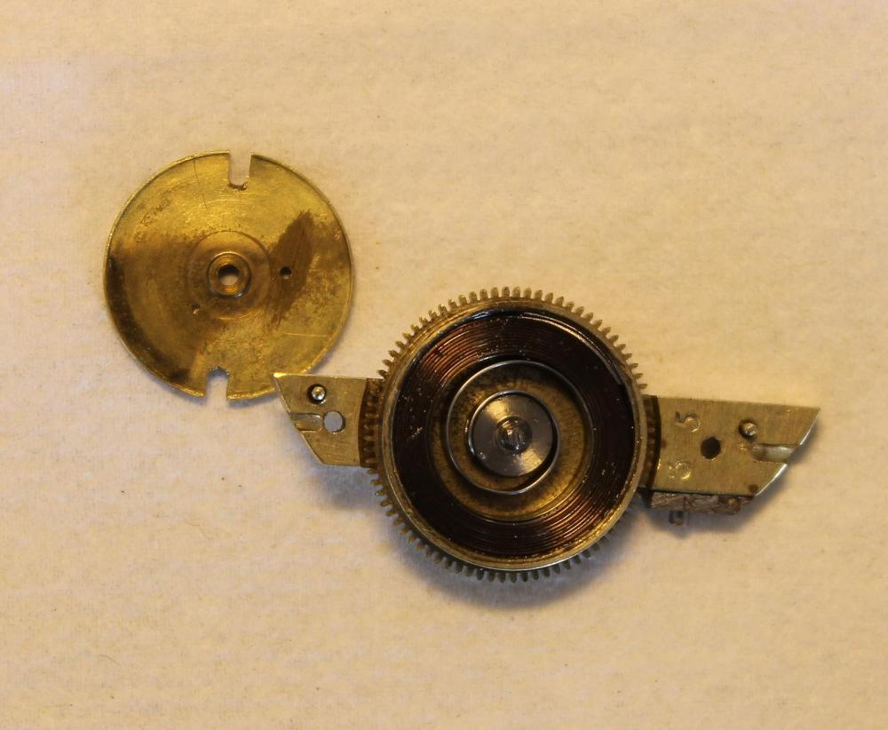

Currently I'm trying to open the spring barrel, but encountered a system which I haven't seen before and don't know how to open the barrel ? :mellow:
The arbor seems to go through the bridge and is connected to a ratchet; both ratchet and arbor seem to be one piece ?? How do I open the barrel and remove the spring ?

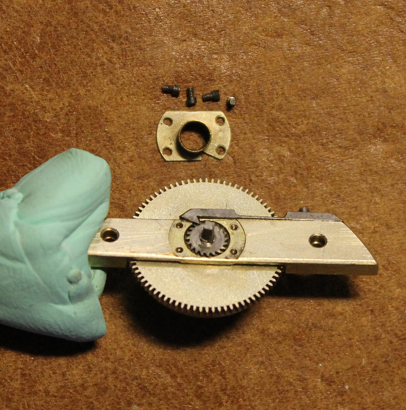

Top-view of the barrel-bridge with ratchet, click and winding pinion;
Side view;
Bottom of the spring barrel & bridge;

Hi From memory I think the ratchet wheel is a friction fit on the square and will tap through with a brass or plastic hammer... Setting the spring onto the cylinder there is usually a pip on the balance rim for alignment purposes same as the platform escapement version,  I shall need to read up on that procedure.  It looks a nice old piece and should come up quite well when polished.
This is a suspended barrel, held only by the bridge. What looks like a screw slot on the lower end of the arbor is what's left of the hole that took a pin to hold the stopworks finger in place.
The lid snaps of, pry in one of the openings. The hook is screwed onto the arbor, it will have two holes to take a spanner. Hold the square, and unscrew the hook. As the adjustable pin spanners are hard to come by, you can grasp the hook with flat pliers lined with paper tape or wrap paper (or copper even better) around the hook.
Sometimes they will unscrew just with stout nickel or brass tweezers grabbing the hook; at least in wristwatches.

This is what as known a 5 bar p/w movement about 1880. With the barrel cap removed the arbor should unscrew from its center part. Some can be very tight so be careful when under taking this, some refuse to move and you might have to clean it in your machine partly dismantled.

Thank you all for your suggestions and help :thumbsu:
The barrel-lid was indeed a "snap-on" and it was "snapped-on" well :biggrin:
The arbor was perhaps different as from what I understood out of NickelSilver's description. It still may well be that the arbor is screwed onto the ratchet-wheel "driving-spindle", but it may also be that the arbor is "pinned" onto a spindle and that outer-end of the securing-pin also acts for the arbor-hook (?).
The normal bridle spring was unhooked and removed. Instead of dismantling the barrel assembly any further, I'll stick to Oldhippy's advice and clean the assembly "As-Is"

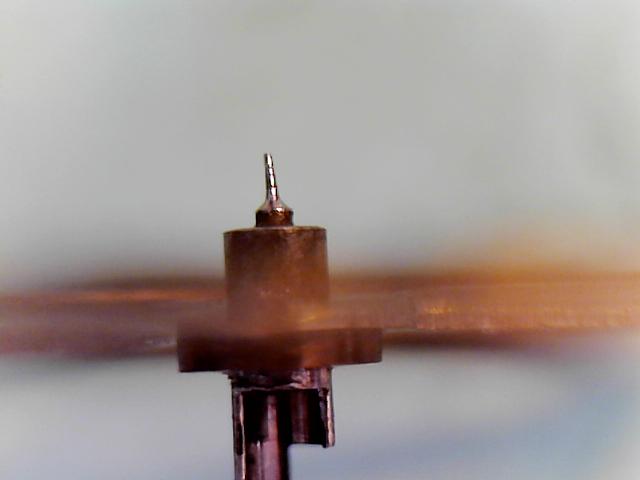

Another Gremlin popped up during my investigation, a bend balance-staff pinion :o
Leave it and see how the watch performs? I don't have a watch-maker lathe or other fancy rotating tools.
If I brake it, that's the end of this story ....... any "save" suggestions ?

Oh dear, not only bent but also worn. The cylinder is made up of 3 parts, two plugs at each end and the center part. They are very brittle, I can tell you if you try and bend it, it will snap. Finding a replacement will be very hard. Knocking the old plug out you need cylinder punches for that, stakes from an ordinary will not fit.
I think you have an impossible task.

I'm not sure whether it is going to be used or as a nice mantle-piece which preferably runs? I guess the only option left is to see if & how it runs and ask the owner on how to proceed and what the idea is ........
Indeed, bending it back is very high risk and than the question remains how much is there to gain? For sure, by bending there is a lot to loose ! ;)

Hmmm ........ The bend balance pivot causes so much wobble that the balance wheel touches and gets stuck on top of the escape-wheel bridge. Next to that, the end-shake is excessive  (worn-pivots & jewels).
Most-likely the watch has been dropped causing the bend pivot and poor maintenance/age caused a lot of wear-& tear. Also the escape-wheel is not 100% true either and shows a wobble.
Dial-Up it "runs"-ish, Dial-Down it grinds directly to a hold on top of the escape-wheel bridge.
Since my tricks-toolbox is getting empty, I will inform the owner that this beaten-up PW is beyond my capabilities .... :mellow:
