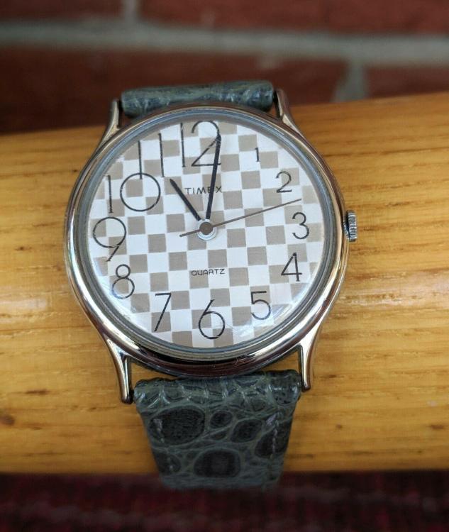

I use a pair of tweezers but the bamboo sounds interesting. Here are a few more just to let you see where this can go.
