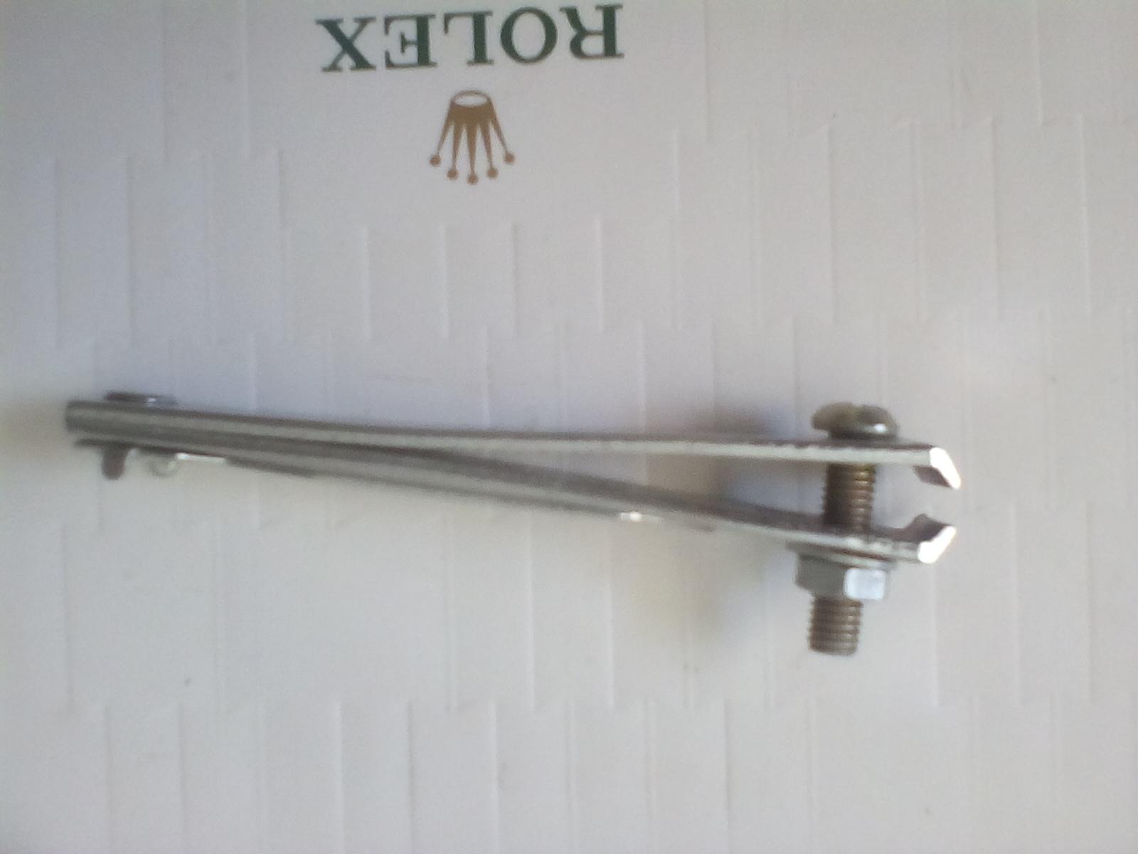

Tube appears greasy. If so, I pour some lighter fluid on a piece a cloth, wipe clean.
Tightening the bolt mimics a micrometer and gives good control over the tightening task.
Tightening is just enough to brings about some friction

Yes. It should fit on with a push. Just make sure you do not damage the teeth to the minute wheel.
Yes you feel some resistance thereafter, tighten in small increments/ turns towards the end, keep trying the canon pinion on the tube.
I have never tried this with the tube in the movement. Do not remove the pinion off the nailclipper prongs during the entire tightening process, grab somewhere in the midle of the tube.
Good luck

I have used a piece of sand paper to falttened sharp blades of the nailclipper to prevent damaging the canon pinion.
Good luck pal
    good show.  i would use a stone or file to Dub the sharp edge.  put a drill rod in the tube before making the crush. you can very the crush via the drill rod size.    vin
