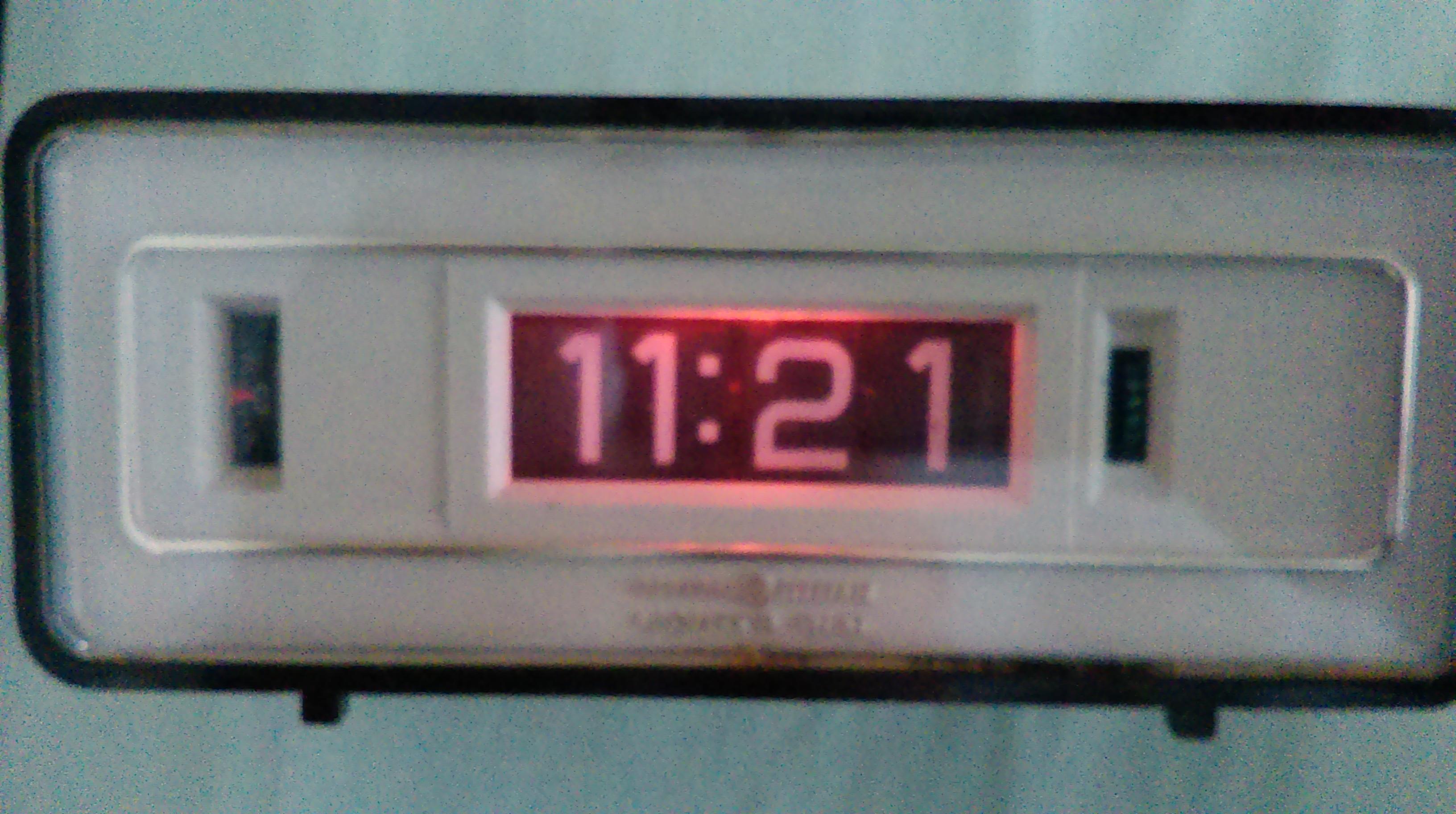

Alright..take a look at this old "digital " alarm clock. It has three rotating drums .hours.tens and minutes. Maybe a standard watch movement could be modified  to do this? Turned on it's side? The crown would be on the face of the watch.the drums could have raised numbers.all protected by a hinged lid..of course if you actually have to make one..that could be tough.but if it is just a concept..I think it could work
