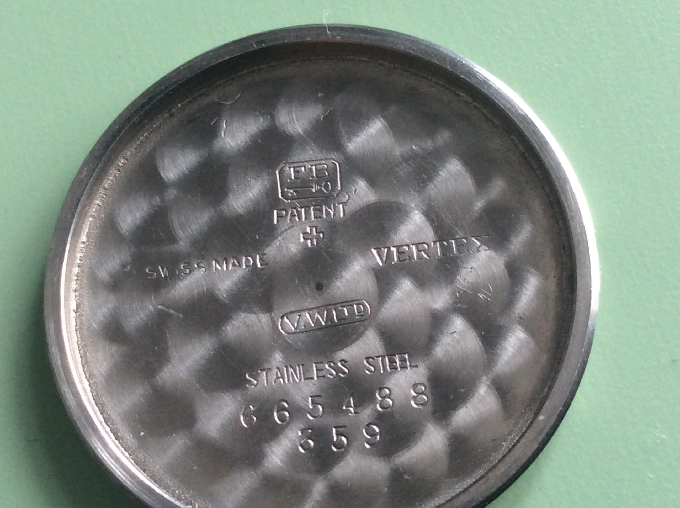

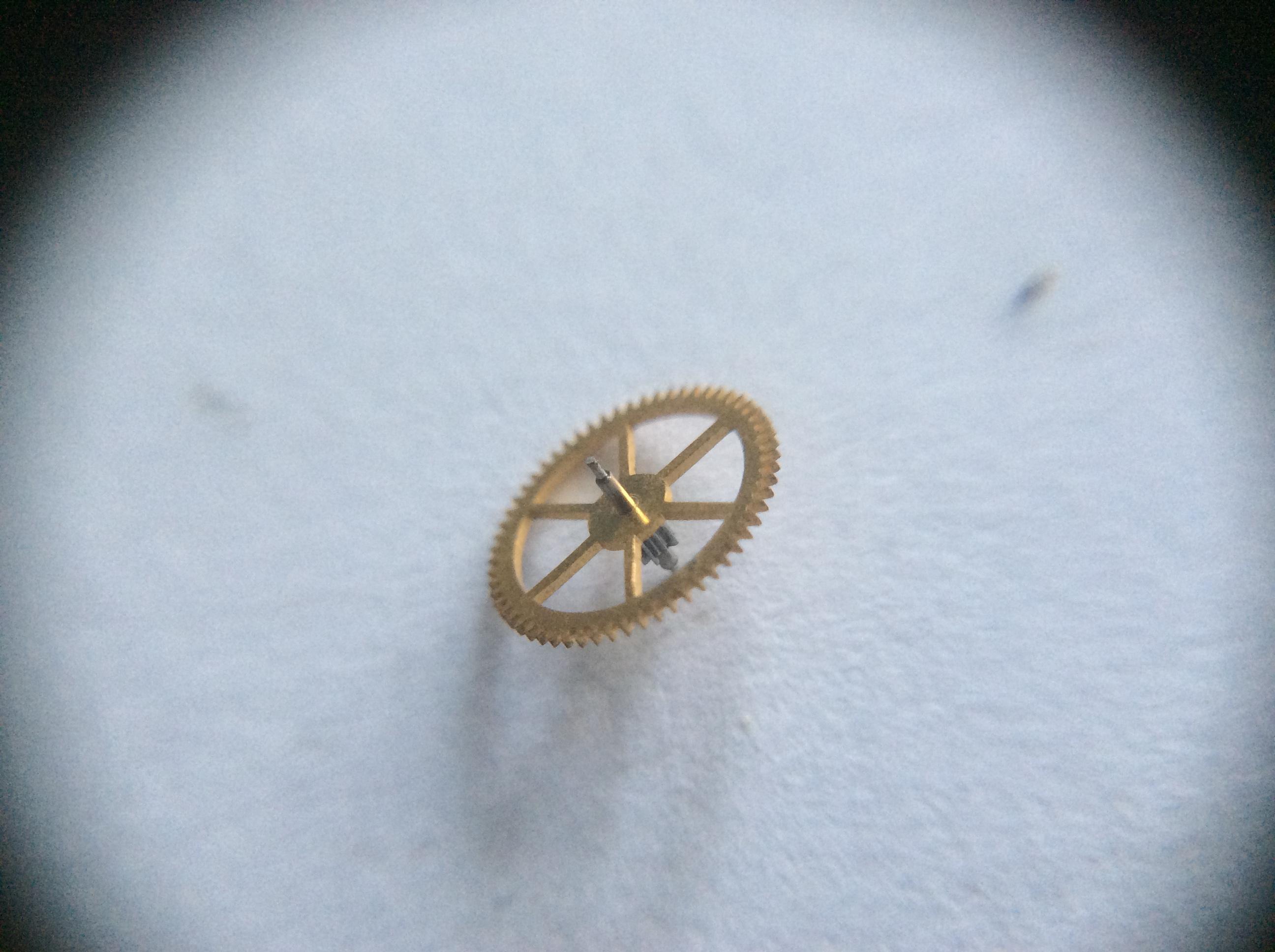

I’ve had this broken down old thing lying about for ages. I kind of like the shape of the case and given the fact it runs I thought I’d take pity on it and bring it back to life if I could. The hands are missing and on closer inspection it looks like the post for the seconds hand has broken. I can find no markings on the main plate to say what the movement might be, then maybe I could track down a replacement part. Can anyone tell me what it is please?
D03B6611-6158-410A-9B0E-6EE796C1214F.thumb.jpeg.92b958ab0e6f9418e54bcccbea0cb368.jpegC70C10EB-8C1B-4BDA-97D7-74F0573252B1.thumb.jpeg.885b934a71ef32d3843de2f80e6127f0.jpegB7F226A4-7A4D-420D-AF55-158A6437DF84.thumb.jpeg.fd1d4efd4a778772628de88c6ed14840.jpeg
I don’t know what’s been happening here but the underside of the bridge is badly marked.
I wonder if there is such a thing as a second hand with a long pipe that would reach onto the broken post?
Just by looking at the shock resist on the dial side I would say it is a CYMA movement since it seems to be  equipped with a Cymaflex-II shock protection... But exactly if it is or which in that case is hard to say without the balance in place and information of the movement size (ligne).
29 minutes ago, Marc said:
It's a Revue GT56, a nice little movement.
Mayby not the GT56 but I thought about the Vertex /Revue Tommen caliber 56, but the shock isn't the same maby there is different ones?

Very odd, I wonder if the broken piece of second wheel pinion was trapped under there and causing those scores. It certainly looks like steel scraping on brass.
The other thought was someone scrabbling around with a sharp tool trying to line up the wheels when attempting to refit that bridge (aka apprentice marks :P).
If it isn't either of those, maybe it is woodworm... err brass worm...?! ^_^
