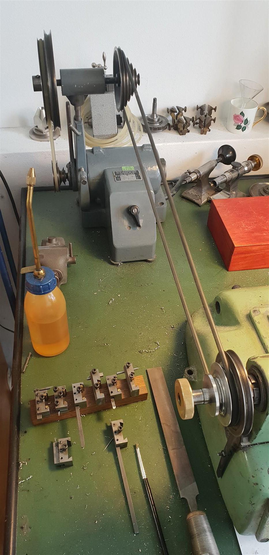

We made quite a few tools in school but here's some more recent and useful ones I've made. A puller for strike cams on typical german clocks, a simple turret for 3 tools on the lathe (I often have small series of parts that need drilling and tapping: center drill, drill, tap), a collet holder for the polishing tripod as I have a good assortment of these little collets and they make polishing screws a breeze, and a dividing head for my mill. The latter is mostly modification; the mill is a Sixis 101, the spindle is a w20 model from a hydraulic automatic machine, the dividing head from a Schaublin 13 mill. Managed to strip the hydraulic spindle down and find a conventional drawbar, a bit of fanagling to get the head fitted, and now it's used mostly to make direct dividing plates for another gear cutting machine.db4a42b787a567771b309a2965df4111.jpgf49f99d679c7f6ff3efbcde32dff5eab.jpg7100e41e991042bf9f083c4d0b184506.jpg483f1607b935c63fa3169506e9983dfb.jpg

It's a ww82, single pedestal (bed can be swiveled through a few degrees if desired). The Levin slide got a retrofit from a Schaublin 70 crank and screw assembly on the x axis.
I replaced the original motor ages ago with a DC, fit the drive in the base, all nice and neat. Then discovered the beauty of 3 phase and tore it all out. It runs on a little 3 phase motor with built in countershaft, the motor sits a good 50cm behind the lathe. In Switzerland even the tiniest apartment has 380v (well, 400v now) 3ph so it's not an issue. I must have around 10k hours on it, it probably did 3x that before I got it (it was set up for contact lens turning). It's a marvelous machine.

I have a friend who has the ww82 version of your lathe, with the big speed control disc on the base.  He's been meaning to change it for 20 years but just hasn't gotten around to it! And I meant to paint mine too but have given up on that ages ago. It's gotten new bearings though.
The motor I use was apparently made in the technical school in the Vallee de Joux. It's an almost dead copy of similar motor units that were made by Golay Buchel.
Oh- I made the little quick change toolpost when I was in school too, it's a copy of the smallest model Dorian made at the time.

That ought to be great! I don't have a reversing switch on my motor so I just flip the belt. For the odd times I need reverse it's fine. Meant to post of photo of the cute thing before- here it is.
