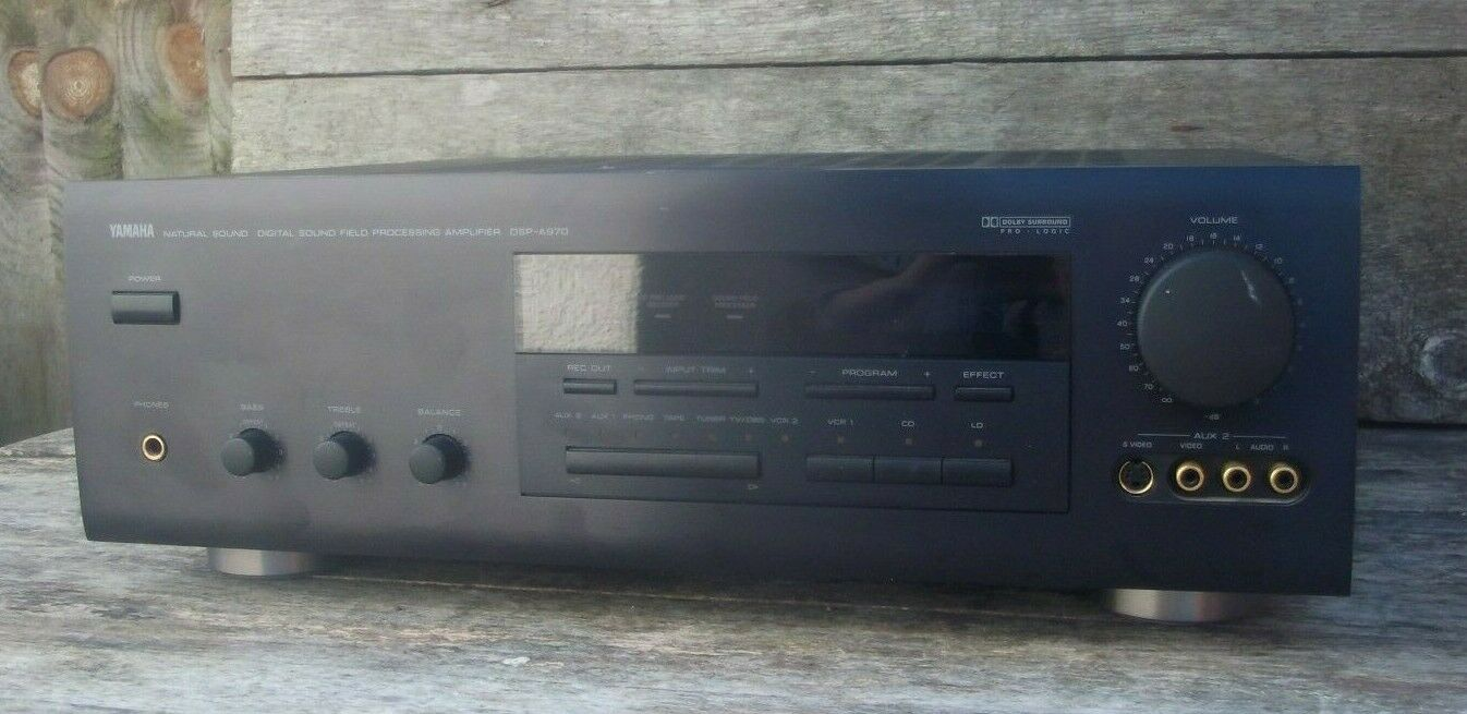

I also bid on another Denon HiFi separate, this time a tuner. To be specific, a Denon TU-260L II AM/FM tuner, which I picked up for eight quit. I wonder if I can build a complete "Audiophile grade" system from the bargain lots on ebay.
Sticking for the time being with the late eighties early nineties HiFi theme, I did indeed pick up a matching amplifier.
It calls itself the "Yamaha DSP-A970 digital sound field processing amplifier".
This was quite a pricey unit back in 1993 when it was introduced, retailing at 1,959.00 DM (around £800 which translates to about £1,512.99 in 2022).
Naturally it has issues, hence the low ebay price of £15 plus shipping.
I was going to go for just a basic amplifier, but the low price and the large number of inputs and acoustic tricks this one can perform naturally had me intrigued.
Well that and the fact that the volume appears to go up to infinity.
In good cosmetic working condition, they still sell for a lot more than I paid for it.

51 minutes ago, AndyHull said:
One Yamaha Natural Sound Digital Field Processing Amplifier DSP-A970.
(Allegedly working, but "display not lighting up".)
I’m guessing that vintage has those fluorescent tube displays. You may be lucky and the heater supply gave up the ghost (I think those were ‘always on’ if memory serves) or the actual display has faded to the point of being unreadable. I’m holding thumbs for the former!
That was my though too. There is often also a CFL driver board which may have failed.
I'll need to dig in to the manual. It is highly likely that I can replace the backlight with LEDs or even replace the entire display as it looks like a generic two line dot matrix LCD, which were common around that time.
It is also possible that the thing is actually dead, and only the power light is coming on. However, armed with the full service manual, I feel my chances of success are reasonable.
EDIT:
@gbyleveldt I was curious to know what the display was, so I looked it up in the Service manual. It turns out they have used a Hitachi HD44780A00 which is good to know, as I can almost certainly replace the whole thing if needs be, or hopefully I can take it apart and fix the backlight.
It may even use a filament bulb, since the display is relatively small, so a fluorescent backlight might be overkill.
However since they are ubiquitous and cheap as chips, I picked up a generic "cheap from China" replacement, just in case. I'll need to check the backlight voltage (Pins 15 and 16, not shown in diagram above) as if it uses an EL or CFL light, or a 12v filament I may need to improvise.
I'm sure I can use it for some other project if I don't need it for this.
