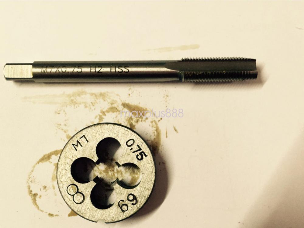

Hi Dralecmv
I myself own a Cowell's 90CW (just got it) and have done some research before my purchase.
A Cowell's 90CW has a spindle nose that fits 8mm. watchmaker types B8 (European Schaublin) and WW (American Webster Whitcombe), all this fit in Cowell's spindle. The difference is as you mention the thread.
B8 has a thread called 6.82mm x 0.625mm pitch with 55 degree threads.
WW collets have 0.275 "x 40TPI or 6.985mm x 0.635mm pitch.
The Chinese Sincere uses M7x0.75 on their accessories.
However, this is not a major problem. Sincerely can provide a universal drawbar that can be used for your Cowells when that day comes. Someone also feels great pleasure by producing some of their tools. Therefore you can easily find tap and die and make it yourself.
Cowells 90CW comes as standard with Drawbar for B8 collets. But as the machines are built to order it will be easy to get it delivered with just the drawbar you want. Even my goal is to make lots of drawbars so I can use what I want.
