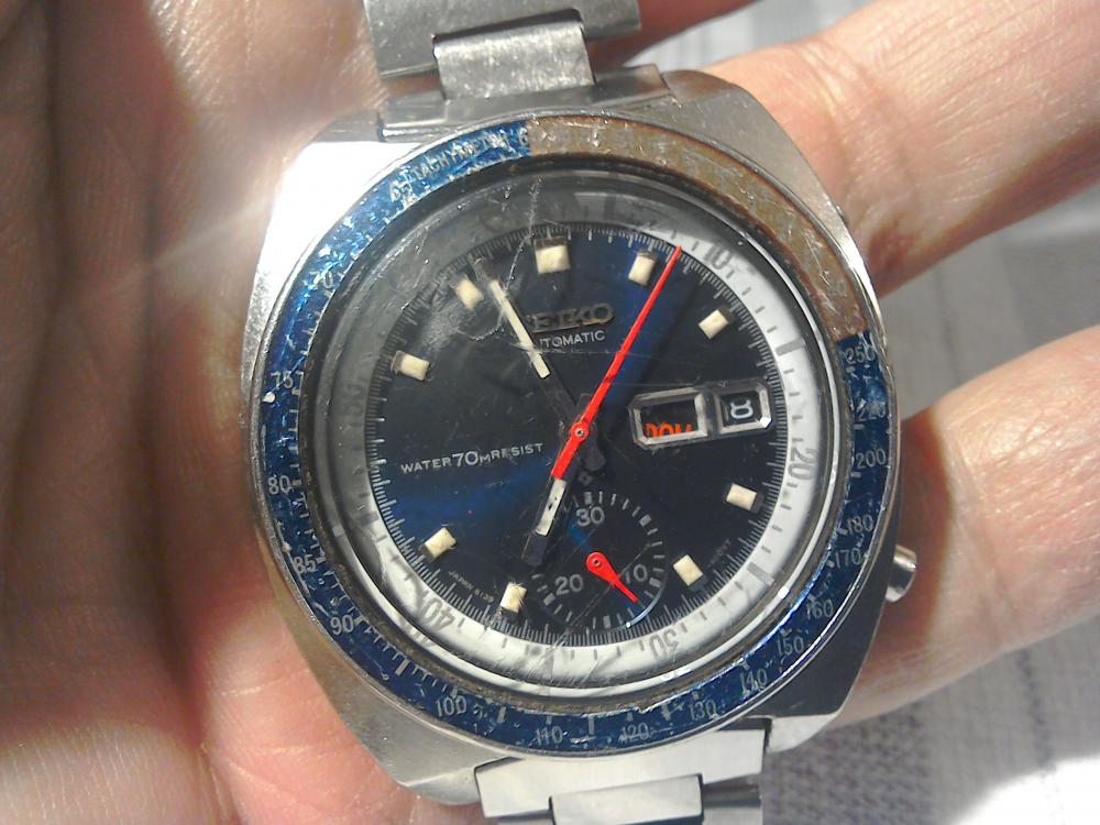

Hi, I have a Seiko 6139 and wish to replace the crystal. Having never replaced the crystal on any watch before I think it would be wise to take the advice of a forum member who has done this job before. Any advice would be more than gratefully received. Johnnie

  On 12/16/2017 at 8:15 PM, Johnnie said:
Hi Jdm, I have posted a photo in my reply to Ro63rto. What do you think???
Expand
Light scratches, easy to polish. The bezel is probably impossible to find original. The rest seems good enough.
I would worry more about repairing the movement, give it to a specialist, do not try yourself.
You need to remove the bezel. That is pretty easy. There is a little slot up around the 12 . Where the red meets the blue. Lift the bezel and the crystal poops out. There is the crystal and then the gasket.  A  spacer and a wavy ring . Then the inner bezel. You need to find the correct crystal. Which is a 330W18GN00. kleinwatches has some nice AM crystal that looks like the original. Don't go for a cheap crystal. They are often to low and would catch the chronograph hand.

Hi Rogart and thank you, with that explanation I will be able to change the crystal! I have looked around and "think" ??? That the right crystal will be in the region of £40.00 ? Will try and get a proper Seiko replacement if that's possible.

If I thought I could remove the scratches and keep the watch original I would, I just feel this crystal is too far gone to restore, obviously I maybe wrong, and that there is a miracle paste out there that will restore the crystal, and if so let me know.

It's not a matter of miracles but using the correct products and technique. If you haven't restored a crystal (or anything else on watch) before, you can't know. You can search "polish watch crystal" on this forum, or on Google, or on YouTube, there are many examples, although some are wrong.

Ceriumoxide or diamondpaste is used for removing the last scratches on the mineral crystals. Before that you have to use wet and dry sandpaper to remove the deep scratches. It's a lot of work.
I have used the kleinwatches crystal a lot of times and have never had any problems with fitting them. Both fit well and look like the original. Never tested the sternkreuz but have had a few problems with 6139  that was fitted with acrylic AM crystals. And SK gaskets aren't that good. If the original gasket is in good and it's in one piece? Use that.  Seiko crystal gasket are usually okay.
To be fair looks like there is a semi-circular crack @8 in the picture above, that can't be repaired. Other scuffs and scratches are not a big deal.
I think I had better change the crystal, possibly with the right methods and product the crystal could be made to look better,  it would need many hours of hard work. I am now thinking get the best crystal I can find and fit it and keeping the old crystal.
