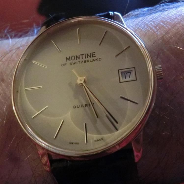

My lunchtime fix for today. Not much to say, new crystal obviously, new battery, full fumigation and case clean and polish. The original Rotary strap was almost unworn, so it also got a fumigation and was re-used.
.. and here is the Montine I did the other day for comparison.

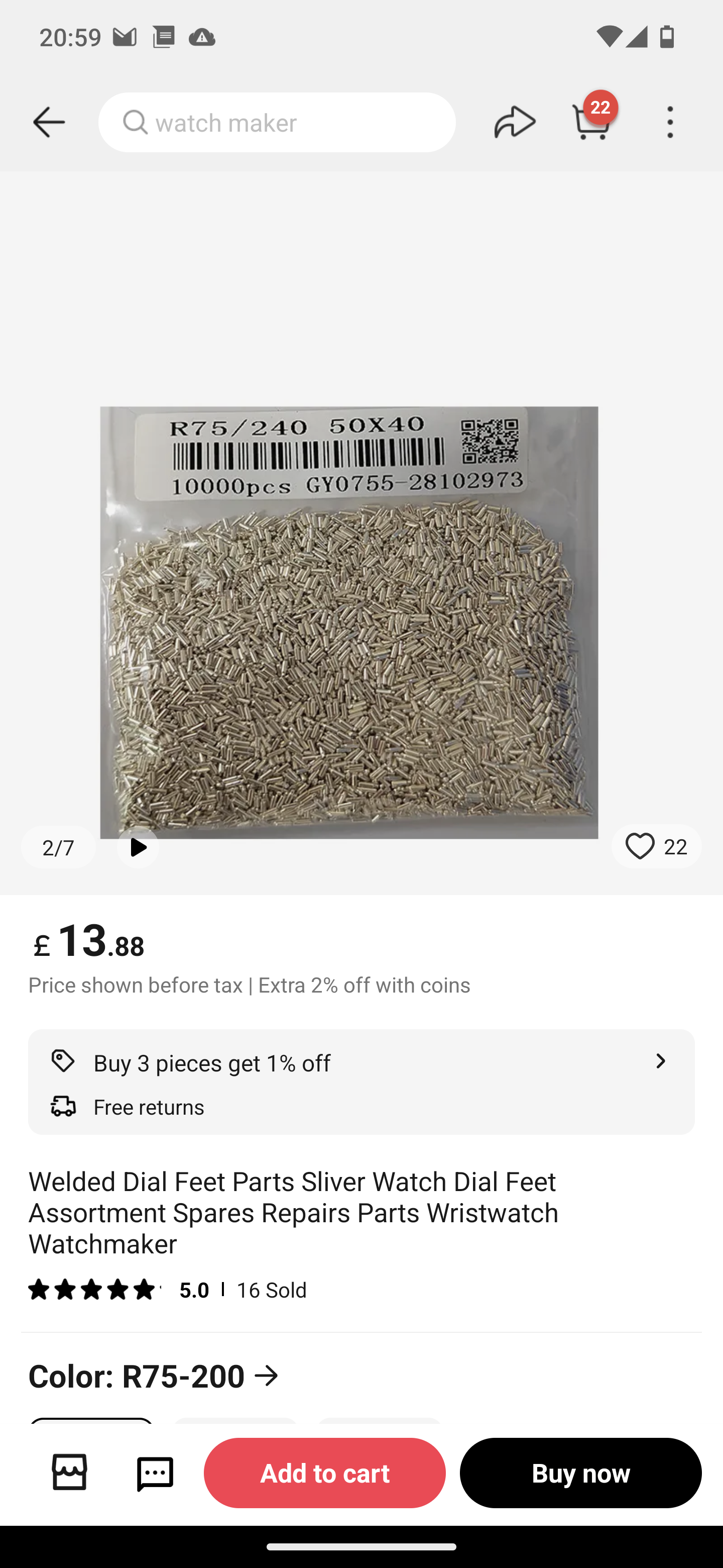

Another productive weekend, I fixed my Orient which suddenly stopped, on inspection I found a blue fibre wrapped around the escape wheel... no idea how it got there. I then decided to do a Seiko 7009 from 1985 that I purchased recently from speedtimerkollektion. On reassembly I noticed that the centerwheel was cracked around the inner diameter where the pinion is fitted... very strange (sorry forgot to take a picture). The crystal broke when I took it out (of course!) so I had to replace, hence the missing 24 hour numbers which were painted onto the original crystal. Everything else is original including the bracelet. Before and after pictures:
Here is the movement:
Our old friend Mr Glue! - no dial feet:
I replaced the dial feet using my new mini soldering gas gun and low temperature solder paste, worked a treat, and here is the finished watch, complete with fingerprints (Doh!):
Let me know what you think 🙂
I gave it a rough calibration, but will wait 24-48 hours to do the final calibration.
  • Like 7

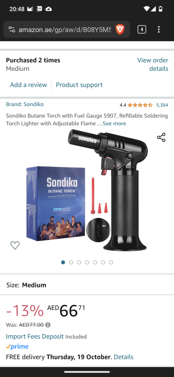

3 hours ago, steve1811uk said:
Looks great, would love to hear some more details of how you did the dial feet, equipment, materials, technique etc. I would be afraid to cause damage to the dial using heat.
This is the low temp (138 °C) solder paste I used:
And here is the butane solder torch:
I don't have my full set up here yet, so I used a dial foot reamer to mill a slot in the dial (see below), I then put a blob of solder paste in the milled 'hole' and the placed the dial foot with the sticky solder paste holding it in place, about 3 seconds of heat (if that) with the torch on low setting and it melted and stuck the foot in place. Worked a treat, the short blast of heat was enough to melt the solder, but not enough to travel through the dial to the other side (too much) and damage the front of the dial.
I have switched to solder as I have had poor results with epoxy and super glue, slightest force and the feet popped off.
My plan is to use the small dial feet and remove the need to mill a slot, but they aren't here yet:

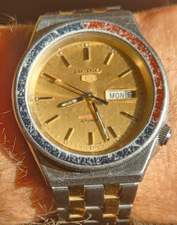

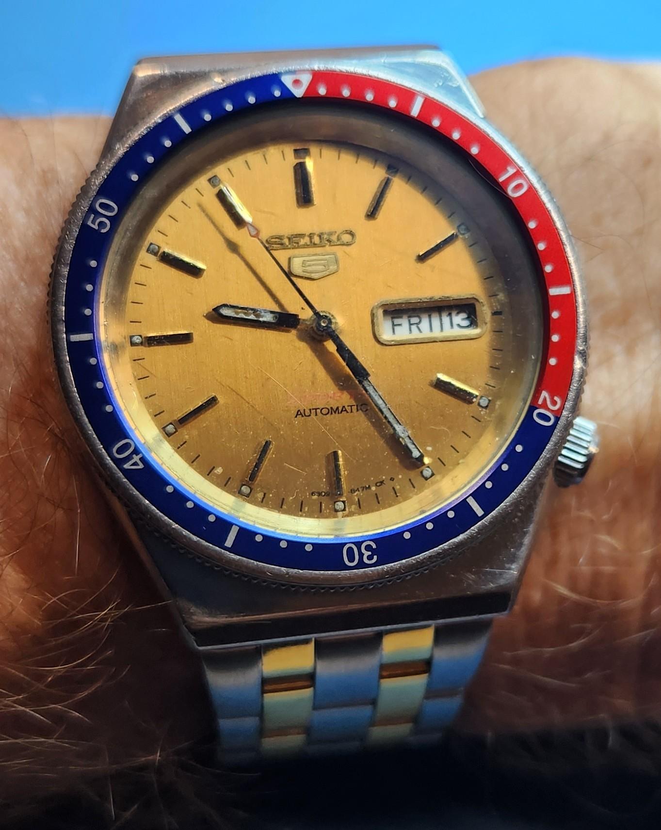

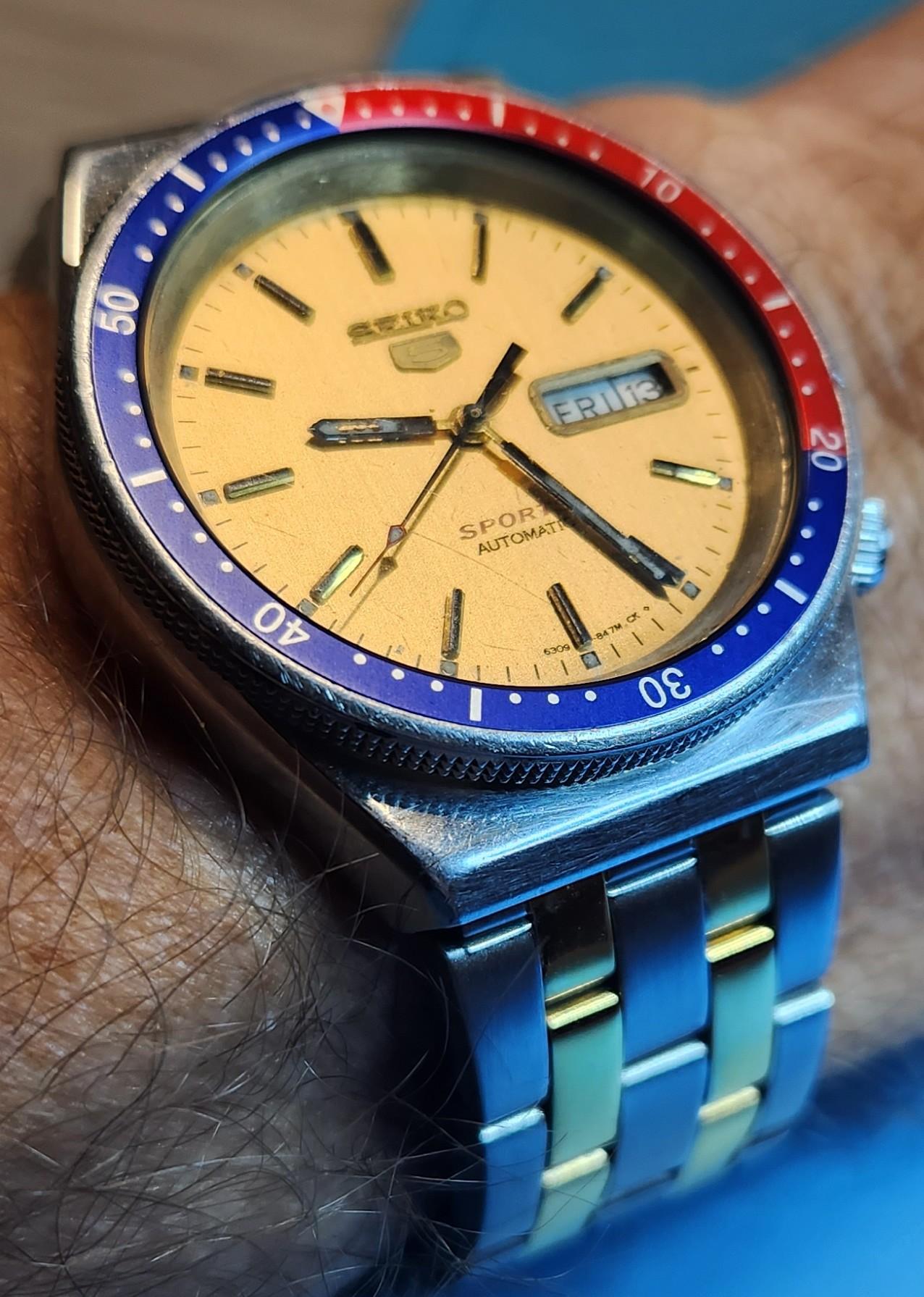

My work in progress 1983 serial numbered Seiko 6309-836b or Seiko 5 sports diver with Pepsi bezel. With the original bezel insert and a "NOS". Slightly different size numbers on the new insert. Aftermarket bracelet goes very well with the case, I think. Hands are in good shape except for the lume. Slightly scratched glass. Re-lumed, new glass, and polished case this would pop quite a bit more but is quite nice as it is as well.20231009_0826192.thumb.jpg.6119a07b7588c73a41f78910d5bb668f.jpg20231013_2125102.thumb.jpg.b3ed5bc754e88cb2aaa5bb71f5bb59fe.jpg20231013_2125542.thumb.jpg.6f3e97e20fddf1543ab46cf280024979.jpg
  • Like 6

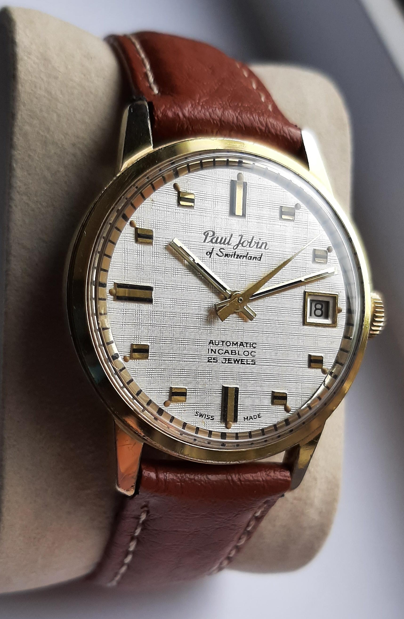

Just finished working on this 70s Paul Jobin 25 Jewel ETA 2772. As expected from  ETA, easy to set up and great performance on the timegrapher.
I'm wearing it today for a test. BUT . . .
I didn't realise until yesterday, when I was casing it up, that this movement joins those ETA movements with the infamous design flaw. i.e. if you don't have the crown in the hand setting position when removing the stem, the clutch is not constrained, and the yoke can come out of the slot.
 . . . so off with the hands, dial, date mechanism to reset the yoke and clutch 🥴
I've added a note in big red letters in my copy of the service sheet.
  • Like 8
I've had the same issue on a 2788 and 2789. Great movements, very accurate. It's one of those mistakes that you try and only make once.
Love the dial by the way.
Edited by steve1811uk
Added text
Only a second out after wearing it all day. Great movements, and cheap to buy if not in a big name brand.
The 2772 doesn't have quick-set date unlike 278x, which is a bit of a pain.

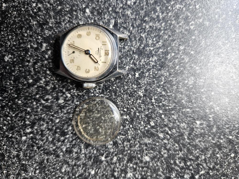

This one was part of a very profitable lot of ‘costume’ jewelry and two watches. From the pics I knew at least one of the strands of pearls was real and it turned out to be two strands with gold clasps. $$$ and a ladies gold longines I have yet to investigate..
…anyways, Mark L. posted a video of servicing a Chinese fakie movement so for fun and practice I gave this one a go…
Notice the sticker remnants to hold the dial in place
…a gear tumbled out when I opened the case. After cleanup and laying things out for assembly the top wheel on the setting lever was missing so the staking set made it right. Everything works but if I turn the winding stem- yes, it winds, if I turn the stem towards twelve the little date wheel becomes disengaged from the date ring…
The punch line- it regulated DD in beat and zeroed but it was horrible in all the other positions- one to two minutes, fast and wobbly. Just for fun I cased it up and wore it to dinner three days ago, played golf and wore it around the house…and as I write it has maintained perfect sync with the sweep second on my phone clock…what are those manufacturers playing at? 🧐🧐🧐 Kind of makes it hard to bin it…
