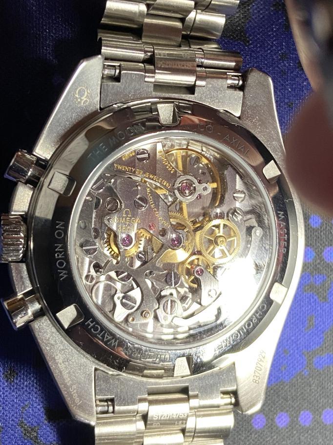

Late to the party, but this is my first proper luxury Swiss timepiece that I've owned. Only picked this up last month.
An Omega Speedmaster Moonwatch Professional Co-Axial Master Chronometer Chronograph 42mm (The sapphire sandwich version). I’m over the moon 🌕 (no pun intended) with it and wear it almost on a daily basis.
I love the Co-Axial Master Chronometer Calibre 3861 and the open exhibition style case back to see it in all it's glory. ❤️
Never, ever, ever going to even take the case back off this watch! Before any of you have thoughts of the horrors a newbie like me could cause this masterpiece of craftsmanship and engineering.  😆
