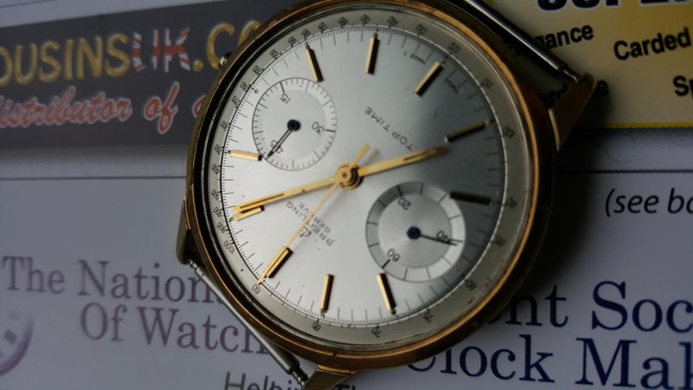

I have recently acquired this Breitling Top Time 2000 watch, and have finally decided to start renovating it. However, I cannot see any simple way of removing the stainless back - there is a lip all round the case which effectively hides the join!  I understand some Top Times were front loaders, but I have had the crystal out to replace it and can see no way of removing from the front either. The crown/stem wobbles quite a bit when pulled out to the setting position, but does not appear to want to simply pull out to separate (and I am scared to pull too hard for fear of snapping it!).
So can anyone advise me how to get the case back off, or how the crown should come out (slide apart or pull apart)?
Thanks in advance.

Guys,
Yes it was a split stem, and I have successfully removed the outer part with the crown - thanks for your kind offer @digginstony. Yet still the movement will not come out of the front - this is really starting to bug me now!
With the crystal removed there seems to be a silver metal ring inside the case, very thin but enough that the dial with tachy ring on will not pass through, as per the attached image.  Is it expected that the whole movement/dial assembly will just come out with the stem and pushers removed?  The second image (From Watch Guy website) shows a top time movement out through the front in one piece.
I was hoping to leave the internals alone for now, just getting the case refinished, so I don't really want to have to remove the hands and dial etc, but if it has to be then I guess I will. I guess I will try and heed @sstakoff's warning about the hands and pipes issue.
I am so nearly there, just need that last bit of help.

Hard to be certain from the pic, but it looks like you may have removed the crystal, but not the bezel. Is that possible?
How did you remove the crystal?
I'm assuming the watch had acrylic crystal that you removed with appropriate grab remover. You need to push the remaining part of the stem back into the movement. With a plastic bag over the dial, try rotating the dial either way with your fingers. Dial face down on your fingers and hopefully it will fall out. Normally it's a rotation of 45 degrees

Hi @sstakoff, I removed the crystal (acrylic) with a grabber tool.  I didn't think this watch had a bezel - certainly not an external type like I would imagine a bezel to be (like on a submariner). Nothing else metal came off with the crystal.
@digginstony Yes crystal removed with grabber, remaining stem pushed in, but the dial will not rotate. It goes a very small amount (less than one degree) in either direction and then stops. I am slightly scared that I might slip and break a register/hand.

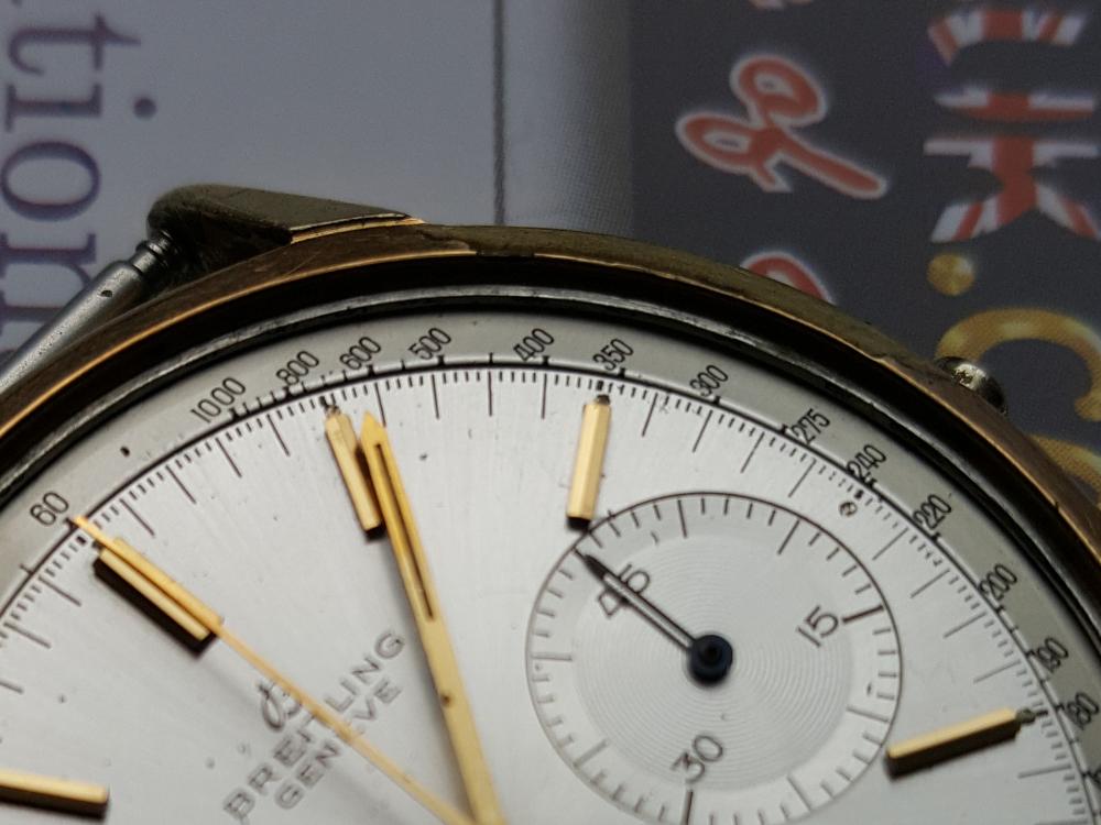

If indeed this remaining ring is a 'bezel' how does one get it out when it is such a thin ring with no visible means of grabbing it? I have attached the whole picture this time so hopefully it shows exactly what and where this thin ring is - outside the tachy dial and inside the case.
Acrylic crystal confirmed. Shouldn't have a detachable bezel. The metal around dial may well be part of the movement holder. I suspect may not be moving due to muck and crud accumulated over the years. Try giving the back of the case a good tap to see if you can get anything moving

@digginstony, done that, no joy.  I am now thinking that the outer tachy dial might be separate piece which can (somehow) be removed, and could there be a couple of movement retaining screws underneath it? If that is the situation, how do I get the tachy dial off - there are virtually no gaps anywhere around it.
I wouldn't attempt the tachy dial unless I absolutely knew it had to come off. Hopefully someone will come onto this thread with experience of this model of watch
Sent from my SM-G920F using Tapatalk
Hi @jdmI don't think so as the ring is so thin and has no visible means of holding or grabbing it to turn or pull it.

The picture taken from the 'The watch guys' site shows the outer chapter ring removed and some tell tale holes which to me would indicate that the inner ring is removable. Maybe a poly bag and a hand lifter could be used to see if there is any movement in that ring.
