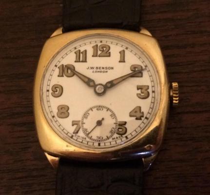

From time to time, I'm unhappy with the watch luminous on a watch I've bought.
I normally like to keep things as original as possible and just leave them alone, but sometimes it doesn't do it the watch any favours.
Sometimes the hands have been redone in bright green, maybe the hand luminous is falling off due to careless watch repairer, or perhaps the hands have over aged and become black and too dirty to read.
So that's where I step in and do my best to getting it looking proper.

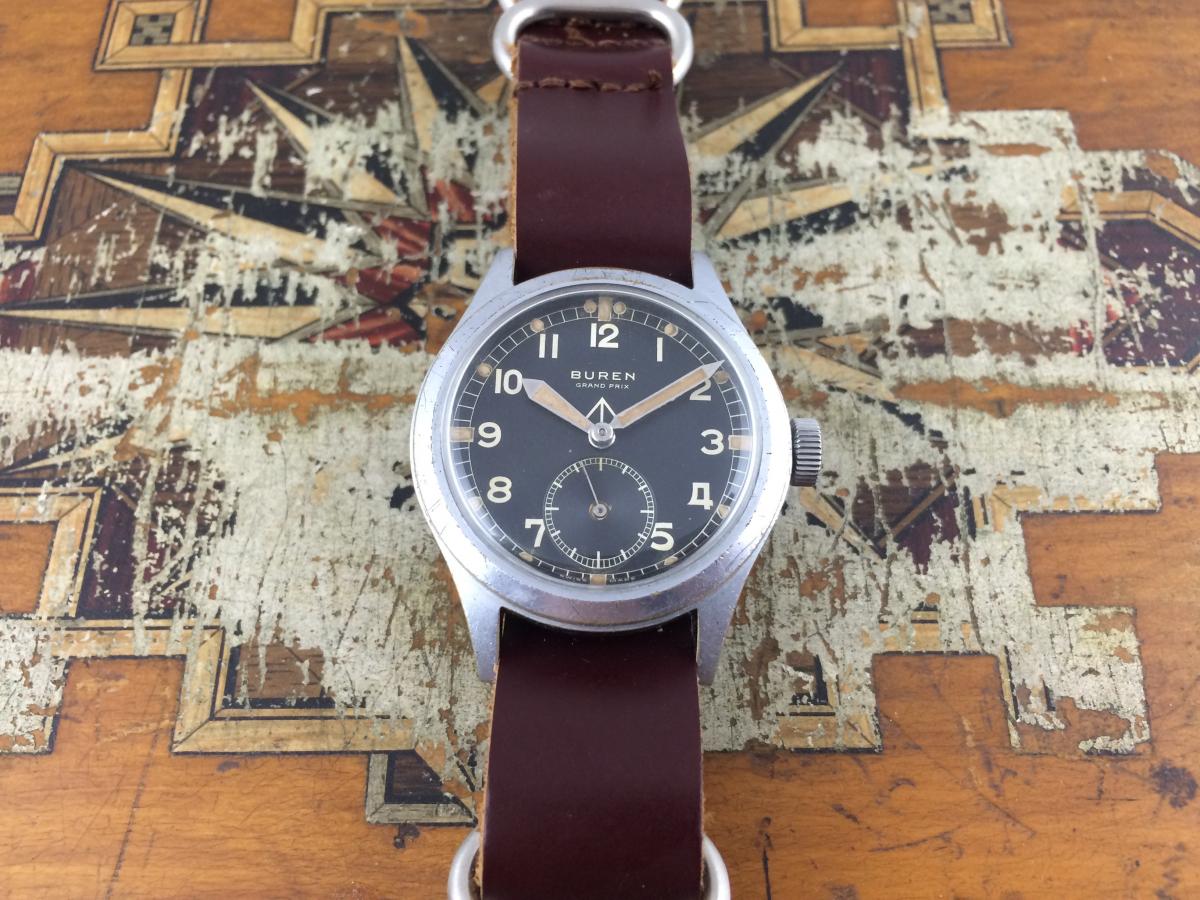

This is a Buren military watch from the 1940's, someone before me painted the hands bright green and the original luminous turned black and was missing in places.
I decided to redo the hands and dial luminous. (white spots on second picture are from lint which my iphone camera picks up from the strong light source)
