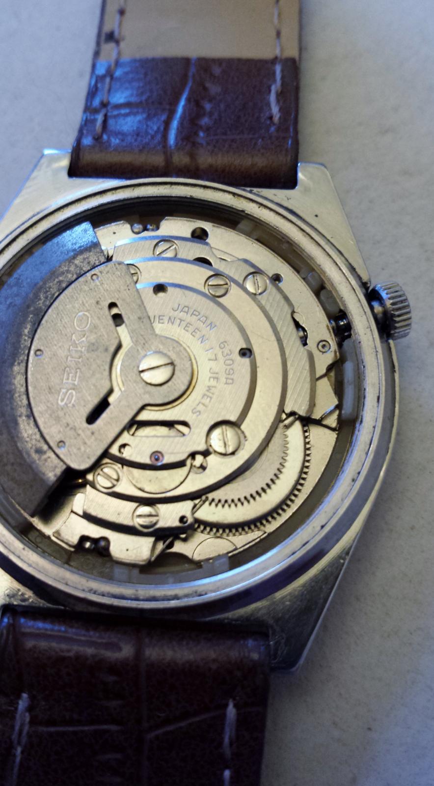

I found a Seiko 5 in the street a few months ago and handed it in as lost property. A few of days ago I received it as not claimed...cool, a free watch.
I set it and it has kept suprisingly good time since, losing only a few seconds in 3 or so days, quite acceptable, to me at least.
The only issue I have with it, and being a gift effectively I shouldn't really have any, is the dial is not aligned to the case.
The whole face seems to be a few degrees behins true.
I have opened the case, removed the movement and checked the dial feet, which I thought may have been damaged and the dial glue in place somehow, but the feet seem to be undamaged and held fast by retaining screws.
is this a simple fix, or would it cost more than the watch is worth to have rectified, after all it is something I can live with, as it gives the watch a certain quirkiness.
So any suggestions or recommendations are very much appreciated.

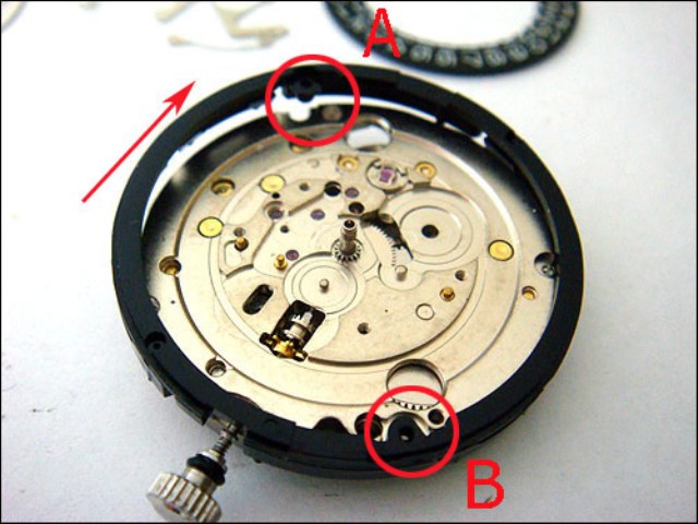

What is strange is that that day and date are aligned with the window. Is it possible that movement (in fact the day ring) was replaced from a case with crown at 3, but someone rotated the movement ring to keep the day aligned. Day ring for crown at 4 is easily available.

In my experience with Seikos, it is the dial the one that is made for dates at 3 or 4, due to placement of dial feet. All other parts are the same for both instances. The only variation for the plastic ring is the height for when there is a chapter ring or a lower depth case well. In any case, I'll be waiting for developments on this watch and pictures...

PS. Maybe it is the plastic ring that is positioned incorrectly in the movement...

This is what I'm thinking:
This is an example of a movement ring and as you can see there are many places for the stem to find its way out of the movement but in most cases the ring fits in a certain way in the case. If the ring is positioned wrong but in such a way that everything else fits you get the rotation.
I think you have hit on the most feasible answer bobm12, which likely means someone has had it apart before, but a simple fix.
I think someone has played with it in the past. The dial says 21 jewels, but movement says 17 jewels.
I'm guessing something has been changed and incorrectly.

Probably not a Feiko but definitely a Franken. Do you have a picture of the inside of the back?
When I proclaimed it a feiko, Tapatalk had only loaded one of the pics in post #9. The missing pic was of the movement which shows a 6309.
I hereby retract "feiko" but maintain "franken".
Please read the above with a suitable trumpet fanfare playing in the background [emoji16]
Oh, and the crown is not the correct one. I think it shouldn't protrude from the case.
My guess is that the case is a 6119 and the movement and dial is from a 6309 . The 6119 has a quick change function. That is why the crown protrude  a little from the case. And the 6119 has the crown a little higher then the 6309 case . That is why the movement and dial isn't align? It is a franken seiko watch.
