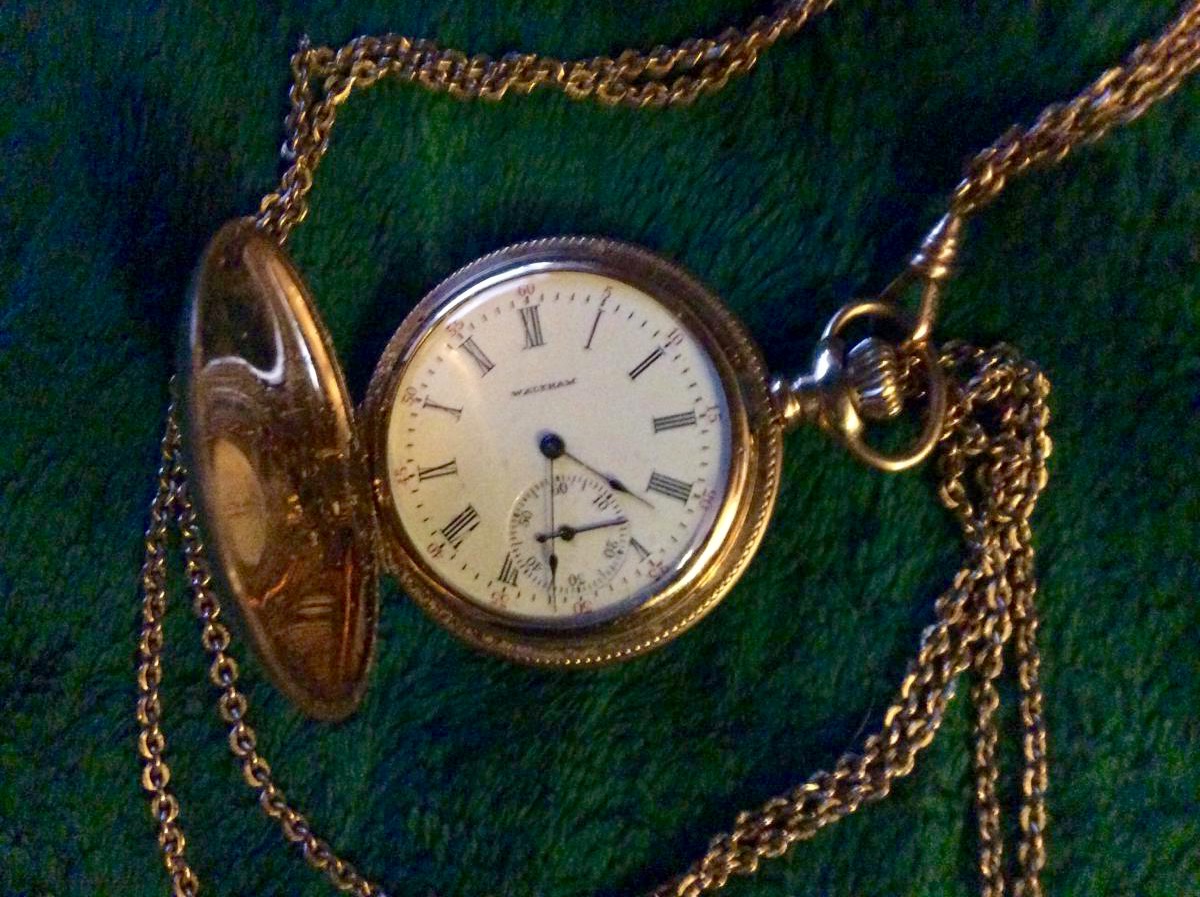

Thank you all for your kind words regarding my grandfather's watch. According to the serial number it was made about 1868 so I think it may well have been my great grandfather's watch first and he would have bought it while still in Europe - what is now Biled, Romania but was then part of the Austria-Hungarain Empire. I wonder how many of these watches were sold in Europe. Anyway, for such an old watch it keeps very good time and I often use it. It has recently been cleaned and had it's rather worn mainspring replaced - probably the original.

Hi ya
If you open the back and look for the serial number on the movement, not the case, it should give you a fair idea when the watch was built. The serial numbers for 1890 should be around the 4,700,000. Hope you can read the picture. If not, type on a Google search "Waltham watch dates" and see what comes up.
Sent from my SM-G900F using Tapatalk
12754445 is the serial number so it was built somewhere between 1903 and 04. That makes more sense.
It was the watch my grandfather used every day while he was section foreman for the CPR.
Thank you for the info.
