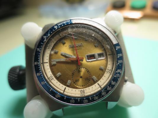

I got this Seiko 6139-6002 for pennies on the dollar albeit it was not working, in poor physical condition and with missing and damaged parts.  I used after-market parts to “restore” this watch to a portion of its lost glory.  This will go down as one of my favorite repair and restoration projects.

As I mentioned, the watch has many minor issues:

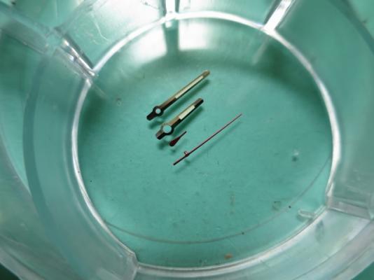

  • It has a missing sub-dial hand.  I was able to purchase an after-market set of hands.
    The after-market hands are difficult to find and I was lucky to find a supplier here in the Philippines who has several sets as samples.  Apparently, he had a Chinese company replicate them and they are still in the process of testing the batch.  The minute hand is actually a bit loose and the sub-dial hand got removed after a few chrono resets.  I had to tighten them a little.
  • It did not come with a crown and a stem.
    The stem used in the Seiko pogue is different from the one readily available, so I have to settle on one that is used with those without a rotating inner bezel.
  • One of the chrono pushers is bent.
    Again, I used after-market replacements.
  • The dial has a missing foot.
    I still plan on reusing the original dial but I would have to build my own resistance soldering machine to attach a foot.  So for the meantime, I used the after-market dial shown in my original post.
  • The intermediate date wheel is damaged.  Here's a picture comparing it with a good one (right).
  • The cannon pinion is loose.  I have a spare 6309 and luckily, the 6139 uses the same cannon pinion.
  • The crystal is all scratched.  I could have removed the scratches but a replacement crystal is also readily available.  Here is a comparison of the replacement crystal (right) and the original one (left).
  • The original bezel is scratched and faded.  Again, an after-market replacement was used.
    but the new bezel is a bit big so I had to trim it a bit.
  • As expected, the oil and grease inside the barrel are all dried up.
Fortunately, outside the  issues described above, I did not find other problems with the watch.
As  you can see, I can't really claim that this was a real "restoration" as I used a lot of after-market parts.  Many watch collectors will frown upon this but as a watch repair hobbyist, I put more weight on the integrity of the movement.

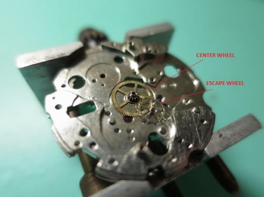

I started the assembly my installing the center wheel and the escape wheel onto the main plate.
...followed by mounting the barrel assembly, the center wheel bridge, the third wheel and the chronograph wheel.

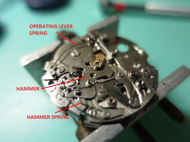

Next, I installed the hammer and the springs.

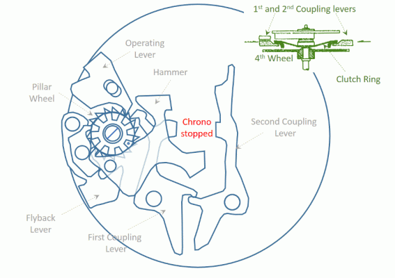

I believe that the best way to assemble and fix a movement is to first understand how everything about it works.  So I made some animations to help in understanding how the chronograph assembly works.
The Seiko 6139 features a column wheel and a vertical clutch.  The chronograph second engages and engages with the 4th wheel via a clutch spring.  The clutch is controlled by the first and second coupling levers.
See how pressing the operating lever rotates the column wheel, which in turn, controls the coupling levers.
While the chronograph is running, pressing the flyback lever will have no effect.
But when the chrono is stopped, pressing the flyback lever will activate the hammer, which in turn, resets the chronograph second wheel and the minute recorder wheel.
I hope these animations were helpful.
