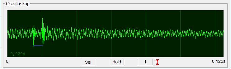

Hi Jdg123,
I sent your soundsample through my timing machine.
Unfiltered, it is very low and shows huge noise, exactly hum:
With filter on, evaluation is sufficient:
Frank
Edited by praezis
11 hours ago, praezis said:
Hi Jdg123,
Frank

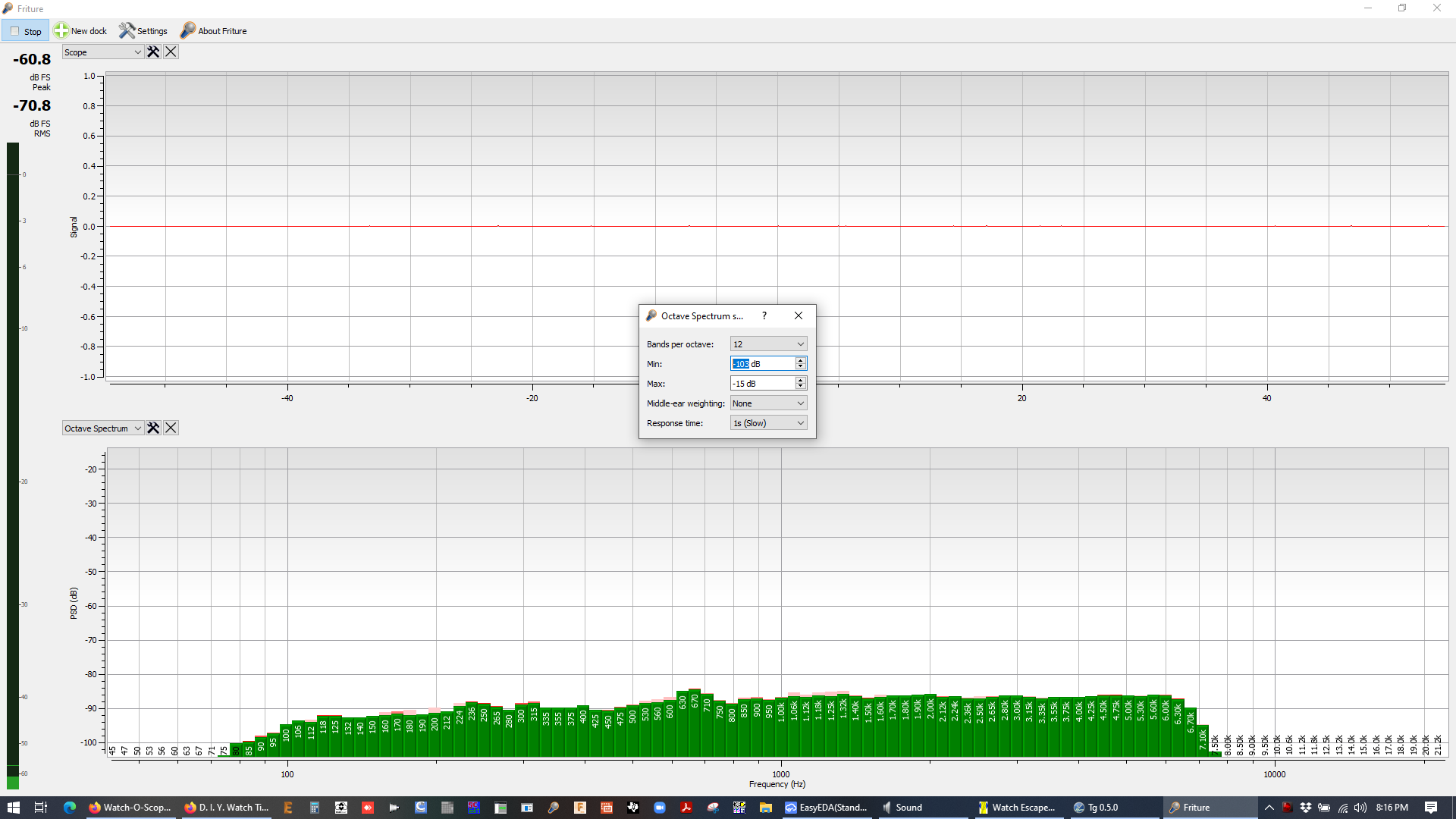

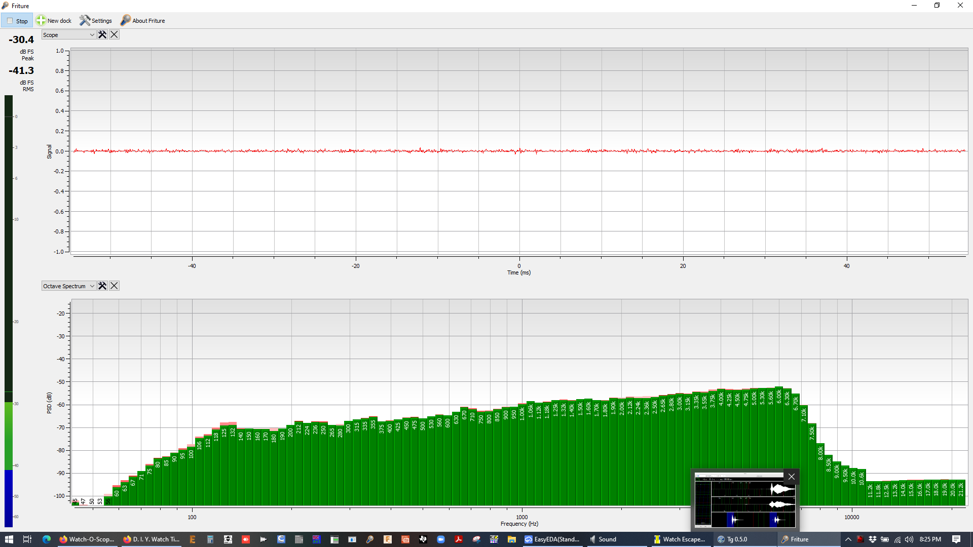

Hmm, not what Im seeing That recording looks like the one from the transistor mic or the regular piezo disc mic, and from a 2892 movement maybe.   They were noisy, the WOS I made was a bit worse, but seems to have a little higher gain.  Im curious to see a trace from a WOS that others have built.  I did notice that when I record on my laptop I get a weird hum when turned way up, but it doesn't do it on my other pc that I use in the shop.  Also until recently I did't have decent shielded cable, whenever you even pass your hand by the cable it would start to hum.   I bought some really nice cable but have been too lazy to put plugs on them yet, going to use xlr.  I will use it when I get the updated version done.
The 4th pic is without anything on the mic.
The 5th pic is with a watch on the mic,
the 6th pic is with the amp turned off.
The last pic is from the PC microphone (everything unplugged.)
Seems pretty decent.  This is in a noisy room with Florescent lights, 6 inches from my PC, connected with a very crappy, shielded cable.
I am not sure how to get a decent reliable audio recording, perhaps I am doing something wrong.  It seems My amp is actually quieter than anything else I have plugged into this PC....  Maybe it is my sampling settings or something?  But all that being said I can not reproduce the hmm that you have in your screenshot.  What version of the software do you have, where did you get it?  My copy is different than yours.  Thanks so much!  I have tried a few different preamps so far, nothing has worked as well as this one, the WOS was very close and may have been better, I didn't have this new mic I made when I tested the WOS.  When I am not under all these lights things seem to quite down a little but not much.
My expeirance has been that regular disc piezos are sensitive but very noisy, the transistor amp is far worse, the vibrograf mic works great, and the last mic I made based on the vibrograf works better but has slightly lower signal strength, it picks up almost no background noise.
I see that others have got the transister ones to work but I have not been able to get decent results
I did notice something strange lately...  Im getting an odd "rubbing" "clicking" sound randomly, and even when there is nothing in the mic there sometimes will be a random increase overall in gain, then it levels back off.  Just started the other day.  I have been handling this board pretty roughly and trying different components so I figured I damaged something.  I also have been attaching and removing various sensors to it.  Strange
Thank you very much for your help and insight.

On 4/5/2021 at 2:32 AM, Jdg123 said:
Tg seems to be able to handle your sample just fine.  There is a lot of low frequency noise, but the 3kHz high-pass filter takes care of it well.  There is a big glitch on the paperstrip about every 22 seconds, because that is when the audio sample loops.  The smaller glich about 17 seconds sounds like muffled thumping, as one gets when the microphone or watch is being moved.
Here is a spectrogram.  We can see the ticks, as well as lots of noise in the < 2kHz range, as well as something at about 16 kHz.
Here's a closeup of the < 3kHz noise.  Definitely something very large at about 710 Hz.  I'm not sure what is going on at 1.9k and 1.1k.  Maybe the microphone holder is vibrating on the watch?  It seems like the movement is causing something to resonate one of two frequencies for an entire beat or more.

That´s what I called hum on my scope, actually a bit higher than hum (I calculated 725 Hz from the scope picture).
Frank

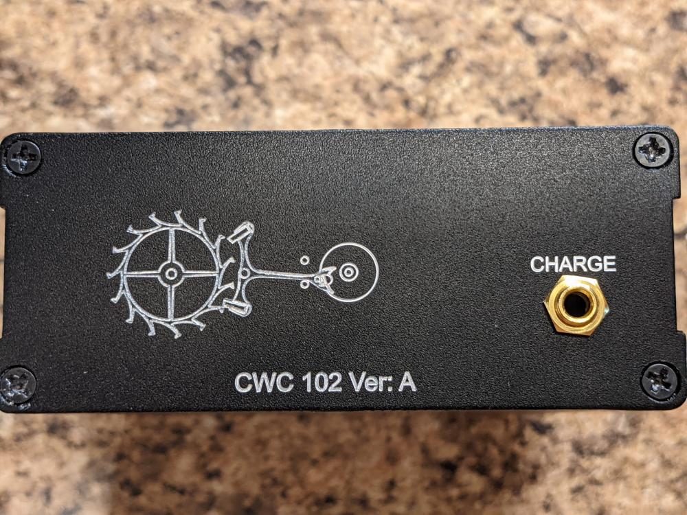

Amp and updated my microphone
The results are amazing. The best indicator of microphone and preamp performance is what is indicated by the blue circle on the eTimer. We have a very high signal-to-noise ratio. 49dB. Nice job @CWRNH
Thank you, What is the common?
