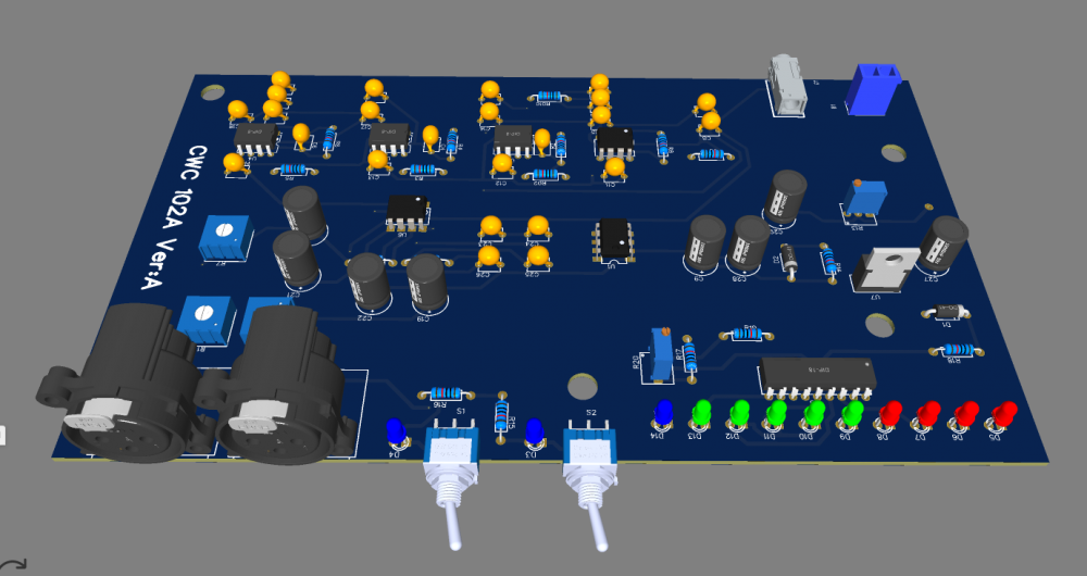

I was able to find Piezo mic elements that work well with my preamp and fit in the Vibrograf pickup.   Very difficult to find.  Had to make a mounting plate to use in Vibrograf pickup.  I tried several different piezos in several configurations before I found one that worked.  I will be creating a document on what I used and how to mount.  This setup is sensitive and has very little background noise.
The latest board I am working on.  Everything works well on the breadboards I hope the complete board is satisfactory.
I am documenting everything and will post the info on how to build it when I get it all finished.
What are the LEDs...a VU meter?
LOL.....  Overkill, just to indicate the level of charge in the rechargeable battery.  It will also have an LED that will flash to the impulses from the watch.  I will probably change the indicator to less LEDs, something like 4 levels.
Using 9.6v battery that when charged puts out 10.2v.
Then there is a voltage regulator, then the rail splitter, and a power amp for line/speaker out.  The the volume pot will be changed to a normal one and put to the front of the board.
One LED is to indicat power on, one is to indicate Power amp on.
I also made some changes to the preamp circuit.  I will be make bigger changes in the next version.   The mics will be of several types, some passive, some active.

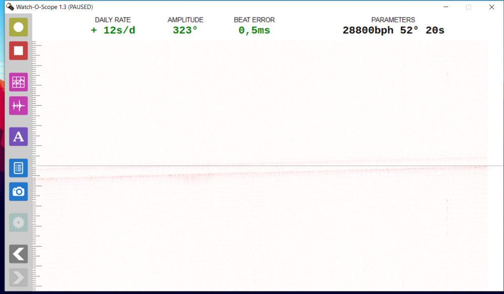

I’m sorry, I was thinking wrong on the watch I initially talked about, but I’m still not sure if it is working correctly, I have tested a relatively new Hamilton with a ETA 2801-2 that actually should run pretty well but the timegrapher shows rates fluctuating from +100m/d to -300m/d (I haven’t worn the watch lately, but that has to be wrong) I‘ll upload another soundsample and the pictures of my mic settings.

I just tested a few more modern watches (eta 2824, 2801 and a sellita sw200 last one is just a year old) and they all show the same problem, the timgrapher reads a pretty big beat error and the amplitude fluctuates substantially. Im not sure if it actually is the tgs fault or the watches acutally run that bad (which would make me even more sad).

2 hours ago, Jdg123 said:
now it looks like this. at the beginning the beat error was around 0,4ms but after like 2/3rds of the recording it went "snowstormy".image.thumb.png.9342f7452ed3a9a2a02de8ac2849b1ee.png
check the "Plot raw watch sounds..."
I think you have a low signal to noise ratio

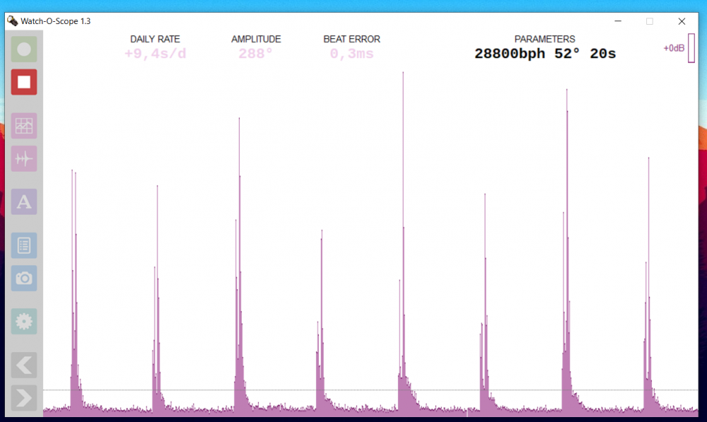

Now the software tells me it’s unable to detect a consistent tick.
edit. I just haven’t plugged in the amp. Overflowing with stupid today...
Edited by Jdg123
It is looking way better now, the values are way more like I’d expect them to be from when I was wearing the watch. How do I reduce the noise so I can uncheck the button again and get good readings? image.thumb.png.f261b5b09eabe7e1adc12eaca328dcba.png
Edited by Jdg123
I’ve been using the volume instead of the gain knob on the amp (again...stupid), I think that wasn’t helping with the noise
after listening to a few recordings my signal now looks like this, with 0dB “artificial” amplification from the software.image.thumb.png.b796cb8840f4e8b88f14bae74e647c56.png
