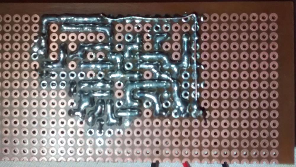

hello
my quick and dirty amp doesn't work as expected. well it works but has limited gain somehow. reads finger taps on piezo but cannot hear even the loudest watches i got. so much for a crude prototype without sleep. there are no shorts, bat is at 9v and turned pot all the way up and down
can you guys pls check my build and suggest something before i start over and lose or break parts :)
thanks in advance
I've taken your two photos, corrected for perspective, flipped one, and then traced the connections, to come up with this:
I don't have a lot of time to look at it right now, but the first thing I see is that you've got pin 6 of the first stage coupled to pin 9 of the second stage via C3 and R3. It should be pin 7 to pin 9. Anyway, with the above in hand, you can probably easily compare against the schematic to find any other errors. It seems like you might also be missing the ground connection on R7.
progress now my amp works with high gain for 5 seconds then fades away lol
i really wanna break this and start over but i dont have spare parts so ill bug you guys again
sorry
6 minutes ago, pipi said:
yay found the error it works now
thanks guys
What did the problem(s) turn out to be?
Just a piece of advice: When I design and build a circuit, I start with the schematic of course, and then I design the circuit layout, with a printed copy of the schematic by my side. I use a highlighter to trace each connection on the schematic when I make the corresponding connection on the layout. Then, when I build the circuit, I have a printed copy of the layout by my side, where I highlight each connection when I make that connection on the real board.
Finally, and most importantly, I go over the completed circuit board one more time, with a copy of the schematic by my side, highlighting each connection as I inspect the corresponding connection on the board. This double-checks both errors that occurred when designing the layout from the schematic, and errors when constructing the board from the layout.
The step in bold above can be done by anyone building a circuit, even if they are not the designer. I have caught and correct many construction errors this way. It always takes less time than giving up and starting over, and also tends to save money spent on blown parts.

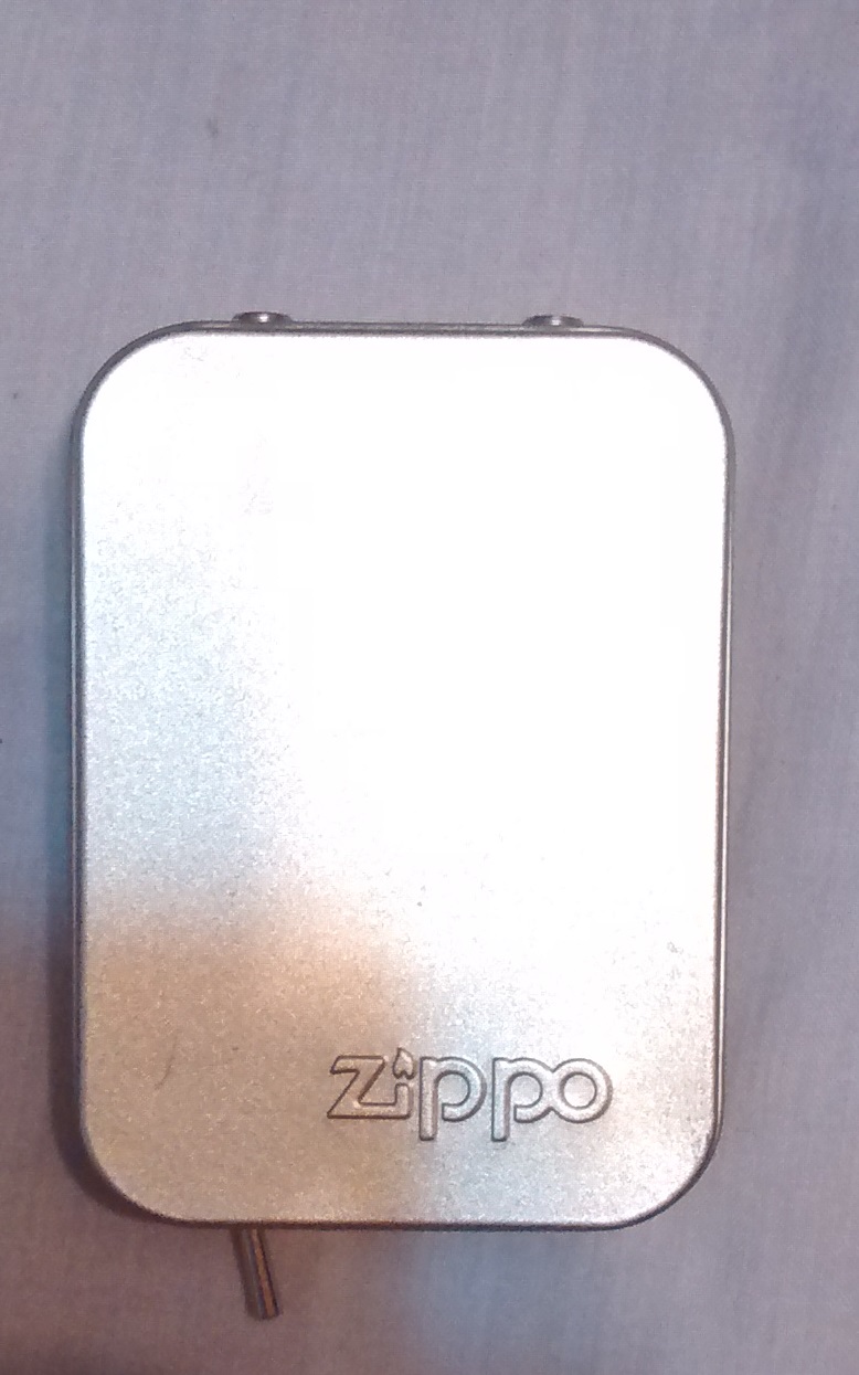

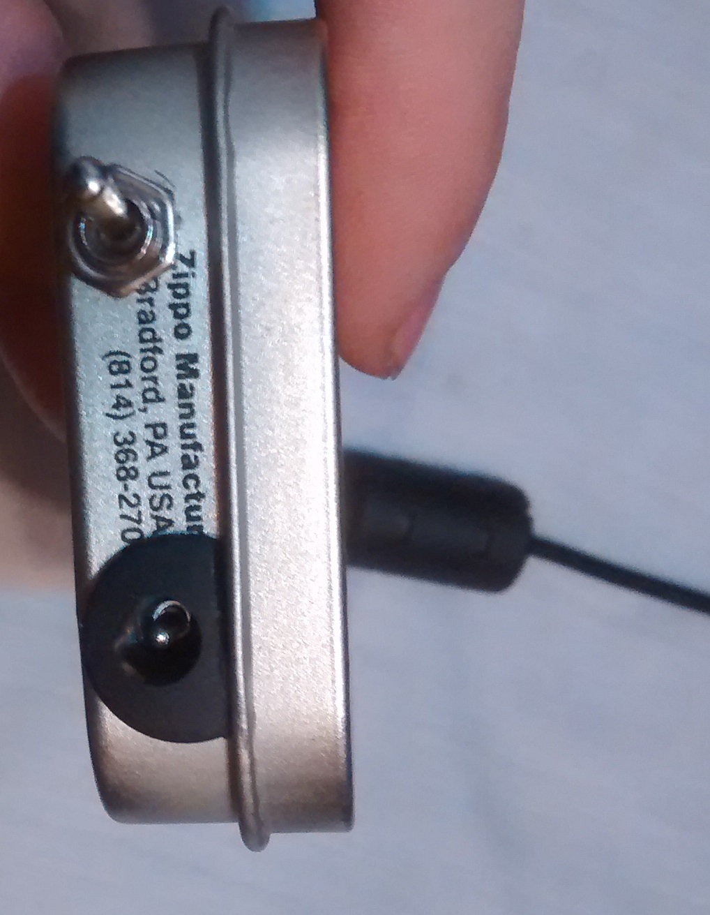

done with amp
good thing i dont smoke for years found a zippo case. made without switch first; used both stereo jacks switches in series then it felt dull decided it needs a switch to push with ur finger for more fun hehe.added a dc jack as well bypassing batt when inserted. turned out nice. whole case is grounded cables are very short twisted pairs will add a led later on when i got time.
thanks guys

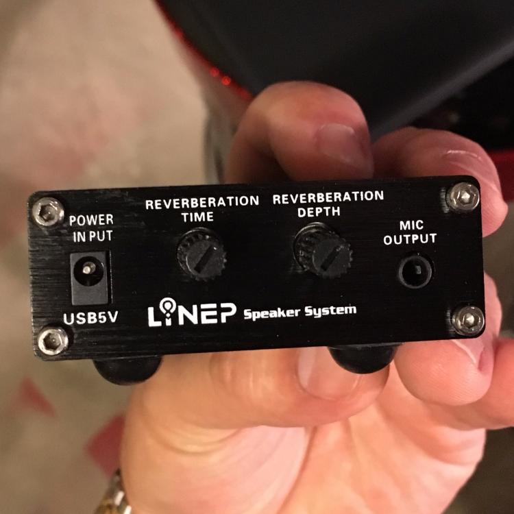

Here a few pics of the device:
The back of it shows the AC power plug which is 5V instead of the 9V used for the amp on the WOS site. This may have implications on performance as I'll point out later on... (Reverb apparently used to sing karaoke into the PC)
I have a laptop with a combo plug with mic and headphones together, so I also got the recommended adapter to separate mic and earphones. It's the white cable plugged into the computer. The USB is the power source of the amp.

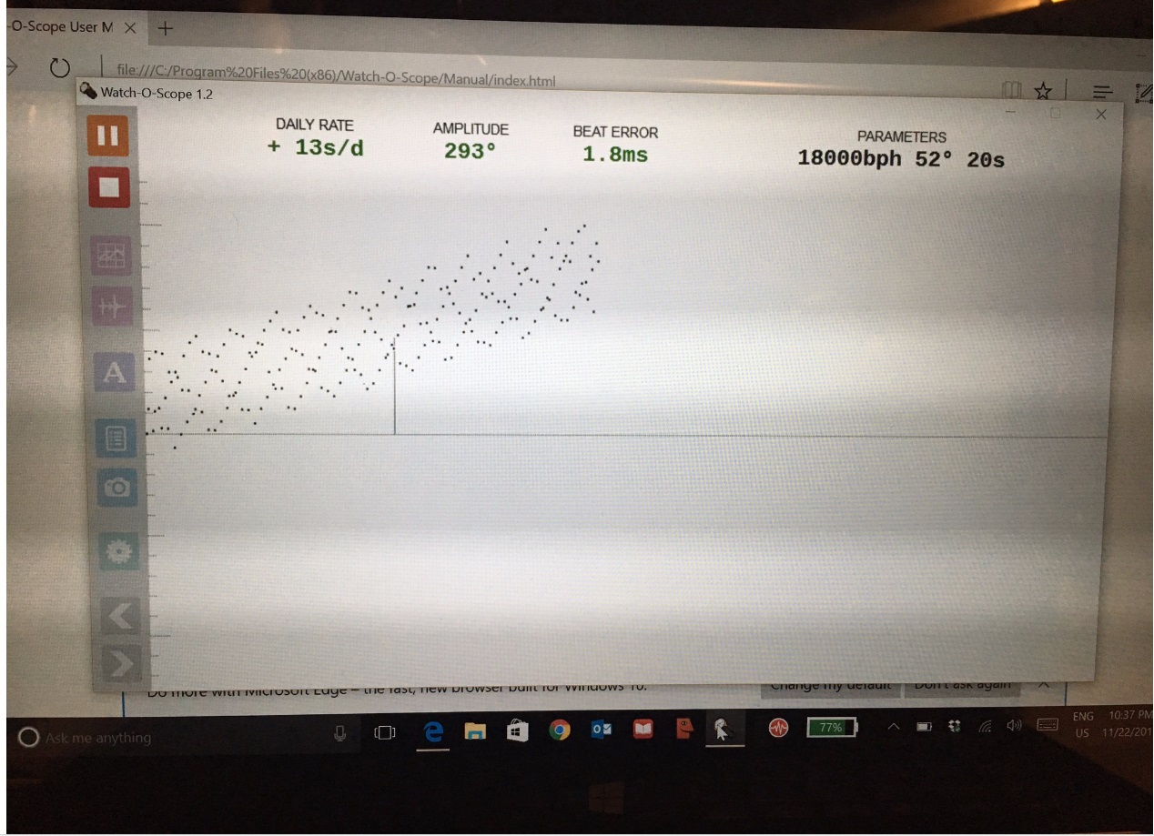

So, once all was connected I fired up WOS to set things up.
My first concern was the volume. Despite the amp being turned all the way to the max and having set up the pic on windows to 100% in addition to a 12db boost, the oscilloscope was weak.
That's the most I could get out of the system. I see the automatic threshold line there and my first question is of the quality of the reading is affected by such weak signal, or it's the same as long as WOS recognizes it....
 I went ahead and CALIBRATED my soundboard with a quartz watch and I had to add 1.0s as compensation.
So I analysed a relatively new ETA 6897:
I decided not to regulate it until I got some more input from more experienced users.
My main questions are regarding the level of amplification. I was expecting much more from the amp I got and instead it's tuned all the way up. I also chose a filter at WOS because the manual says it add a boost to the signal as well, although I didn't notice any difference before and after on the sound waves.
Should I look on for another amp?
Is the quality of the reading compromised by the low levels?
Are there any suggestions as to what to improve on?
I appreciate any input. I'm thrilled to be able to have the traces above without having to shell out a few grands for a Wischi.
Thanks again!
JG

Try mount the watch with the stem pointing to the microphone first.
There is also a software for frequency filtration. Basicly makes the soundcard to a preamp. Check Your soundcard settings! Increase input volume or switch boost function on if available.
Edited by szbalogh
I think that the problem you're seeing is that the automatic level determination can't distinguish the parts of the ticks, and probably adjusting manually won't help either, because the signal magnitude is not much more than the noise. What is the gain of that amplifier? It must be quite low.
